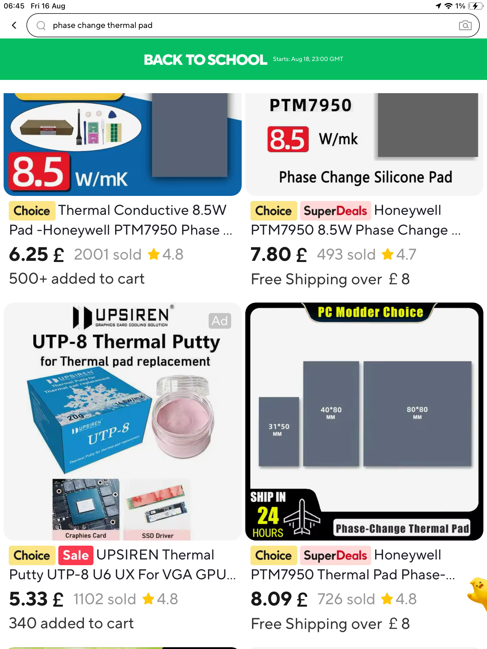

Sizlwik Posted August 16, 2024 Report Share Posted August 16, 2024 could be that ptm7950 that lenovo uses well not really 7950 i think they use a custom batch for their lenovo legion laptops so i wouldn't be surprised if thats what Microsoft used back then obviously not ptm 7950 since I doubt that was a thing back then but something similar Quote Link to comment Share on other sites More sharing options...
big F Posted August 16, 2024 Report Share Posted August 16, 2024 Aliexpress sell the pads, literally dozens of sellers. May get some whenI next have an OG that needs the heat sink removing. Quote Link to comment Share on other sites More sharing options...
