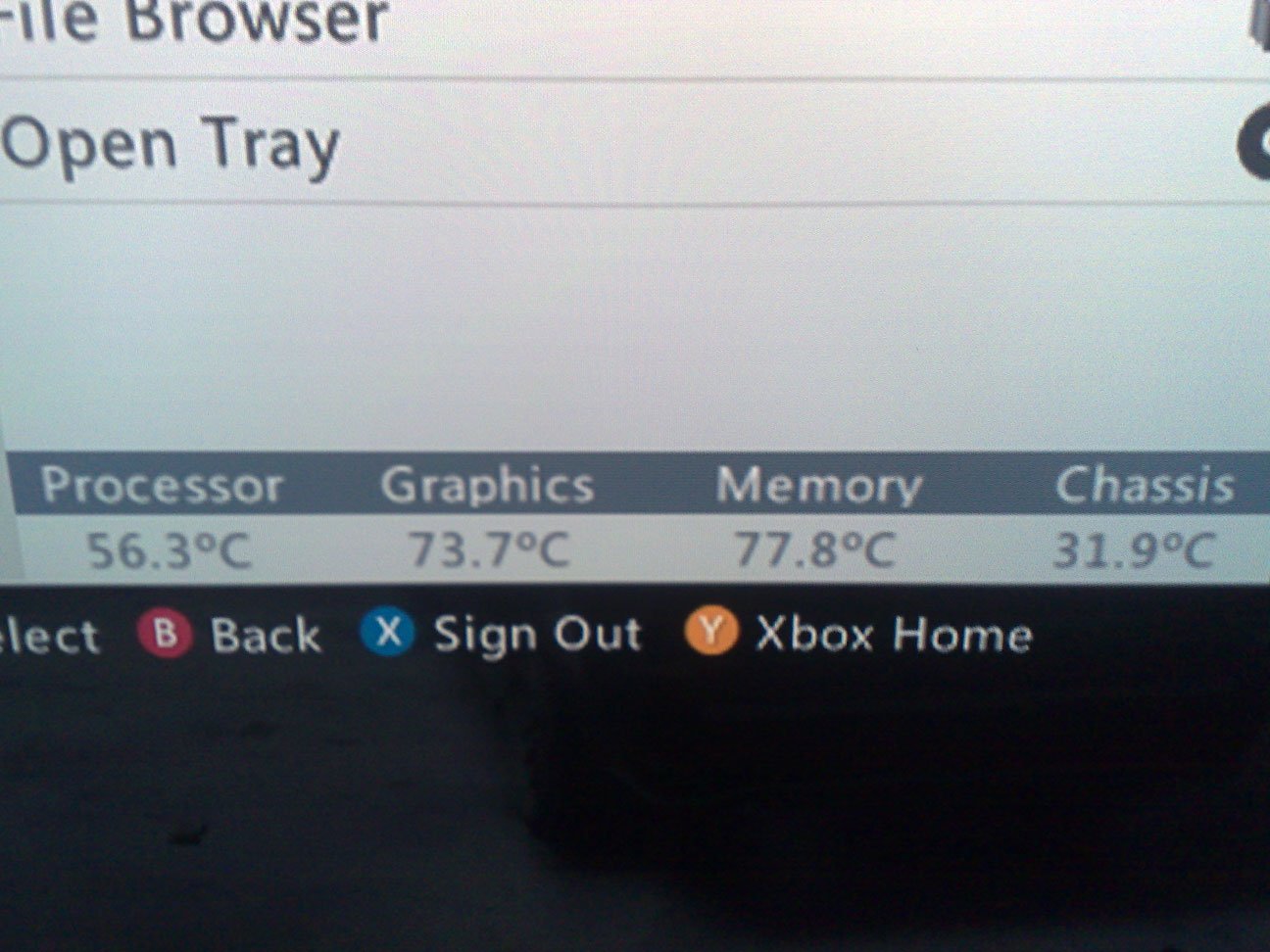

prtscn Posted April 3, 2020 Author Report Share Posted April 3, 2020 Xbox 360 falcon v2. Stock thermal compound. Highest temp. GPU goes around 73C-74C at max. Cop never goes above 58C Stock fan speed, quite sound. Quote Link to comment Share on other sites More sharing options...
