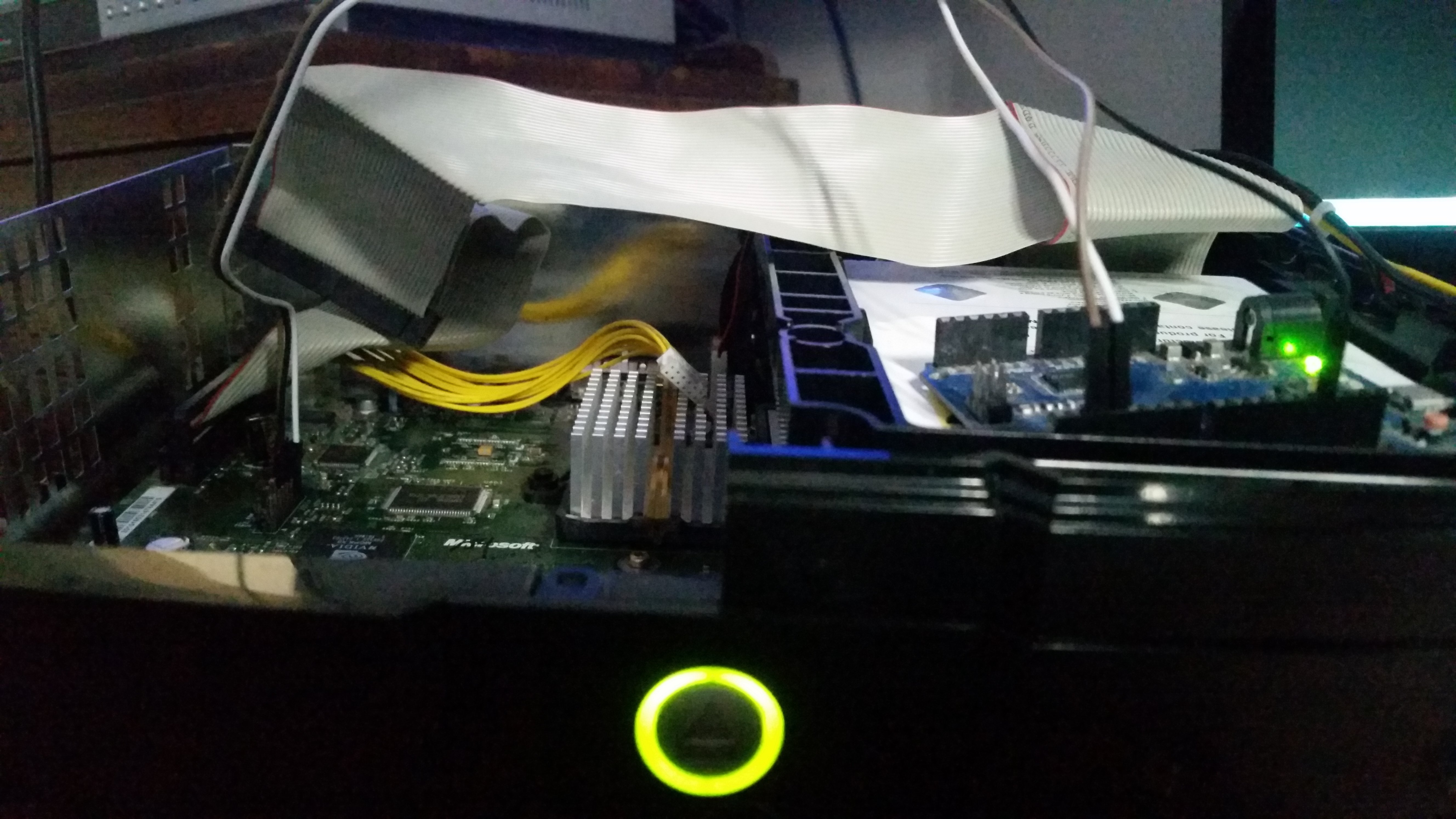

  12. It's a good place for this topic. I'm new to XBox modding, but found a page that explains the LED errors: https://www.xbox-hq.com/html/xbox-tutorials-163.html#xboxerrorcodes5 Also, I know it's unlikely since the cable works and you get the flubber, but the orange light can point to a fault in the AV cable. This is one of the EEPROMs I made, and it has slight differences in the last 64 bytes. I recovered those from a corrupt EEPROM backup I made (I wrote my own Arduino EEPROM backup software, which left out a nibble when it copied any zero bytes) https://drive.google.com/file/d/17W6QdWoxXxd6Ghtwt7zlzWIIGoZ7W_fK/view?usp=sharing
