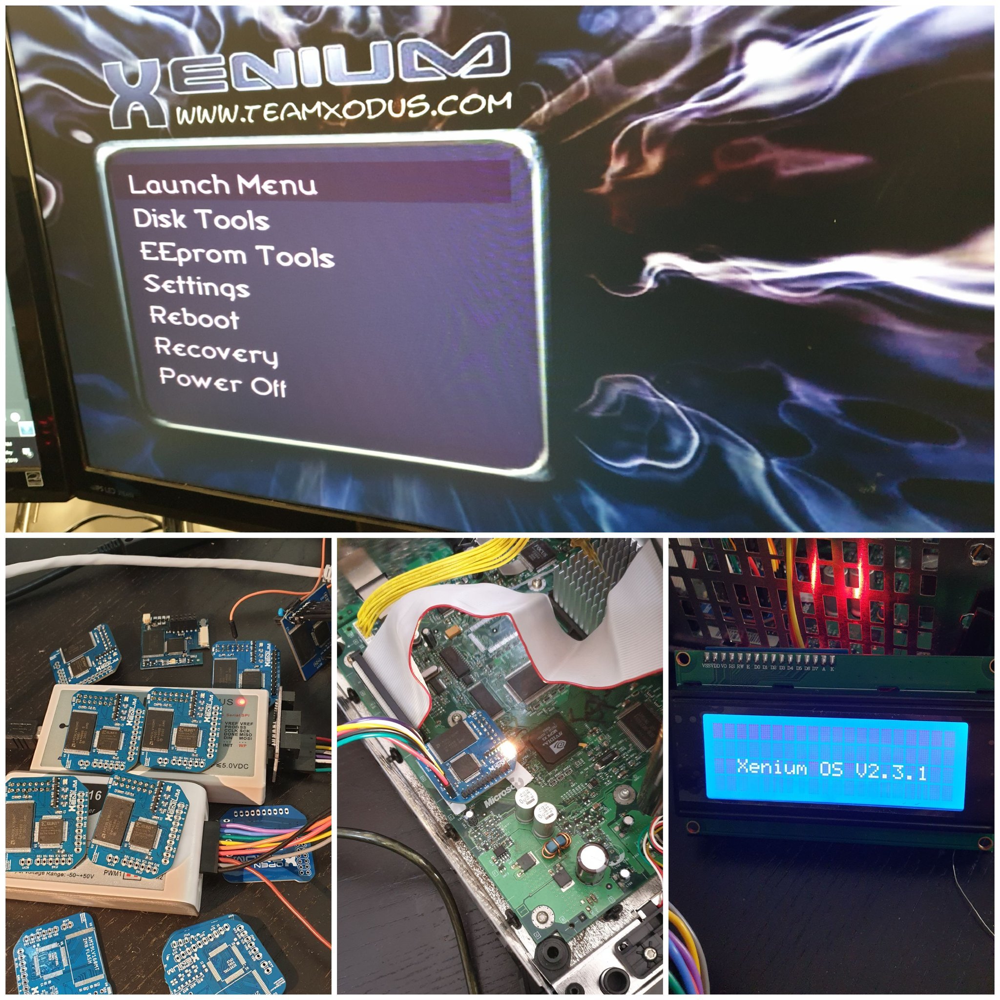

Hi all,
Over the past few months I have painstakely reverse engineered the Team Xodus Xenium modchip's CPLD and written a complete open source replacement.
I call it OpenXenium.
It has full support for XeniumOS and its features. Repo will list them.
The Xenium CPLD is normally read protected to prevent clones. This project did not attempt to break that protection, instead I determined the behavioral properties of the CPLD to write my own VHDL source code.
Check the repo out! there is a few xenium related tools that may even help people with a genuine Xenium!
Hopefully this will help with LPC related CPLD projects people may have in mind too.
Enjoy!
Ryan

Honestly i have never used a X3 but the modchip has alot of complexity in the hardware that i feel doeasnt add value.
Separate eeprom, separate flash chip, external buttons etc. I can understand why they are there but xenium doesnt need any of that and it works fine. It just makes development more expensive for me on top of actually having to buy one in the first place.

Just ordered a batch of boards to make.
Where specifically are you finding your flash chips?  I don't really see anyone currently selling the AM29LV160M, only the AM29LV160D based chips.
Edit:  I noticed your Digikey links specify the S29AL016J70TFI010 but wasn't sure if there really was much of a difference.
the S29 chips work just fine... exactly the same specs as the AM29 (even same Dev ID and Manufacturer ID), makes me think that Cypress bought the IP to the chip and rebranded it
As Kekule mentioned the S29 flash chip pretty much identical to the am29 chip. Unbelievably  close so its almost like they just changed the model number and up revved the datasheet.
That was a good find! They have a specific flash sector configuration that XeniumOS takes advantage of so not any old flash chip will work.
You can find am29lv160mt if you look hard enough but no benefit. In fact probably worse. (Aging chip)
