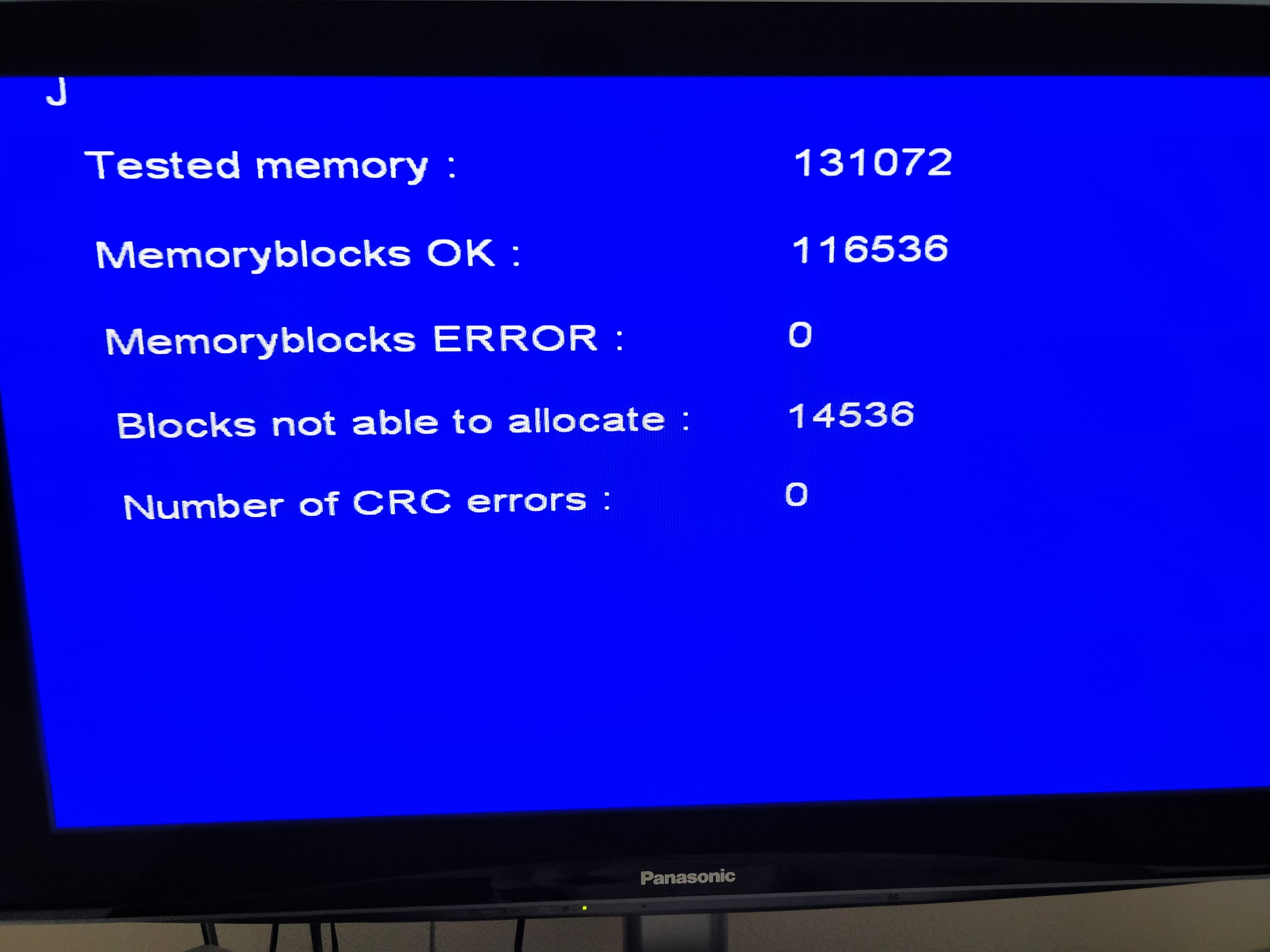

  4. Hello Dave, can we use this patched 5003.67 even if we don't have the MakeMhz HDMI ? I make some 128 Mb upgrade with small chineese wii2hdmi adapter after removing xbox video connector. I have also a hdmi pbc from Lukas (N64Freaks), top quality. bye
