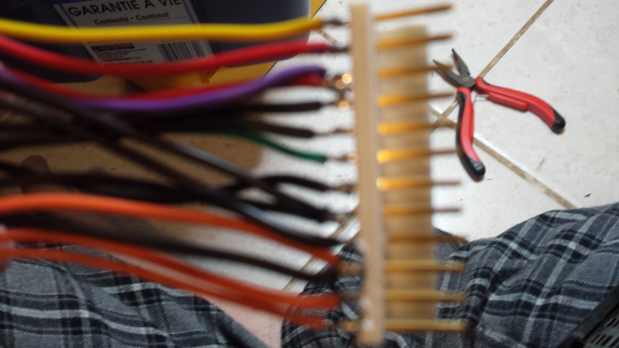

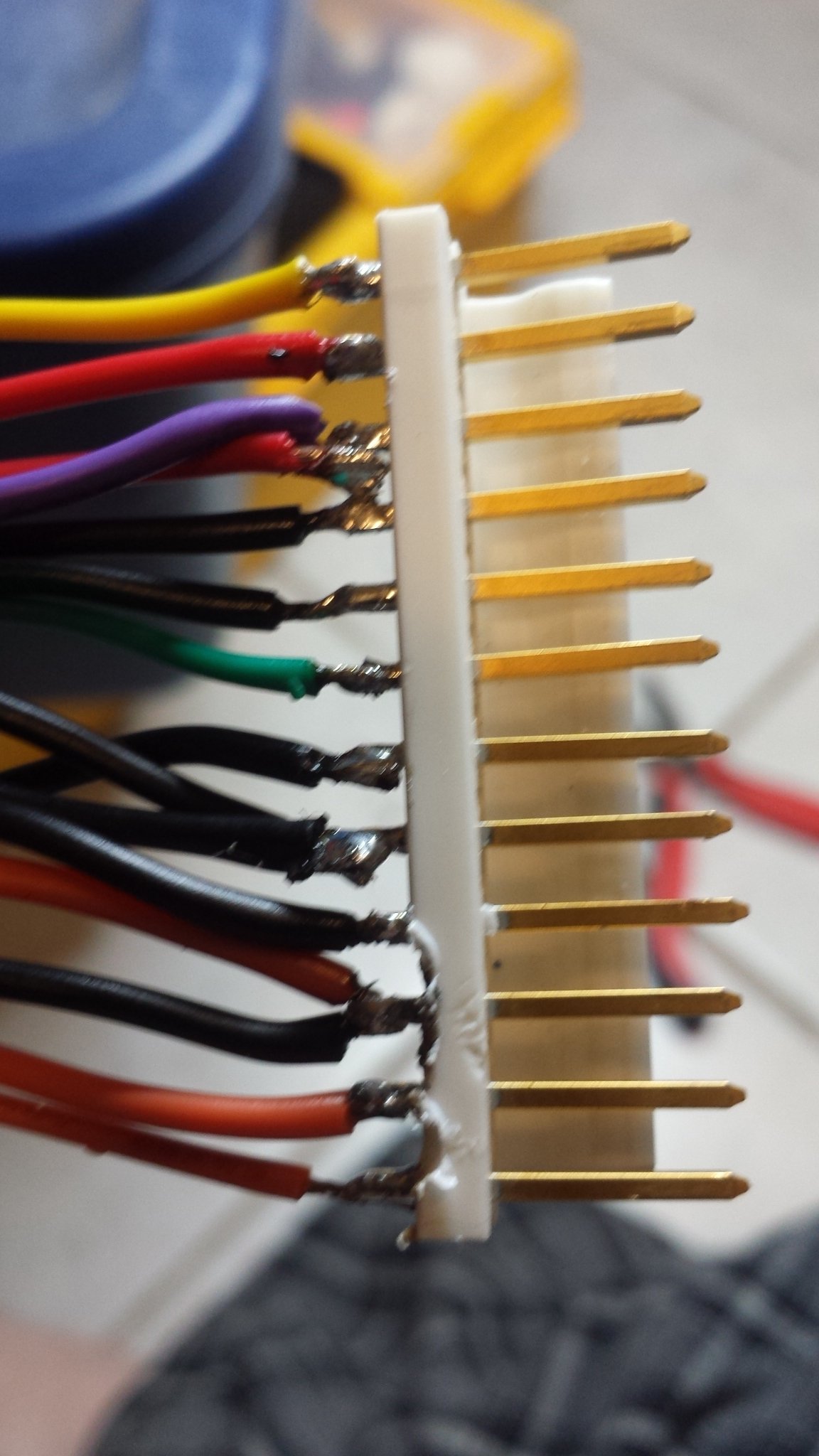

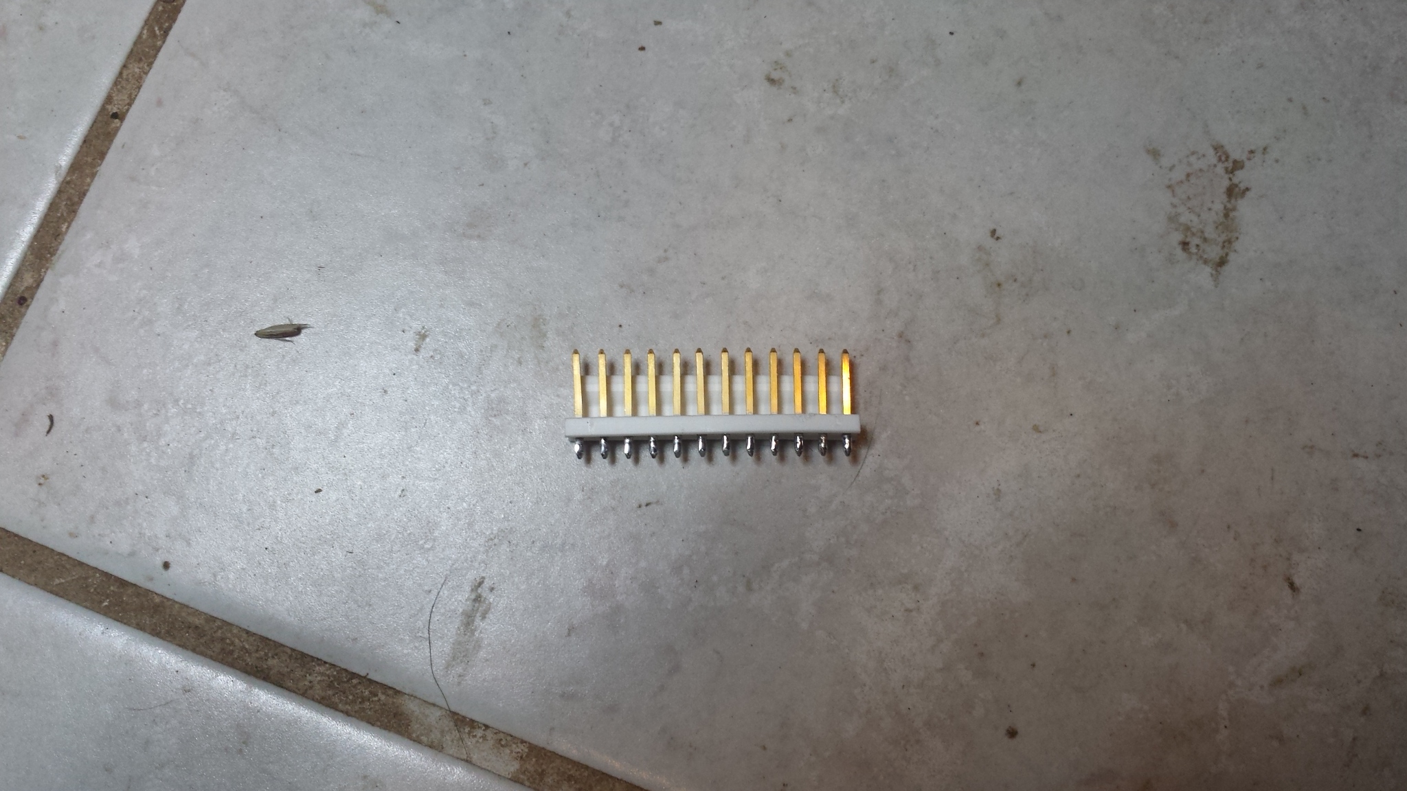

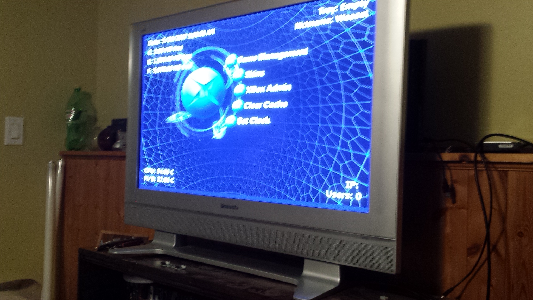

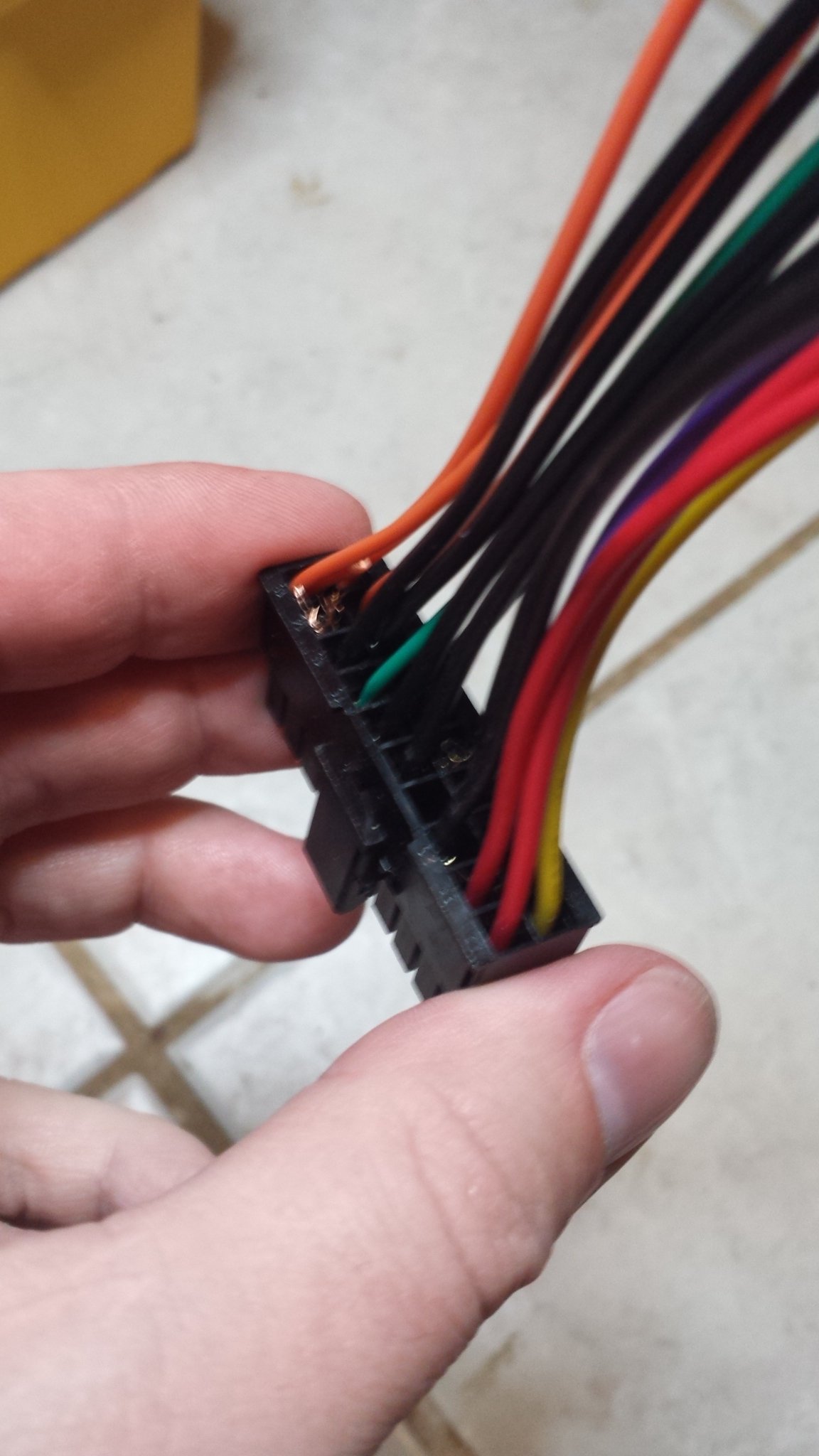

T2Steve Posted April 26, 2017 Report Share Posted April 26, 2017 Here is a run down of how to make a 1.0-1.1 to 1.2-1.5 adaptor. It's not terribly complicated. First, it's helpful if you have a donor board to take from. I placed my troubled 1.0 donor upside down and then blasted the power connector with a heat gun on high for about 4 minutes. eventually it gave out on its own and i picked up the mobo and gave it a slight tap to make sure it fell out on its own. The first picture is the power header from the motherboard. Next up is a 24 pin power header from a dead power supply. I removed the extra four pins (this was the type that slid the four pins off) and the 2nd picture is that header. The third picture is after I've removed the wires that are absent on the header, and added the wires that are absent that should be present. This was a bit of a pain, but a little wedging and a tiny bit of sliced fingers got it all together. Fourth pic, I stripped and tined the wires to make things go a bit easier. I made things harder on myself by not identifying what lines needed to be doubled up on. There are two grounds that need to be merged, two 3.3v (orange), and two 5v. Had I been paying a bit more attention (and I hope the readers who follow this do pay more attention) I would have not twisted and soldered each individual wire, but instead frayed out the wires, interlocked them and gave it a twist before adding solder. This would have given a better connection down the road. Fifth pic is the completed adaptor, along with pis six and seven showing my garbage solder job. I'm totally aware that two of the points are bridging but they are both ground so I honestly didnt care. Something that I absolutely should have done and did not do was get some heat shrink. It would have made this a much cleaner job in the end and when I do my clean up on it, I'll be desoldering the wires and placing some heat shrink on it to prevent accidental bridging. After confirming that it is all working nicely I'll probably hot glue it all just to give it a bit more strength. The eighth and ninth pic are images of the adaptor working and the xbox it was working on. Funny thing was that it turned on with no issues initially but with no hard drive it would give me grief about turning off. I grabbed the hard drive from my xbox that i did the TSOP split on sine it has both iND and X2 files on it, and plugged it in only to get an error 13. I thought that i must have screwed something up, maybe the iND files are looking for a DVD drive or something. Connect up the DVD drive and put in hexen and it is trying to load but isn't doing it. At this point I'm convinced that the 5v line just isn't good enough and that's why the hard drive isn't able to boot... and then i realized im an idiot. I put everything back into the split TSOP box, and then went into hexen and unlocked the goddamned drive. Plugged it all back in and turned it on and everything worked - no issues. So tidy up and to do list - get some heat shrink and re-do the solder connections with proper shrink, grab/find my fine point needle nose pliers to pull out a pin header that separated from the wire when i pulled the wire out, and hot glue the connections after confirming that they work. Do a proper smush test to see if i have to clip all of the stupid wires and shorten everything. I'd say there is 2-3 inch worth of wire and im thinking it might be a little on the long side of things. So there you go.. how to make a 1.0/1 to 1.2/5 PSU adaptor by T2Steve. Long live the Scene! 1 Quote Link to comment Share on other sites More sharing options...

T2Steve Posted April 26, 2017 Report Share Posted April 26, 2017 After giving this a bit more thought over night, I think what might end up being easier for anyone doing this in the future is to significantly shorten one of the 5v, 3.3v and ground lines, and solder them directly to the crimped pin that goes into the ATX side of things. That would reduce the number of lines in total and make for a smaller footprint overall. when i rebuild this I'm pretty sure that I will test this route out. Fewer lines means more room to maneuver.. I'm also thinking that it might be an idea in advance to just pull each of the pins out and re-organize them so that they are color coded correctly with red lines being 5v, yellow being 12v, 0range being 3.3v, and black being ground. the purple, blue, and green would correspond with white/blue/grey or purple/green/gray. That would make it a bit easier to follow. Quote Link to comment Share on other sites More sharing options...
