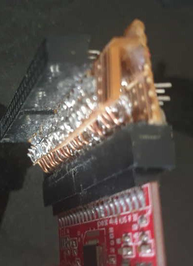

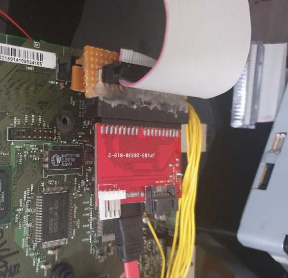

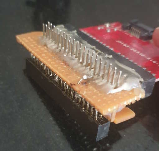

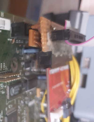

The main issue was the reverse IDE connector, I saw others plug theirs straight into the mobo and this means no DVD. So i made a prototype to test a thought - my prototype pretends to be 100/133mbps IDE cable, with reverse connector for the SATA/IDE adapter and serves the DVD reusing the XBOX IDE cable (chop in half). It fits under the DVD and no need to source an 80 wire cable.
woah, so there is a way to make it work. glad to know I wasn't so wrong afterall, even though that seems lot of work requiring extra hardware skills I don't have... so I think I'll just use my Xbox as retrogaming console (nes, snes, gba, genesis, etc.. no n64 and psx because they're laggy or they don't even work at all) untill I can sell it (too much money spent on it already, gotta take it back)... unless prices of drives and adapters get a real decrease, honestly I can't spend 30€ on an adapter that I don't if it will work or not on a console that I don't know how long will last (not talking about IDE drives too, whose prices got increased thanks to the "vintage" factor). too bad I can't play some exclusives and pc emulation is still very unstable. I'll just try to get on with it or wait for some genius to come up with a ftp/ethernet loader that loads game off another computer... which is definitely unprobable even if already seen (I recall some dude playing PS2 isos through net cable). :/
