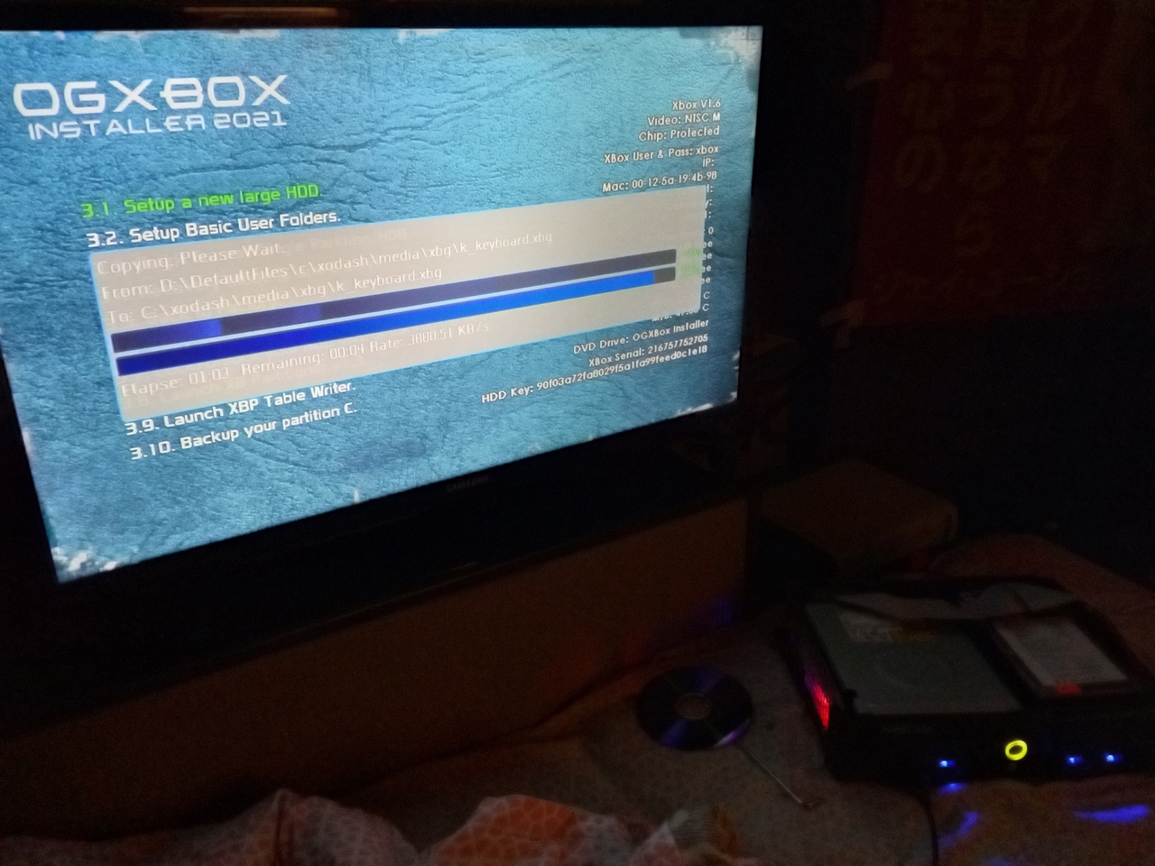

eightbit Posted December 3, 2020 Report Share Posted December 3, 2020 (edited) I tested this today. It absolutely works great and is much more advanced than Hexen ever was. But there was one issue I ran into. It claimed my chip was "protected". I was certain I did the TSOP mod correctly, but it refused to flash the chip. It is a Winbond chip. I actually had to use Hexen 2018 to TSOP flash it to EvoX...which worked there. Then I used this disc to clean up the drive and perform the installation of all of the software. In OGXBOX installer it previously it read the BIOS as Stock 5101 (before I had to use Hexen 2018 to flash the chip). Now it reads it as "unknown" in OGXBOX Installer. Although when I power on the Xbox, it certainly shows the EvoX logo and Hexen 2018 flashed it without any issue. And I was able to stick a 500GB drive in it and use it no problem. So it is hard modded. Just wondering why OGXBOX Installer is not detecting it or allowing it to be flashed? Is it a raincoat issue? After choosing the Winbond BIOS to flash (I chose EvoX) it just backs out back to the BIOS select screen without flashing anything. For now (for me) this is an all around great tools disc to get hard drives configured (and I like the fact that you have a bring everything back to factory option!) but I really wish it could be used to flash TSOP BIOS's as well (again, for me...I am sure it is working for others) Any thoughts on why this is happening are greatly appreciated. Edited December 3, 2020 by eightbit 2 Quote Link to comment Share on other sites More sharing options...
sweetdarkdestiny Posted December 3, 2020 Author Report Share Posted December 3, 2020 (edited) 2 hours ago, eightbit said: I tested this today. It absolutely works great and is much more advanced than Hexen ever was. But there was one issue I ran into. It claimed my chip was "protected". I was certain I did the TSOP mod correctly, but it refused to flash the chip. It is a Winbond chip. I actually had to use Hexen 2018 to TSOP flash it to EvoX...which worked there. Then I used this disc to clean up the drive and perform the installation of all of the software. In OGXBOX installer it previously it read the BIOS as Stock 5101 (before I had to use Hexen 2018 to flash the chip). Now it reads it as "unknown" in OGXBOX Installer. Although when I power on the Xbox, it certainly shows the EvoX logo and Hexen 2018 flashed it without any issue. And I was able to stick a 500GB drive in it and use it no problem. So it is hard modded. Just wondering why OGXBOX Installer is not detecting it or allowing it to be flashed? Is it a raincoat issue? After choosing the Winbond BIOS to flash (I chose EvoX) it just backs out back to the BIOS select screen without flashing anything. For now (for me) this is an all around great tools disc to get hard drives configured (and I like the fact that you have a bring everything back to factory option!) but I really wish it could be used to flash TSOP BIOS's as well (again, for me...I am sure it is working for others) Any thoughts on why this is happening are greatly appreciated. If your Chip shows up as "protectet" in the installer it's because of UnleashX (Quote from the UX manual : "ChipID" - The type of chip being used, i.e. SST 49LF020. if unknown, it defaults to "Protected BIOS"). I have the same on some of my TSOP'ed XBoxes not a big deal. Basicly UX didn't now that bios and thats why it shows "up Protected" About the flash, you have used the option " 2.2.1. Flash Winbond TSOP. "? I will do check that today to see were I have messed that up ( I have one Winbond XBox here to test that so i think we get that fixed asap). Thanks for reporting this bug at all. About HeXEn... I used HeXEn as well but I missed options and some other things. I have tried to talk to Heimdall to make HeXEn better but sadly he simply refuses to talk to me so thats why this disc exists at all. And I have to admit that HeXEn isn't that bad at all. You could say the same about this disc. Bugs will happen and when ppl report them, they will be fixed. Problem is here, most ppl prefere to flame in other boards about bugs instead of reporting them to get fixed. I guess all of us Heimdall, Slayer and all the guys who made installer have to deal with that. You see, we are on version 1.0.3 and I work on 1.0.4. (My private build is 1.10.0) So I do a lot of work without a release for just a minor bug fix. And OFC it isn't great to do much releases in a sort time but if it's needed, it should be done. It sucks but whats the price for a DVD 20 cent`s? Not to bad I think (And i already have burned ~50 DVDs just for test builds). And each time there was something i don't like or just a stupid typo happend (Like most of oyu know, english isn't my fist language but at least I try to give my best). So if the users work with me (and with all others who made disc like this) instead of working against me (us), we can do something nice. That said, I will see that I get that bug fixed today so that it will be fixed in the next build (1.0.4). For all non Winbond users the 1.0.3 should be ok for now (ST and all other (no Sharp) TSOP's can be flashed with the EvoX). And again thanks for reporting and the flowers as well. EDIT : Stupid question... You have choosen your bios (EvoX prepares the bios and copied it) and after that you go are gone back to the EvoX main menu (which would be right) and hit " Flash Bios NOW! " ? EDIT 2 : Found the mistake I made. And it's fixed. Edited December 3, 2020 by sweetdarkdestiny 1 Quote Link to comment Share on other sites More sharing options...
