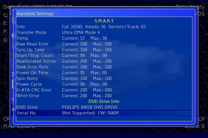

hi all new here and new to thee xbox modding, i have a tosp modded og xbox i wont to check the heath of my drive as ive noiced sum saves are not loading i have a 500GB segate sata drive in it i wont to make sure the drive is ok and it's not just a curuped file ?
take the drive out and connect it to your pc. DON'T FORMAT IT! run a free tool called crystal disk INFO(no crystal disk MARK) https://crystalmark.info/en/software/crystaldiskinfo/ and it will tell u the health of the drive and also tell u how many hours it has on it and all the start/stop cycles it has been thru. this tool will even work on a locked drive. there is also another tool called hard drive sentinel that u can use to get a slightly more detail diagnosis. u can try to clone the drive with chimp(look up youtube vids on how to do this) if it is failing.
cool thanks i tryed that tolled me heath ok when i use a app to check bad sectors it comes back as all dead lol
I usually use UnleashX to see basic SMART info about a drive. I'll also look to see how many times it has been powered on in its life to get an idea of how old it is. If you're using a stock hard drive, just remember that some of them are coming up on 20 years old and hard drives don't live forever. If the drive works, then great. But backup important data you wouldn't want to lose to a PC.
where do i go too see that info? i have the UnleashX  dash as my main dash
