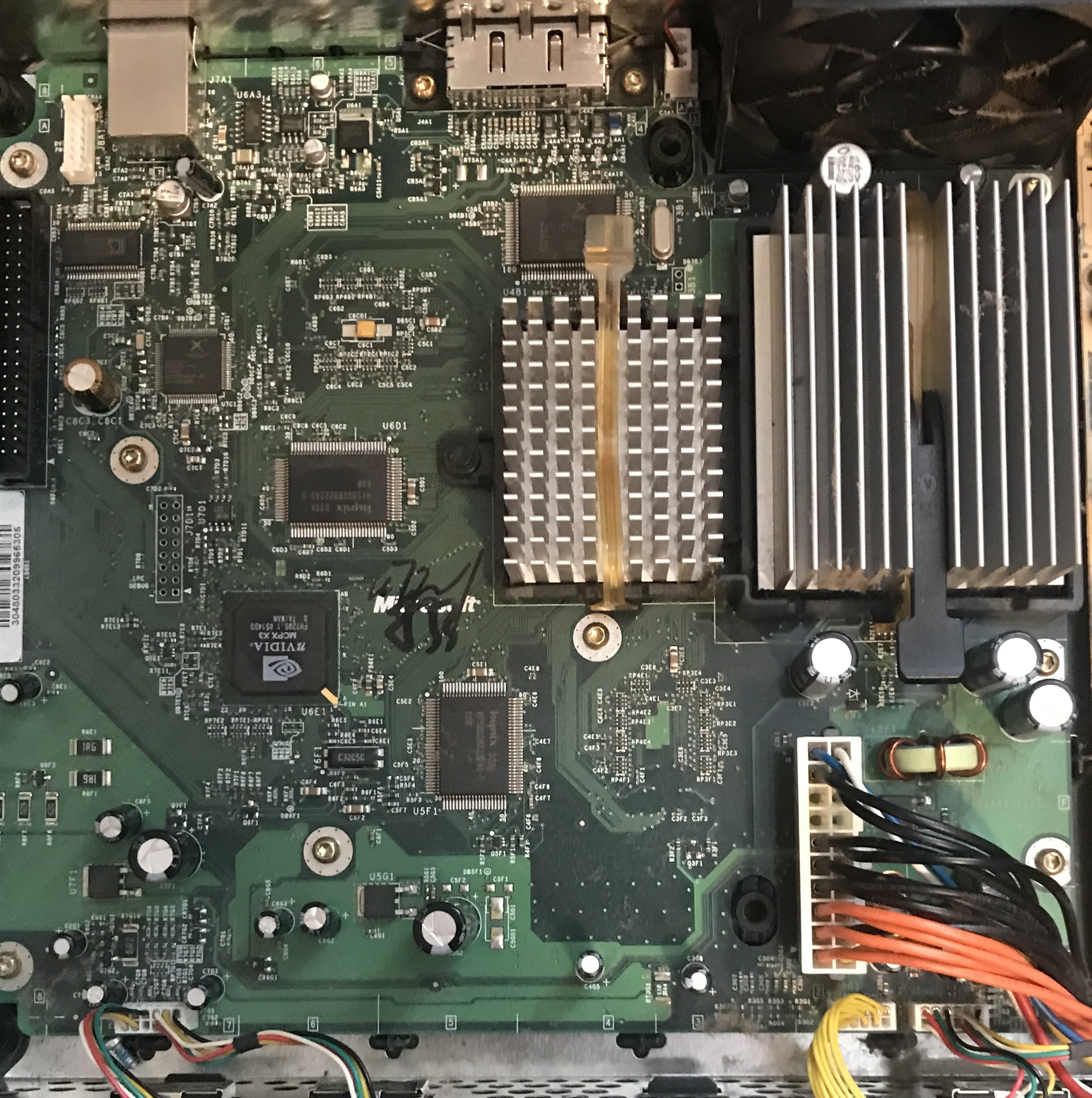

cpg Posted February 1 Report Share Posted February 1 I got a xbox og with no hard drive can I fix it? Quote Link to comment Share on other sites More sharing options...

MadMartigan Posted February 1 Report Share Posted February 1 29 minutes ago, cpg said: is not hardmoddet Can you post a detailed picture of your mother board? We need to identify which version you have in order to determine if you can flash the TSOP or need to install a chip. Both options require a bit of soldering tiny points. Just a heads up. Quote Link to comment Share on other sites More sharing options...
sweetdarkdestiny Posted February 1 Report Share Posted February 1 57 minutes ago, MadMartigan said: Can you post a detailed picture of your mother board? We need to identify which version you have in order to determine if you can flash the TSOP or need to install a chip. Both options require a bit of soldering tiny points. Just a heads up. He cant flash the TSOP without a HDD. (Or he could in case he is able do de solder the TSOP, flash it with an external flasher and solder it back). One solution would be to read the eeprom with a raspbarry pi (piprom) and create a hdd using FatXplorer 3.0. The other option ofc would be a modchip. In case the OP has a RaspbarryPi, I would try that first. PS. There would be also the option to build a serial eeprom reader from some basic parts in case there is no RaspbarryPi on hand. 1 Quote Link to comment Share on other sites More sharing options...

cpg Posted February 1 Author Report Share Posted February 1 Quote Link to comment Share on other sites More sharing options...
MadMartigan Posted February 1 Report Share Posted February 1 So you have a 1.6 revision. As sweetdarkdestiny has mentioned, you can either grab the eeprom with an eeprom reader or install a cheap mod chip. Both options can recover your system and possibly the hdd. A chip will allow you to install pretty much any hdd without the need to be locked. Quote Link to comment Share on other sites More sharing options...
Megoosa Posted February 2 Report Share Posted February 2 I think the cheapest method will be the modchip if you just want to fix this one Xbox (and the only method if you want something other then the standard BIOS because it's a 1.6), but if you want to repair/mod more units a Raspberry Pi to read the EEPROM will be cheaper in the long run. Quote Link to comment Share on other sites More sharing options...
si_kabayan Posted February 2 Report Share Posted February 2 If you're technical enough, this probably the cheapest way to fetch the EEPROM: https://mehmedbasic.dk/post/xbox-eeprom/ 1 1 Quote Link to comment Share on other sites More sharing options...
KaosEngineer Posted February 2 Report Share Posted February 2 19 hours ago, cpg said: I got a xbox og with no hard drive can I fix it? You can also use an Arduino to read the configuration EEPROM's data. There are several Xbox EEPROM reader/writer sketches available on github.com for this operation: https://github.com/ExtraordinaryBen/DuinoBoX https://github.com/Ryzee119/ArduinoProm There are others as well. An ESP32 and ESP8266 can be used too: https://github.com/dx4m/Xbox-EEPROM-Utility Quote Link to comment Share on other sites More sharing options...
