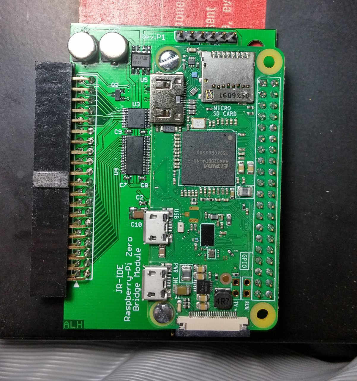

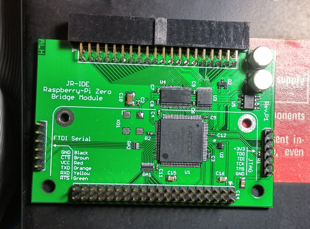

neakmenter Posted January 30, 2021 Report Share Posted January 30, 2021 A repost of the same info from my ODE thread... I'd like to keep this one as the main for ODE interests if possible, GoTeamScotch definitely has seniority in XBox land and I'd like to maybe start collating peoples trials and experiences on this thread instead. I got the right cables through to try my Zalman ZM-VE200 external ODE drive as a possible solution. It's a no go of course! The drive is ONLY an external HDD when in "eSATA" mode. Even though the manual doesn't mention this limitation. It's a lovely ISO ODE for windows installs etc, but it only enumerates as an optical drive over USB. The little window, as soon as you plug the eSATA cable in, says "eSATA Mode" and it just gives you access to the hard drive, with no ODE. A waste of money - but it was kinda worth a go! Maybe also thinking about just replacing the HDD with an SD Card, and having a nice access panel somewhere for swapping SDCards with complete images on them. It is only a solution for us with hardmod bios though, I don't know if you can lock an SD-IDE?. I am really coveting the idea of one SDCard per game, in the discboxes, with the manuals. Part of the experience is going to the shelf and choosing the game, loading the media etc... (I know it's stupid, it's all right there on the HDD... But...) Quote Link to comment Share on other sites More sharing options...

neakmenter Posted February 4, 2021 Report Share Posted February 4, 2021 On 2/2/2021 at 3:09 AM, GoTeamScotch said: Thanks for the update! After looking up that Zalman of yours, I think I might actually pick one up. It looks like a great way to handle operating system ISOs. I usually have a couple of flash drives that I format and flash as needed, but that looks like a better solution. But yeah, that's too bad that it won't work for this purpose in an Xbox. Once I get some spare cash, I plan on buying a couple options to see if any are compatible. I imagine SD card adapters exist. I have a CF adapter that I use in Xboxes when I use as a bench hard drive for testing motherboards and junk. I admire your dream, but that's a whole lot of work to get to essentially basically the same outcome as using discs. Maybe someday someone can clone the XDK's drive emulator... PC card (installs into a PC and requires special software included in the Xbox dev kit suite) -> Xbox card (sits in between IDE cable and DVD drive) -> Ports open at the back for hooking up cables -> Love it - those cards definitely looks like late 90's tech! 1 Quote Link to comment Share on other sites More sharing options...
