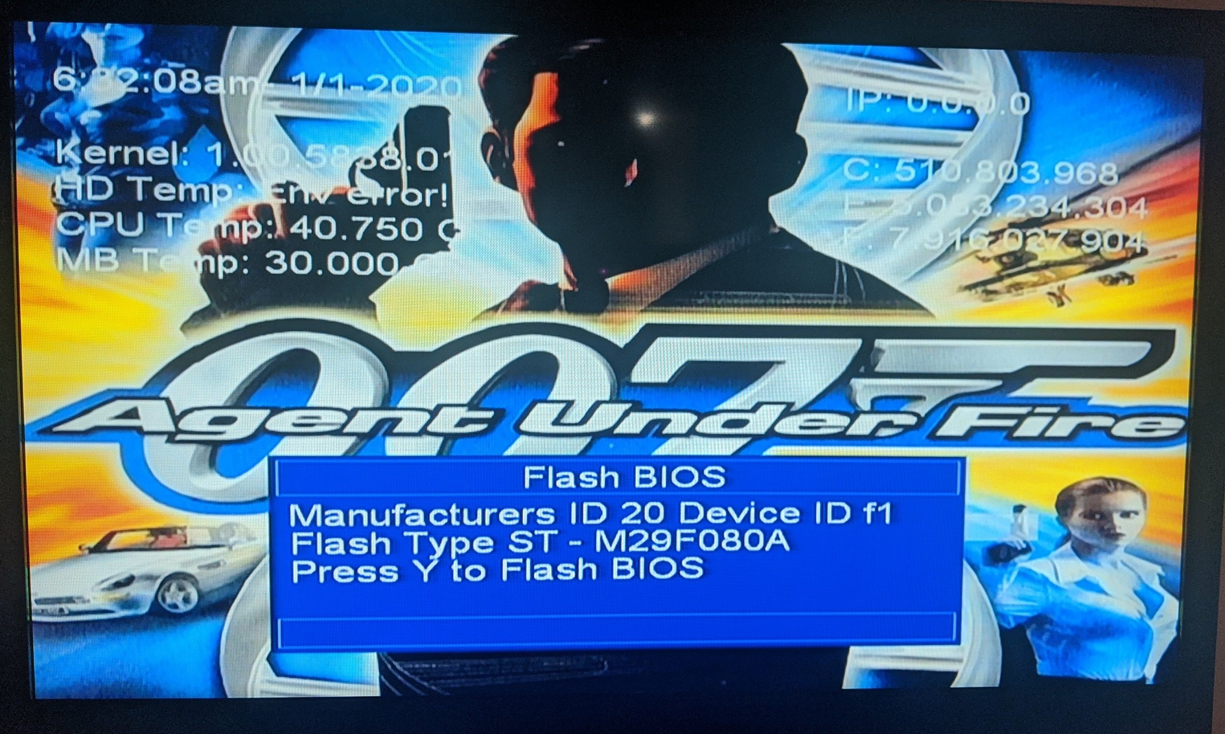

TSOP flashing is the rewriting the bios file that's stored on the main board to enable the Xbox to read unsigned (Copied Disks, Homebrew Disk's) and allowing the Hard drive to be used in the Unlocked state and also allowing the hard drive to be larger than 137gb. It also makes upgrading the hard drive a simple procedure.  1 flash new bios, 2 fit new hard drive, 3 load a install disk and follow the on screen prompts, 4 FTP apps,games to your hard drive and start enjoying it.
TSOP flashing will work the same as fitting a modchip as a chip is just overwriting the on board TSOP chip, 2 ways to flash a TSOP 1 is softmod the Xbox to allow you to run Homebrew software or my prefered method is to flash from the game save hack without having to softmod 1st.
The 1st reflash ones I did was using 007 Agent Under Fire game save  exploit using commands sent via a PC to the Xbox with a network cable, I still use 007 AUF but the exploit has now got the ability to flash the TSOP without the need of a PC
