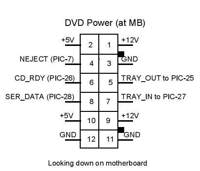

KaosEngineer Posted April 4, 2019 Report Share Posted April 4, 2019 I've never done this mod; however, I understand the basics. You need to have a BIOS flashed to the TSOP/modchip that disables the DVD check on power on. And, I think you also need to make a properly configured connector to plug into the DVD power connector on the motherboard. This is the image of the connector pinout I've seen but it only has 12 pins not the 14 present on the motherboard. The next two 13 and 14 have no connections to the DVD drive though so I guess the original author just left them off. TRAY_IN and CD_RDY need to be tied to Updated: hmm, either Ground (GND) or +5V to signal to the System Management Controller (PIC processor v1.0-1.5 consoles) that the tray is closed and the drive is ready. I don't know if TRAY_IN and CD_RDY are active low or active high signals. I'll have to see what I can find again. I've seen a slim build log on the Internet of someone that removed their DVD drive and showed the jumper plug they had made. Update: Looks like they are active HIGH so they need to be tied to +5Vdc. Although I'd probably use a pull-up resistor of 10KOhm for each from 5Vdc to the signal pin. (2 resistors one for each signal to +5Vdc). +5Vdc(pin 2) -\/\/\- CD_RDY(pin 6) and +5Vdc(pin 10) -\/\/\- TRAY_IN(pin 7) -\/\/\- is my ASCII representation for a resistor. Use a 10KOhm 1/4watt. Probably could be a much wattage rated resistor (1/8 watt). 1 Quote Link to comment Share on other sites More sharing options...

KaosEngineer Posted April 4, 2019 Report Share Posted April 4, 2019 1 hour ago, Xbox4rl said: So sounds like I could add the power switch then... I'd probably do that on pins 2, 10, 1, and 9... Take that back I'd probably just put the switch on the ground... Thoughts What's about pins 2, 10, 1 and 9? Those pins supply power to the DVD drive. Update: Oh, I see. I missed your post on powering on/off the DVD drive with a switch. You need to make this so called DVD Simulator jumper to plug into the motherboar's DVD power connector to pull HIGH the CD_RDY and TRAY_IN signals routed to the SMC so it knows the drive is ready. Here's one such plug I found at xbmc4xbox.org.uk - https://www.xbmc4xbox.org.uk/forum/viewtopic.php?f=13&t=373#p13212 However, instead of a wire to directly connect from 5V to B and 5V to D, I would use a 10KOhm resistor. Quote Link to comment Share on other sites More sharing options...

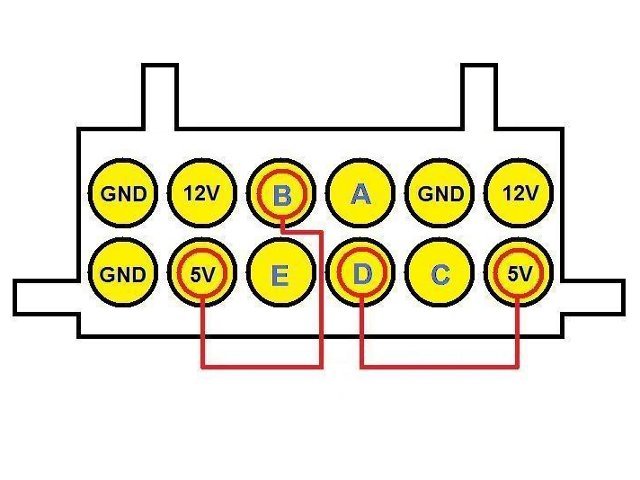

big F Posted April 5, 2019 Report Share Posted April 5, 2019 7 hours ago, KaosEngineer said: You need to make this so called DVD Simulator jumper to plug into the motherboar's DVD power connector to pull HIGH the CD_RDY and TRAY_IN signals routed to the SMC so it knows the drive is ready. Here's one such plug I found at xbmc4xbox.org.uk - https://www.xbmc4xbox.org.uk/forum/viewtopic.php?f=13&t=373#p13212 However, instead of a wire to directly connect from 5V to B and 5V to D, I would use a 10KOhm resistor. Thats the ticket, agreed giving it a load rather than a direct short was the one bit I remembered. Quote Link to comment Share on other sites More sharing options...
