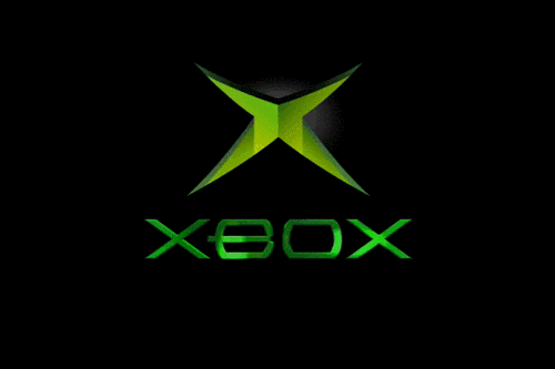

There are tools to edit the bios and inject a .x file in place of the text for the x2 bios, I don't know about the x3 bios though. The .x files were created in 3dsmax.
I used to mess with x2 bios's but only changing the xbox text, been a while since I've done it though. All in bios, x2 4981 so no config files
