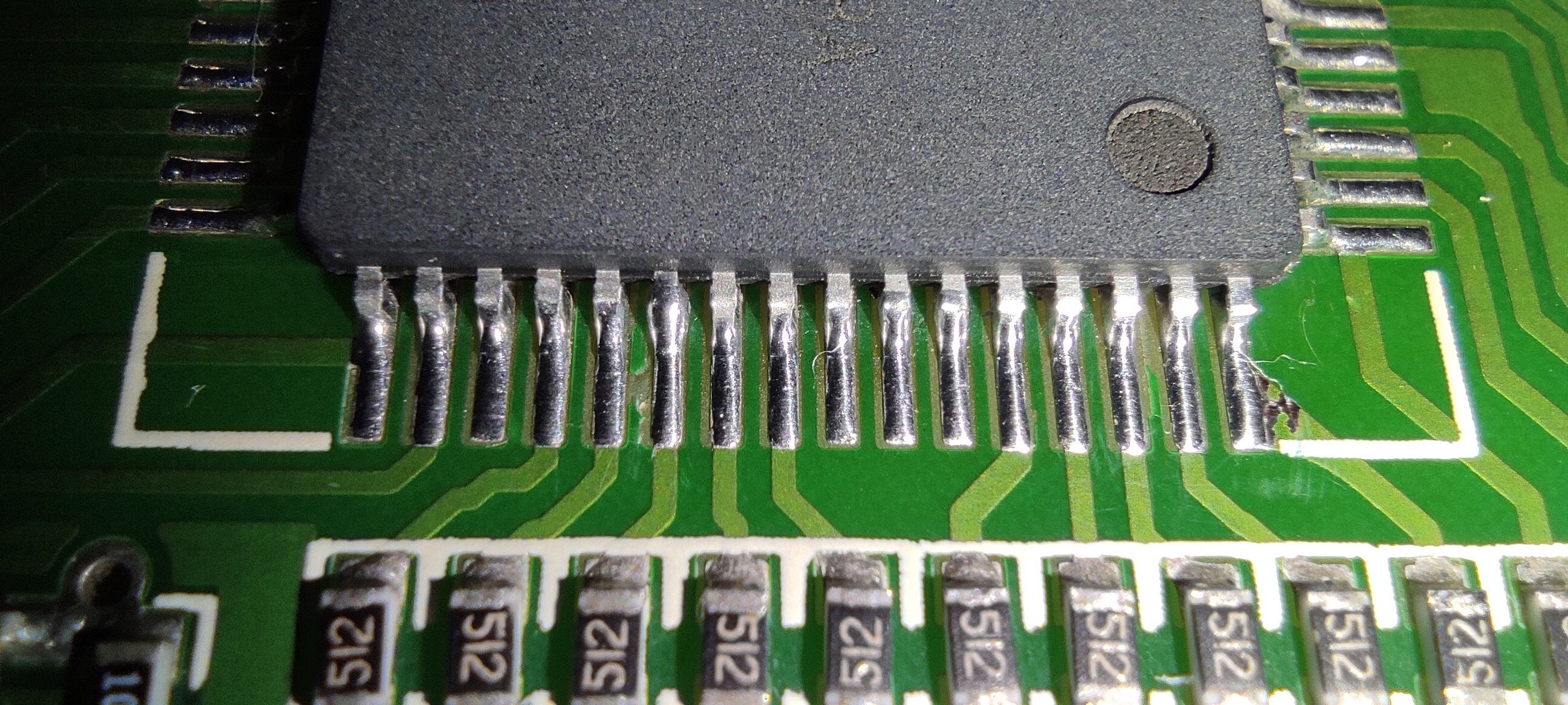

amxcs Posted January 27, 2024 Author Report Share Posted January 27, 2024 It might be It just didn't seem normal to me that the letters 3 out of 4 chips were in a different font and very poor quality, only one of them was 1:1 like the one on the console. I ordered them from here. I forgot to take pictures of the solder joints, and I can't take the console apart now just because of that. But here is a picture of another chip that I soldered today. My solder joints always look like this... Quote Link to comment Share on other sites More sharing options...
Bowlsnapper Posted January 28, 2024 Report Share Posted January 28, 2024 26 minutes ago, amxcs said: It might be It just didn't seem normal to me that the letters 3 out of 4 chips were in a different font and very poor quality, only one of them was 1:1 like the one on the console. I ordered them from here. I forgot to take pictures of the solder joints, and I can't take the console apart now just because of that. But here is a picture of another chip that I soldered today. My solder joints always look like this... This is the link I sourced them from: https://www.aliexpress.com/item/3256801935456368.html?spm=a2g0o.order_list.order_list_main.32.f5961802ulYguz Some of the lettering was different, but all the chips work. However they were all consistent in their general appearance, which was slightly different and newer looking than the originals. That soldering looks pretty clean to me. Of course, unless we can verify the actual job itself, our input is going to be speculation. Quote Link to comment Share on other sites More sharing options...
lopenator Posted January 28, 2024 Report Share Posted January 28, 2024 (edited) I've never had bad chips but that doesn't mean they don't exist. If your solder work looks like that on the chips in question than it's no doubt the chips. Also make sure they are orientated the correct way. Good luck Edited January 28, 2024 by lopenator Quote Link to comment Share on other sites More sharing options...

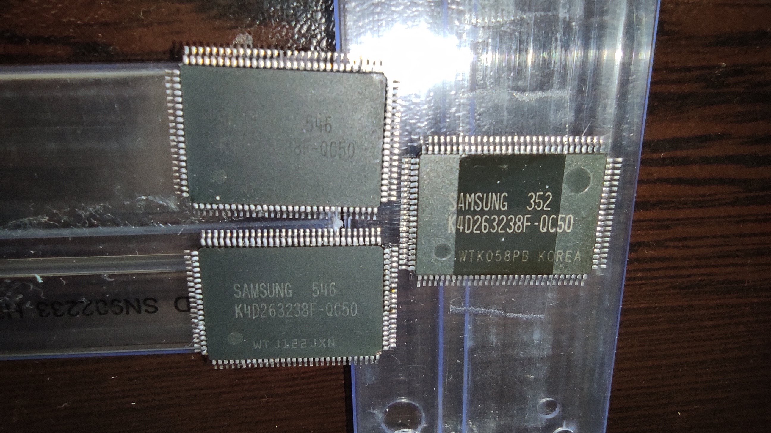

amxcs Posted February 16, 2024 Author Report Share Posted February 16, 2024 The new chips have arrived. I soldered two more and now everything is fine. Successful from the first time. Apparently I'm the first one who was sent fake chips Here is a picture of the faulty chips (left) and the new ones (right). The font is different and the letters are erased by acetone. I want to ask with 128 MB of RAM, can there be incompatibility with any game? I'm asking if I should replace my main console with it or just use it for special patched games. Quote Link to comment Share on other sites More sharing options...

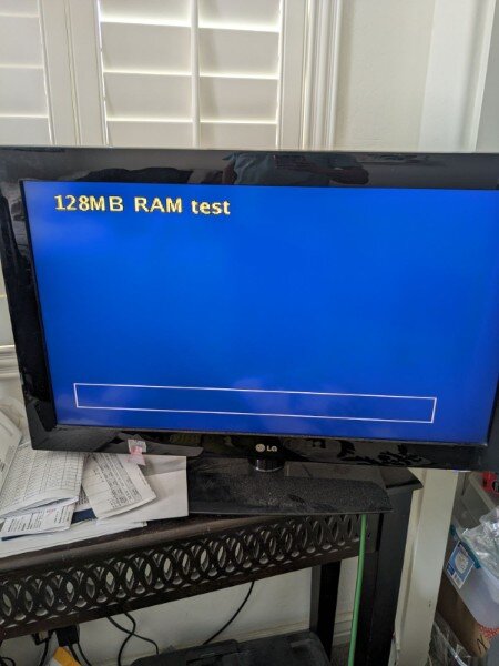

brooselee Posted February 16, 2024 Report Share Posted February 16, 2024 Hey all. I am doing an upgrade on a 1.2. Already flashed TSOP with Xblast. Put the first chip on and the RAM test wont run? Just hangs. I ran the test before placing any chips and of course it said "failed" across all 4 chips. Quote Link to comment Share on other sites More sharing options...
MadMartigan Posted February 17, 2024 Report Share Posted February 17, 2024 Check all chips for loose pins or bridged points. It could be as simply as them not being seated properly. I’ve heard Xblast chips can test all at once and other options require doing each chip one at a time. There are a few other threads about the order in which they should be done in. Quote Link to comment Share on other sites More sharing options...
brooselee Posted February 17, 2024 Report Share Posted February 17, 2024 I got it. Just reflowed all 4 chips. 2 Quote Link to comment Share on other sites More sharing options...
