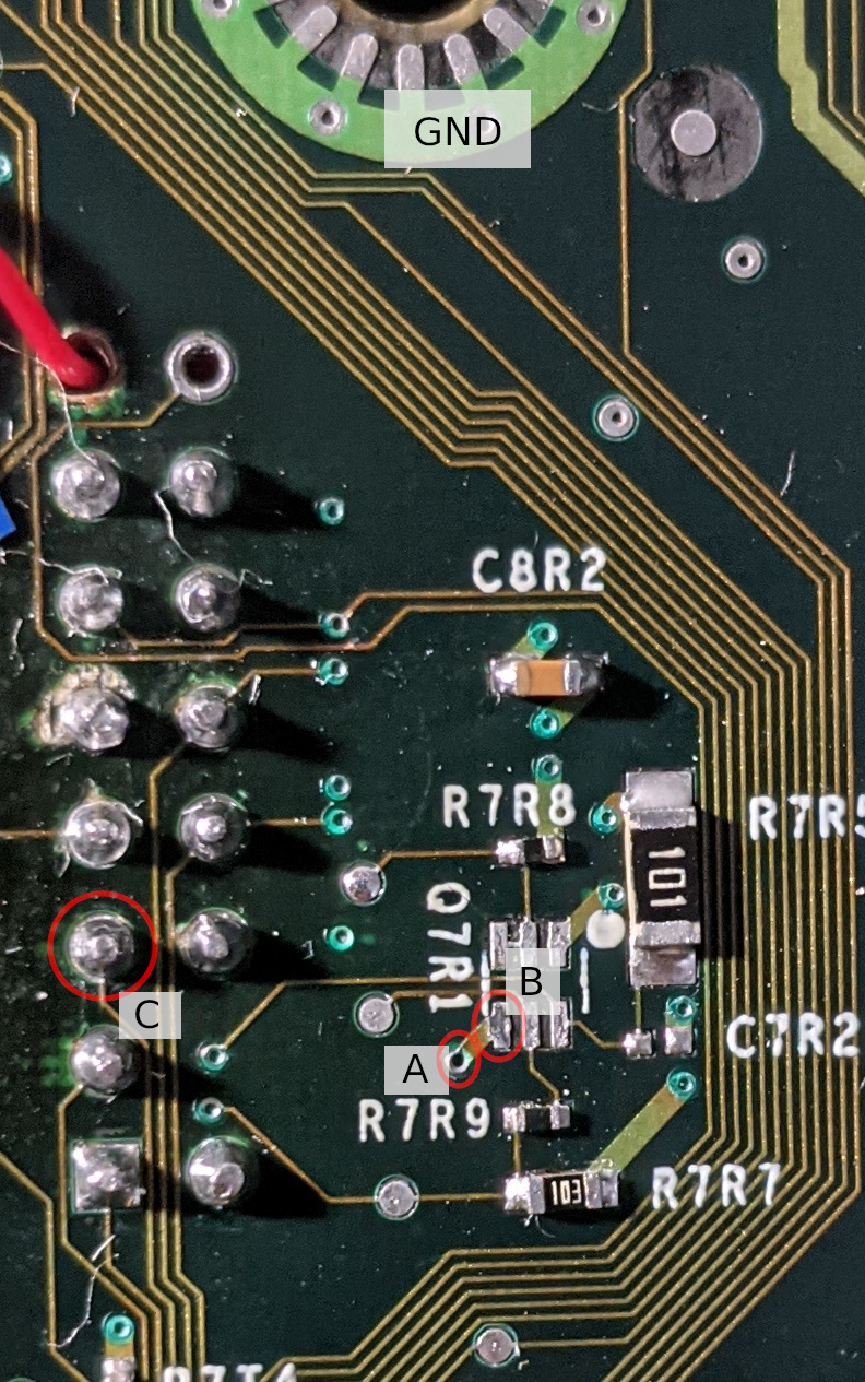

SS_Dave Posted January 29, 2021 Report Share Posted January 29, 2021 Set your multimeter to 20 VDC or if it is a auto ranging then DC volt/VDC Connect the black lead to ground of the Xbox power connector( black wires) or the metal shield. The red probe should give around the same readings as this. Don't worry if the top 2 pins read nothing The D0 should read 0 volt and should read around 3 to 5 volt for 1/2 a second when you 1st turn on the Xbox then read 0 volt that's if the D0 is connected to the D0 on the main board SS Dave Soft modding is like masturbating, It gets the job done but it's nothing like the real thing. 1 Quote Link to comment Share on other sites More sharing options...
calebTree Posted January 29, 2021 Author Report Share Posted January 29, 2021 (edited) Great, yeah, yep, I have an issue on pin 5, RST. I already reflowed the solder twice on that pin with good Chip Quik flux to no avail. I'm just getting 0.19 v every time. I could reflow the solder on all the pins later but for all I know there is internal damage at this point too. I'm just getting closer I guess. This was a board as you can see I learned some solder lessons on the hard way. Wouldn't it be nice if it got up and working again though. 14 hours ago, calebTree said: Here were the ohms Ω readings from black on D0 to red on each pin. The broken board had the TSOP write protection points R7D3 (top) and R7R4 (bottom) joined. It also had the OpenXenium chip hopefully installed correctly with a wire going from D0 to the mod chip's D0. I also want to be more specific that my data tables above were read from D0 (bottom) to the LPC pins (bottom). Edited January 29, 2021 by calebTree Quote Link to comment Share on other sites More sharing options...

SS_Dave Posted January 30, 2021 Report Share Posted January 30, 2021 There is a good chance there is a damaged trace under the pin header. Pin 5 connects to the Q7R1 6 pin ic on the bottom of the board and I think that the rest control. Now test from pin 5 on the bottom of the board to R7R5 one side of that resistor should test as 0 ohm and the other side of the resistor as 100ohm Cheers SS Dave Soft modding is like masturbating, It gets the job done but it's nothing like the real thing. 1 Quote Link to comment Share on other sites More sharing options...
calebTree Posted January 30, 2021 Author Report Share Posted January 30, 2021 (edited) Right, I get 101.3 ohms on one side and 1.3 ohms on the other side of R7R5. Good to know pin 5 connects to Q7R1. I'll have to probe around that and see what I can learn. Okay, so I have continuity between pin 5 and all the legs of Q7R1 other than the circled leg pictured above and I should which I know because I am comparing to a known working board. In the image above Q7R1 and C8R2 are missing because they fell off before I took that picture but I have since put them back on. Apparently I might have to work on Q7R1 though. Edited January 30, 2021 by calebTree Quote Link to comment Share on other sites More sharing options...

SS_Dave Posted January 30, 2021 Report Share Posted January 30, 2021 28 minutes ago, calebTree said: Okay, so I have continuity between pin 5 and all the legs of Q7R1 You should not have continuity on any pins but this one (Black/white lighting bolt) And when you refit the IC ensure the dot in the IC is toward the yellow/white arrow Cheers SS Dave Soft modding is like masturbating, It gets the job done but it's nothing like the real thing. 1 Quote Link to comment Share on other sites More sharing options...
calebTree Posted January 30, 2021 Author Report Share Posted January 30, 2021 Yeah, I don't have a buzzer type continuity multimeter so for sure on my working board like you say the black lightning is 0.0 ohms and the other pins have resistance. There's also the question of black lead on pin and red on component to test or vice versa which I haven't figured out yet. Quote Link to comment Share on other sites More sharing options...
SS_Dave Posted January 30, 2021 Report Share Posted January 30, 2021 When you where testing the pins of the IC was it on the board? 7 minutes ago, calebTree said: There's also the question of black lead on pin and red on component to test or vice versa which I haven't figured out yet. For the tests you are doing at the moment it makes no difference. Cheers SS Dave Soft modding is like masturbating, It gets the job done but it's nothing like the real thing. 1 Quote Link to comment Share on other sites More sharing options...

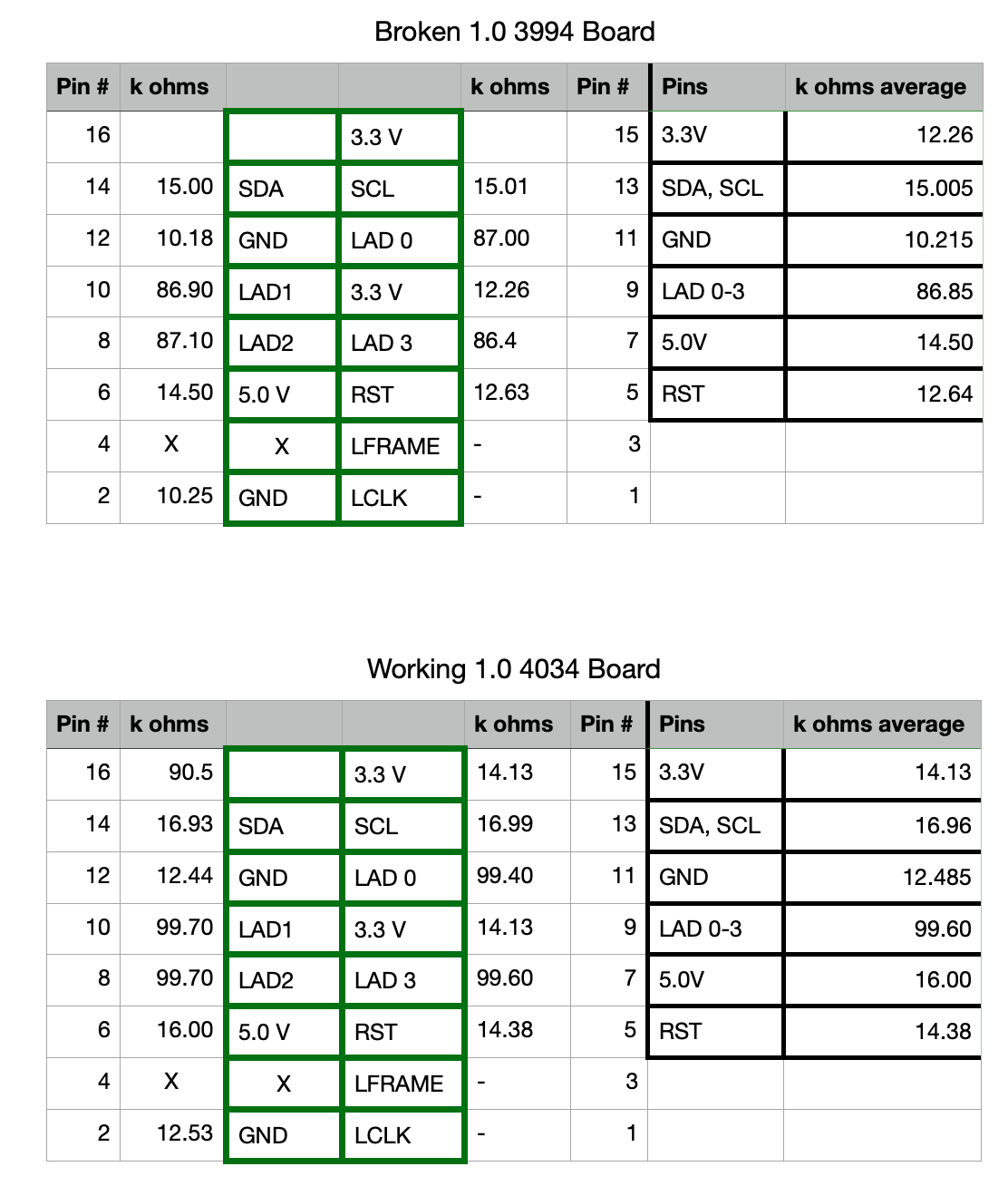

calebTree Posted January 30, 2021 Author Report Share Posted January 30, 2021 (edited) I am really surprised at how quickly the culprit could be tracked down with some strategic use of the multimeter. Honestly, the voltage test was the next thing I was going to do when I was ready to start probing the xbox with it plugged into the wall. 10 hours ago, SS_Dave said: When you where testing the pins of the IC was it on the board? Yes, the IC was on the board. Now, I decided to remove it again though and check and there is no change. When I'm talking about continuity I have to use the resistance setting on my multimeter so when I say I have continuity I mean I get a (significantly low) ohms reading. I don't get continuity between GND and A or B. Yet, I do on all the other pads of the IC and I do on the working board. I do get continuity between A (the via) and B (the IC pad). I should also get continuity between B and all the other pads of the IC but I don't. Edited January 30, 2021 by calebTree Quote Link to comment Share on other sites More sharing options...
calebTree Posted January 30, 2021 Author Report Share Posted January 30, 2021 (edited) I hypothesis there must be damage to an internal layer of the PCB from when I was impatiently trying to install the pin header using a heat gun because I didn't know how to use solder wick correctly. Eventually I learned from this video how to use solder wick correctly: https://youtu.be/xty1G5UBYb0 In the "Soldering Techniques" section of Appendix B in "Hacking the XBOX" by Andrew "bunnie" Huang, Huang does talk about removing components on a budget with a heat gun. In my experience I don't recommend it (and it's obvious from the damage) because for example my heat gun specs were: Low - 50 - 350 C, High - 200 - 500 C, Air Flow: 450L/min. As soon as a SMD would come loose it would just blow away. Compared to a proper hot air rework station which is much more gentile: 100 - 480 C, 20 - 130L/min. I am not aware of an economical way to repair damage to an internal layer of a PCB. I had fun though and learned a ton! Unless anyone has any other ideas I will have to add this board to my sacrificial pile. For those playing at home this thread was where I started this question: Open Xenium Install Question (damaged board) - Modchips - OGXbox.com Edited January 30, 2021 by calebTree Quote Link to comment Share on other sites More sharing options...
