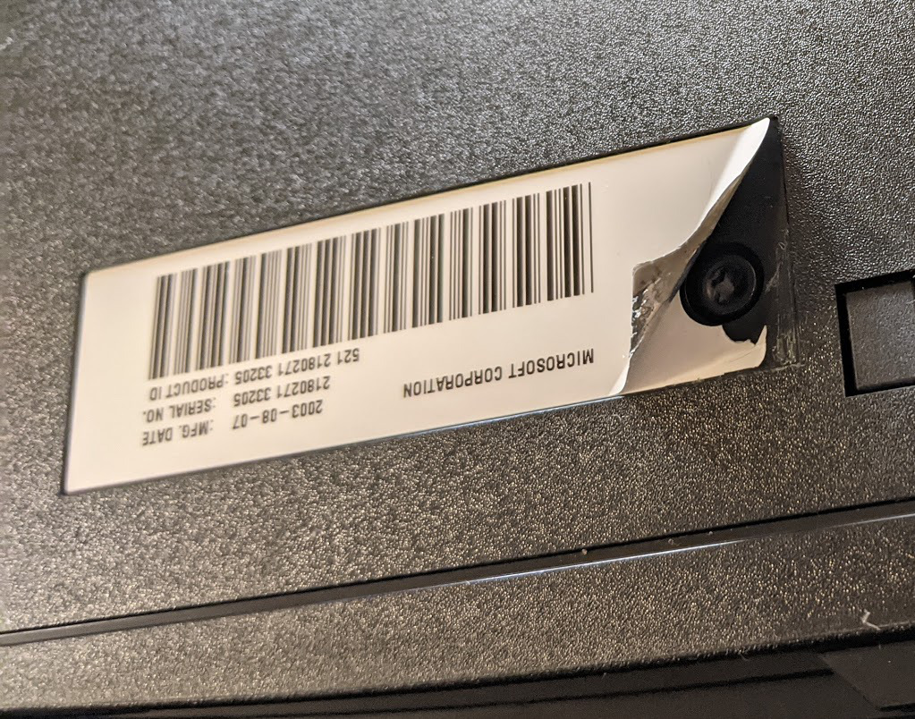

Hi everyone. Recently I've been watching some ModernVintageGamer videos on YouTube and really wanted to get out of the drawer my old modchipped Xbox. It wasn t booting anymore because of a dvd reader failure(error 11 and 12) so I got a used xbox for spare parts off eBay,got the dvd player out of it and put it in my Xbox. The Xbox boots but it won't read even original disks. My question is how do I understand what modchip is installed? Can I run any sort of homebrew via USB and upgrade my HDD ? Thanks in advance.
