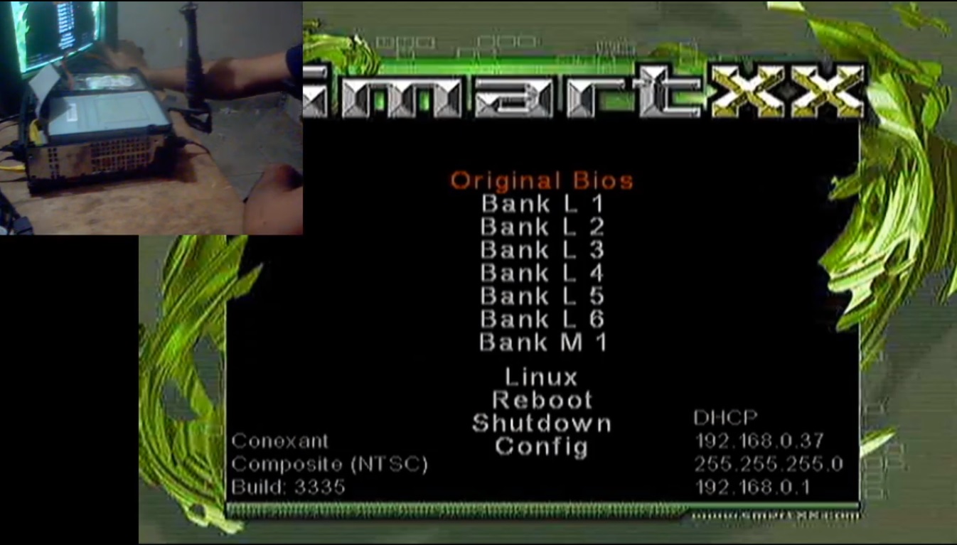

Time to get one of these modchip with multiple banks
Also, can you upload the bios file so i can test on my xbox?
