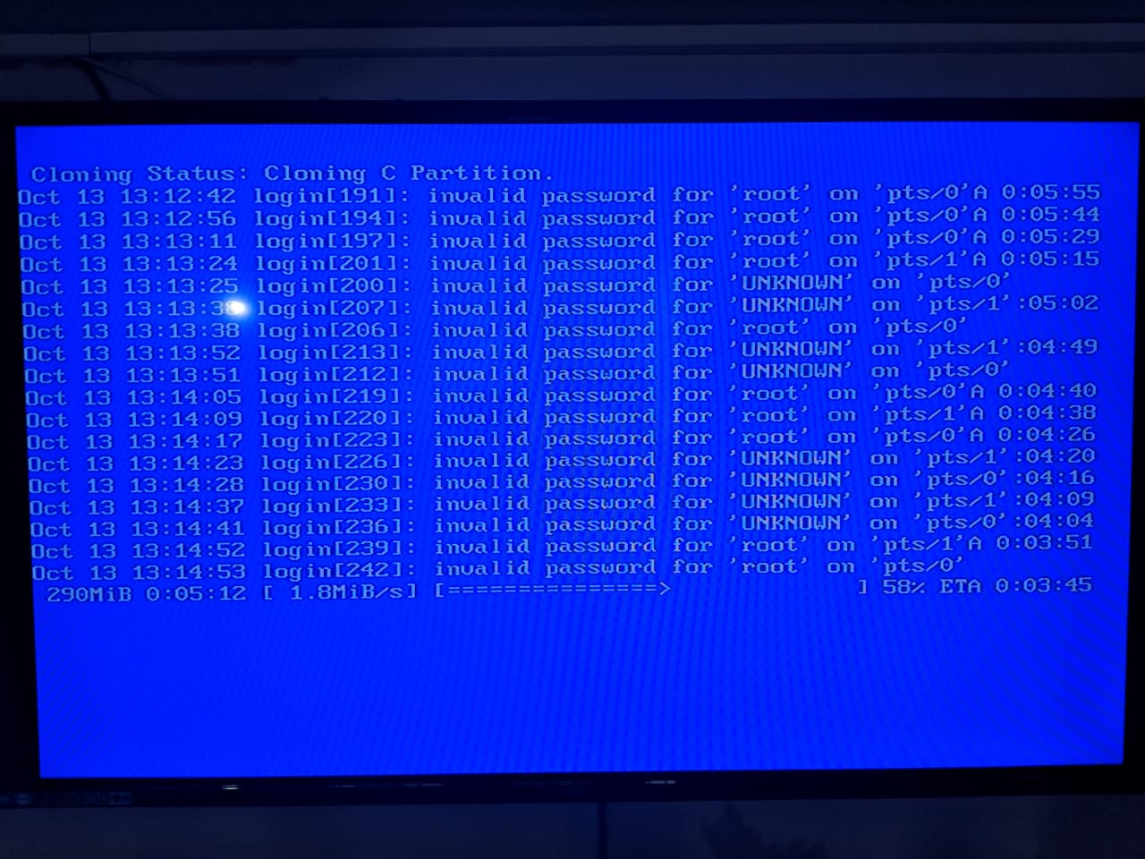

hey @Rocky5 havent finished cloning yet (started a couple minutes ago) but the status screen is showing "invalid password for 'root""  and for "Unknown" a lot.
Should I be worried or is this normal?
Details:
-Softmodded
-current 80gb ide drive with up c, e and f drive
-target drive is 320gb ide
-currently using the option to clone c,e,f > then give space after 137gb to drive G
Just a thought, where did the new drive come from,  reason is if you pulled it from a Branded pc, some of the manufacturers have been  know to put "special" firmware on the drives, which locks the computer owner to staying with them when upgrading the HDrive giving them an unsupported hardware error.  HP, Compaq, and Fujitsu have played this game I recall that Sony may have dabbled as well. Normally upgrading the drives firmware to the latest vanila version from the manufacturer fixes things.
Normally these drives work fine when not in the intended PC but in the past Ive seen some odd behaviour using them in other PCs , ghosted partitions that can be deleted but show up when partitioning the drive  and formatting issues when installing Windoze or Linux, dosent seem to be a problem when the drive is not being used as the boot  drive.

Yesterday It did complete the cloning process, however it only cloned my C & E.
and created a drive F with 120ish gbs leaving a lot of the HDD unused.
I didn't mind the info on the F partition, so I used XBPartitioner 1.3 (from downloader) to reformat that partition with allt he space (something like 250ish?)
It all went smooth for a while.
Latter, when i was FTPing stuff to that partition, something went wrong at some point of the night.
The Xbox turned off at some point and when i tried to boot it, it had Error 13 (dashboard failed to load)
So I'm currently re=cloning the drive; it seems this time i picked the correct option for it to clone the partition F as well. Its taking a sweet while to do it as expected.
My theory is, either I miss-selected the partitions options during the first cloning OR I had the auto-turn-off thingy active.
Will keep you guys posted for curiosity satisfaction purposes.
That’s an IBM drive. To my knowledge they didn’t build drives with vendor locked. Firmware, well not while I worked for them, so I think this is looking like just one of those bad incidents. This time our you may be granted better luck.
