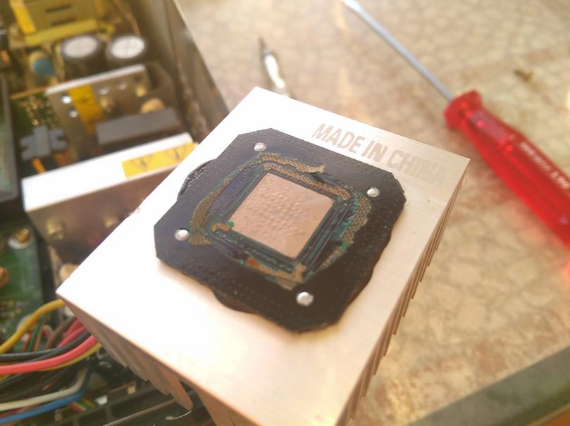

SS_Dave Posted January 1 Report Share Posted January 1 Some images why not to pry the heat sink off for something that is not needed anyway I have a pic where the entire GPU that was ripped of the PCB somewhere and if I find it i will add it here. Cheers SS Dave Soft modding is like masturbating, It gets the job done but it's nothing like the real thing. 1 1 Quote Link to comment Share on other sites More sharing options...
bulkchart32 Posted January 1 Author Report Share Posted January 1 (edited) 36 minutes ago, SS_Dave said: Some images why not to pry the heat sink off for something that is not needed anyway I have a pic where the entire GPU that was ripped of the PCB somewhere and if I find it i will add it here. Cheers SS Dave Soft modding is like masturbating, It gets the job done but it's nothing like the real thing. the pics aren't posting correctly. Edited January 1 by bulkchart32 Quote Link to comment Share on other sites More sharing options...

SS_Dave Posted January 2 Report Share Posted January 2 11 hours ago, bulkchart32 said: the pics aren't posting correctly. See if this link works for you https://postimg.cc/qzjw6Q3b https://postimg.cc/JHKh4fvQ Cheers SS Dave Soft modding is like masturbating, It gets the job done but it's nothing like the real thing. 1 Quote Link to comment Share on other sites More sharing options...
