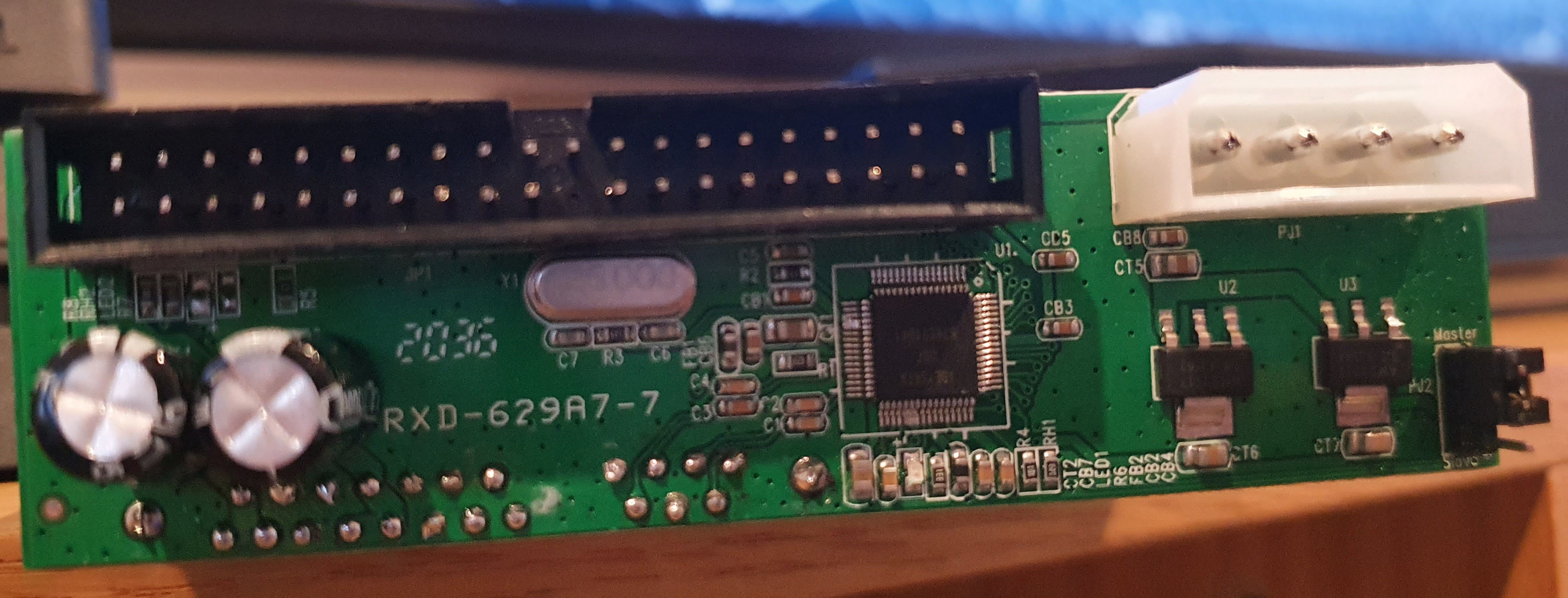

Hi there,
Noob that just join this community for some solid advice/direction for my upgrade,
I have a working 1.6A xbox with a Super Aladdin Live modchip running XBMC on a 80 Gb IDE HDD
My aim is to upgrade the HDD to a 500 Gb Sata HDD (I know I could go bigger) and also upgrade to Rocky 5 instead....
I currently have:
- The 80 wire/40 pin IDE cable (ATA 100/133)
- IDE to Sata converter
- 500Gb Sata HDD
What are my options? Do I have to hot swap the HDD with the disk drive with a program running on the xbox ?
Thanks in advance for any help or links for guides/programs to help me !!
Rocky 5 is a softmod.  It's not needed as you already have a hardmod (Super Aladdin).  There's so many things that you can do and that's what makes this scene so exciting.
A super simple upgrade is to download an Xbox HDD image (like a 500Gb Dragon build).  After you download it, you would connect the HDD to your computer and use a program like "HDD Raw Copy Tool" to write the image to the HDD.  When complete, it's as easy as plugging the HDD in and starting your Xbox.  It works right away without any tinkering.
Alternatively, you could download a program like TruHexen 2021 and burn it to a DVD.  Once the DVD is written, put it in the Xbox DVD drive, connect the new HDD and power up the Xbox.  If memory serves me correctly, TruHexen will detect the new HDD and ask you if you want to set it up.  There are a bunch of things to do in the setup process but just remember that you have a hard mod so you won't need to install a softmod.  The goal here would be to install something like XBMC4Gamers and then transfer your games/emulators to your HDD yourself.
Take a look at YouTube as there are lots of wonderful videos for the Xbox.  Mr. Mario has excellent ones.  There are demos of Dragon and XBMC4Gamers setups.
I look forward to seeing what you can do with your Xbox.  If you want some cool gadgets (like an Xbox HDMI adapter, wireless controller adapter to use Xbox One / PS4 / and other modern controllers with your original Xbox) then send me a PM.
Cheers!
1st download a copy of the OGXBox installer disk from here https://1fichier.com/?cth0up49z0ehhtm0rtce and burn to a DVD-r as slow as the burner will go.
As the bios on the modchip is probably old I would suggest you update it from the OGXbox installer disk you just made (have a look in the live apps under Bios's)
You are looking for  EvoxM8.67 cee type
Then fit up the new hard drive and use the Install disk to set up the new HDD as this will format the hard drive and install a dash board to get you started.

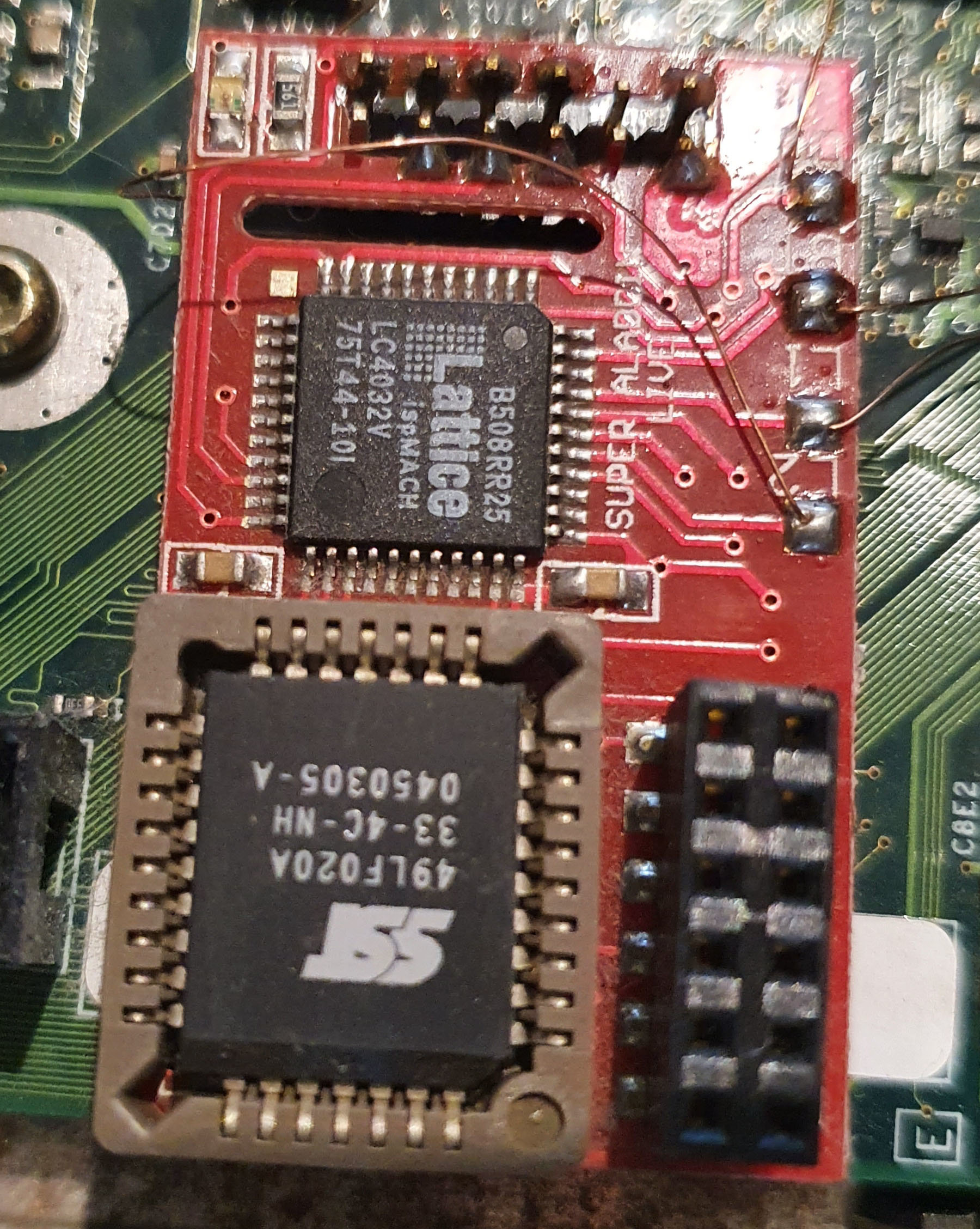

      QQ, I have what I believe a 1.4 with a bad tsop flash. Going to fit an Aladdin.#
      I only have to solder a wire from D0 to Ground right? Unless its a 1.5 then there's 2 more wires?
      Chip will be always on

      Hello
      So I have a Chip called a jafar, Its an upgraded Aladdin XT with Xblast. 1 Bank of 512, 1 256 and the last 256 is reserved for the Xblast which always boots first.
      My Question is how do I get Dual Dashboards with this? I have UnleashedX as I've always liked it but want to give XBMC a try
      Ideally I'm looking to have say Unleashed X boot with the 512mb X2 5035.137 bios and XBMC Boot with the evox.m8plus bios or visa versa
      After extensive searching online I am none the wiser, Could someone point me in the right direction to get started?

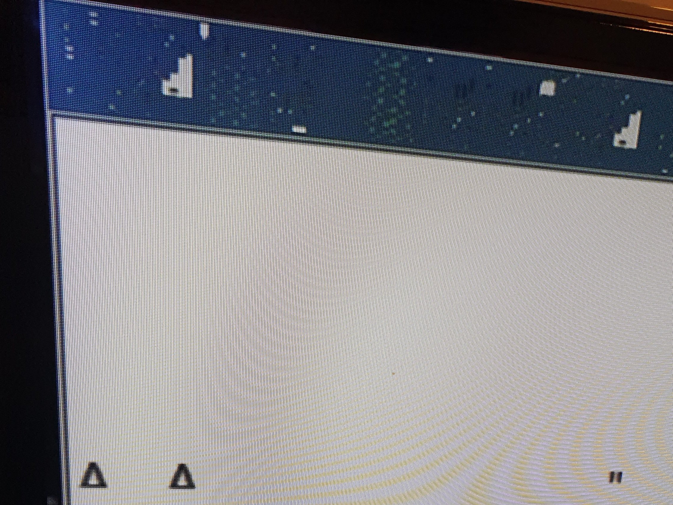

      Got this xbox with a couple of 360s and it puts the logo up and the Microsoft logo also pops up then nothing.
      Put Halo2 disc in and it booted up and showed the previous players save games so i assume the HDD is working at least. Now i thought it had been modded as when i looked underneath it had warranty stickers over the labels you have to cut to open the machine. Also the modder/repairer and also put hot glue in the torx screws (twat).
      Alas no hardware mod and i know next to nothing about softmods (my modding was always HW mods).
      Also i got this nice message when i took the lid off.
      Some suggestions would be appreciated as at the moment I'm thinking something may have happened to a softmod.
