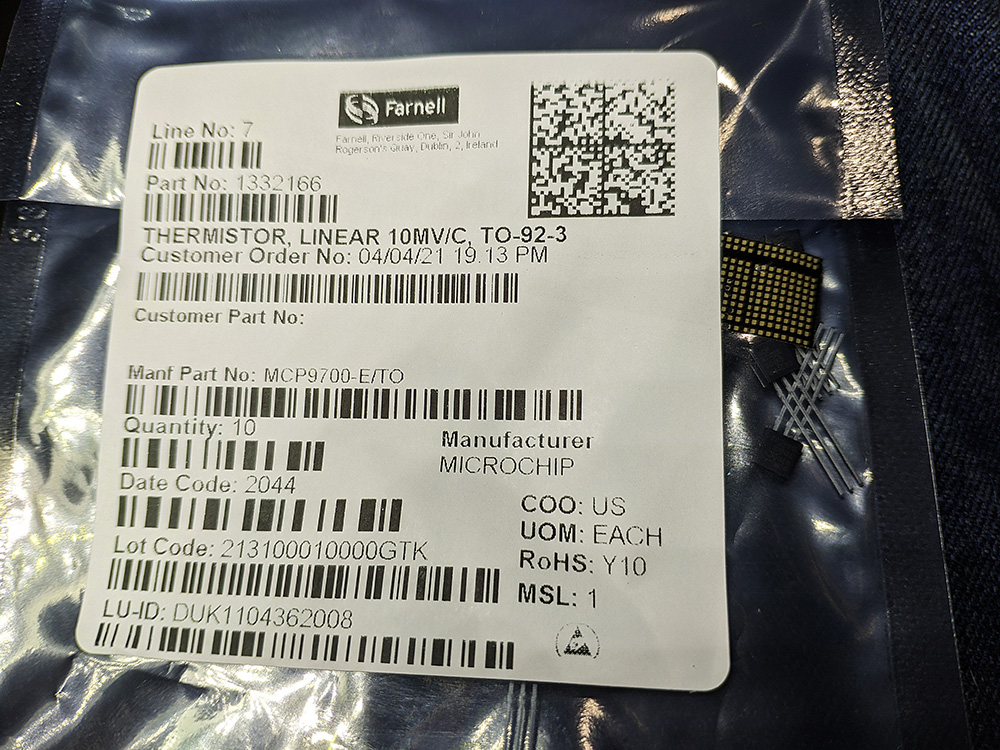

I've certainly tried to achieve some 'record' cooling on the Xbox. What I discovered, which is pretty much what I already knew, is that it's not worth the effort.
 These arrived today...
I'm going to mount them to the heat sinks of the CPU and GPU, and monitor their temps using an Arduino. Then I'm going to do the same with this board I've just added some funky heatsinks to.
And I'll guarantee there won't be more than about 1 degree difference between them.

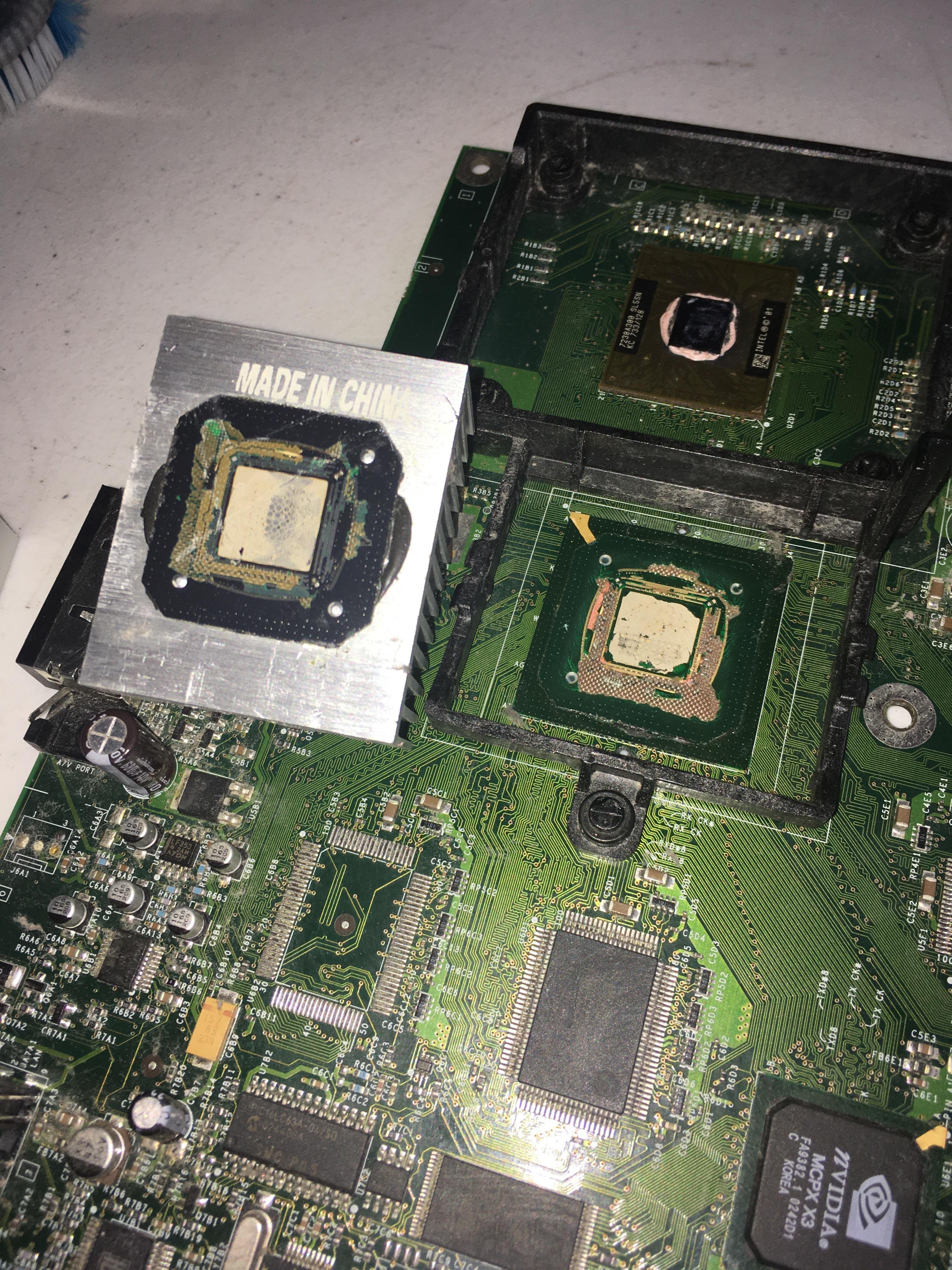

I'm thinking of cleaning the inside of my xbox but i wonder if it is save to take the sink off and if yes do i just rip it off bby force or do i need something that shoots direct heat onto it in order to get it off.
It's already been said, but the heat sink will come loose from the CPU without heat just by twisting it slightly. The GPU on the other hand will not and I would be afraid of damaging the board if force is used. A hairdryer for less than a minute is more than enough to get it to come right off with minimal effort.
That being said, there is also plenty of proof that there is little to be gained if anything by changing the thermal paste. Many will say "if it isn't broken don't fix it". That being said, I did the paste on all 3 of my modded units. The first two were 1.4 and 1.6 motherboards before I knew it made such little difference and the third was because I was replacing the GPU and heatsink on a 1.0 to eliminate the noisy fan.
Here is some GPU heat sink removal fails
This is from over 12 months ago and the person levered the heat sink off.
This one on reddit from last week and once again no heat and just twisted (apparently)
In my view don't touch the GPU heat sink as there is no gains to be had.
