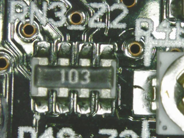

van0014 Posted January 25, 2020 Report Share Posted January 25, 2020 I use a "1600x USB microscope". It's not a perfect setup, but has adequate zoom. There's some adjustments in the mounts, to hold the camera really steady. Learn them, and the plastic mount will remain firm and reliable. Mine had 2 adjustments, one holds the ball and socket that holds the camera directly. The other pivots on the base. -If you use phone apps or alternate software, needing to mirror and flip the image so it moves as you expect -Suction cup can loose grip, and the camera can end up falling onto your LGA CPU socket, bending even more pins (Don't trust the mount if your working on anything delicate) Quote Link to comment Share on other sites More sharing options...
