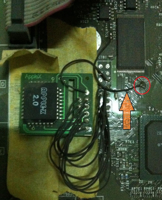

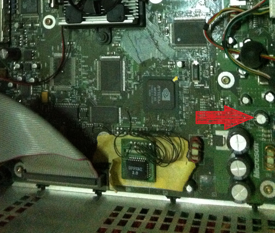

thanks for the help but yesterday i opened my xbox and i found it has modchip its name applex i took a photo for it and is it a good modchip and what is it features and also when i turn on my xbox it flashing green and orange and also after i cleaned my xbox turn off with sound and when i take off the ide power cord it works can you tall me why and can i remove the modchip and add another one i took photos and videos
photo one https://mega.nz/file/to1liAbb#EcwFSkRV1qq6433Z5lkuQWNMboQGvIthgZJyYe8oXbo
photo 2 https://mega.nz/file/t8sACRxL#MH2X47urzBR7Nx1xXAvjXeQawoCgI7ip07qDYrOkZfo
video after cleaning https://mega.nz/file/AhtQjbDA#i7ccp_vo_0TxKpaI1fQ-Ja4Ef7eZ4zc3dsV75KzPo_E
video when i turn it on flashing https://mega.nz/file/N9tUnZqR#0Kcr7WVzyfuut-2EHW_tCUhlpm6jRzeyWTR21bfpqKM

The AppleX chip is a old modchip and was install mainly to play backup's of your games (copies), The bios that's on that chip will allow you to load copies and homebrew disk's like install disk's and would also allow a new hard drive with a maximum size of 137gb.
In the other pic it looks like the clock cap is still there and it should be removed or replaced as it can leak and damage the board
The sound in one of the videos sounds like the hard drive is old and about to stop working.
The Orange/Green light is normally no AV cable.
As you are wanting to have a LCD screen you will need to remove this chip.
A lot of people that are new to soldering struggle with fitting a pin header to LPC port on this version of Xbox because there is solder filling the holes on the LPC port.
I am not sure of your soldering experience but if you have not had a lot of experience then find a old circuit board and practice on that 1st.
The wire in this pic is the D0 wire and you can leave it as it is, As the new chip will also need it and a lot of people have problems soldering the wire in the red circle.

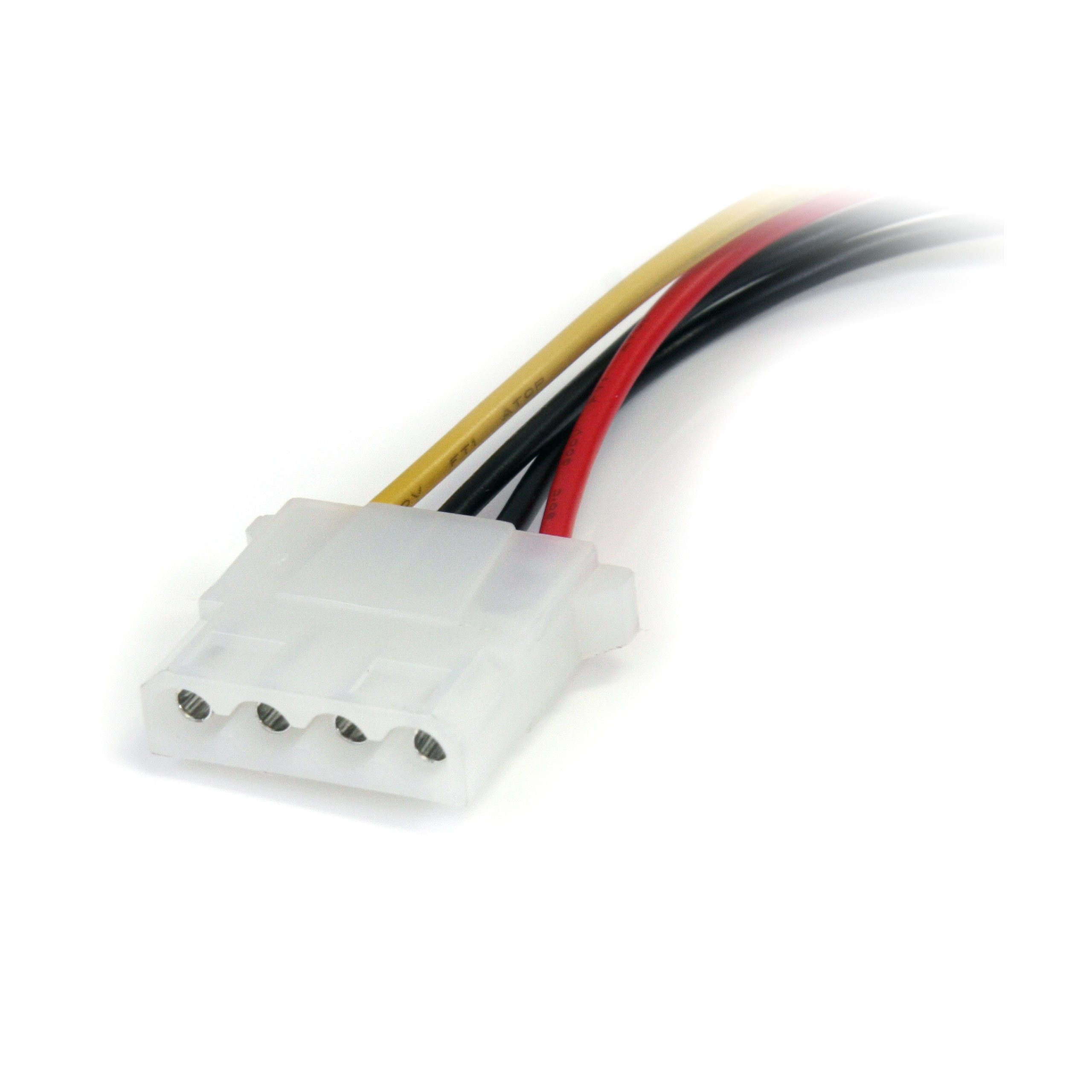

6 hours ago, adam hunter said:
when i remove ide power cord my xbox works
Do you mean the 40 pin plug?
Do you get a picture on the screen?

the ide power cable photo in the attachment

On 7/13/2021 at 8:21 PM, adam hunter said:
when i remove ide power cord my xbox works when i put it back it turns off also when i put another hard dive it works for short time then turn off
You might have a power supply problem.

look i forget to tall that i took the hard drive for the xbox and put it in my pc and opened a program to check out the hard drive it told me that the hard drive is so bad and when i put another hard drive the xbox works for short time then turn off and is Open Xenium has the ability  to add hdmi slot because i saw many xbox owners their xboxes have hdmi slot and how do i know if the xbox 1.0 power supply and should i buy 100 watt or i can buy 200 watt

11 hours ago, adam hunter said:
thanks for the help but you still not told me about why the xbox shutdown after i put another hard drive how i can let it run
What voltage reading have you got on the yellow and red wires at the power connector with out the HDD connected.
I think the power supply is probably shutting down with the extra load of the hard drive.
