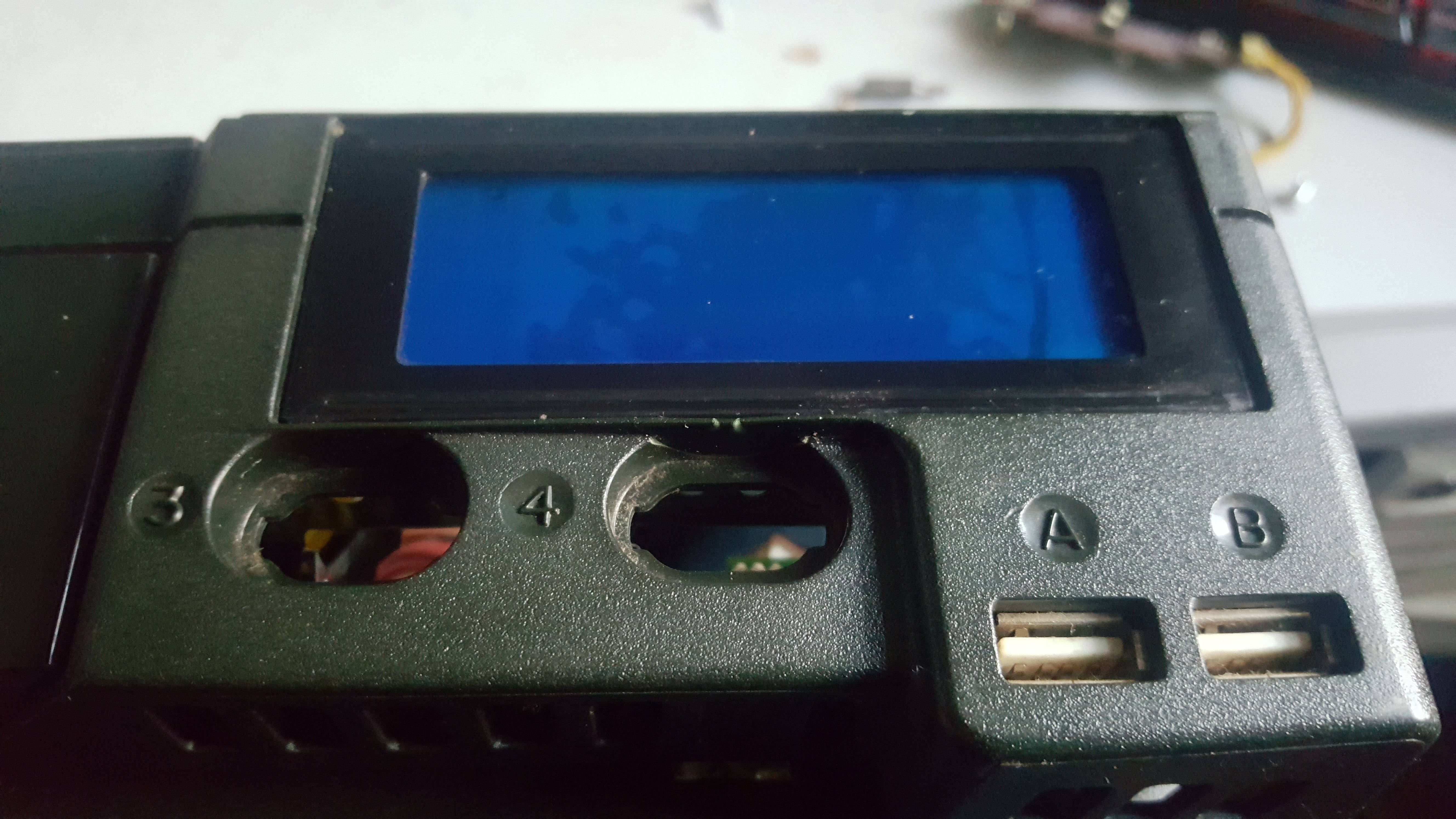

bad news for me :( i got it all working with xbmc4gamers, enabled the lcd and everything was running great.... so i started to strip it down to change the rusty cage, and when trying to remove the front i have somehow managed to bugger the lcd up, i was really careful and even prized it off from the opposite side to the lcd, now theres a bleed of some sort and the display is hardly readable, it was perfect before i messed with it, i am absolutely gutted :( its just lying here in bits now and i cant even be arsed to put it back together, RIP my sweet X3CP xbox...

It turns out the LCD wasnt broke, the previous owner has spilled a drink or something, i just didnt notice when I first tried it as the lcd worked (plus it didnt help i had accidentally turned the wheel down on the chip when i was removing it from the rusty cage!),  Ive learned a lot about these little lcds in the last couple of days, i stripped the lcd down, alcohol cleaned the board/lcd contacts/rubbers/backlight and put it all back together and the display is bright and clear.  the whole console has been stripped and cleaned, i changed the cage and top from a nice condition xbox, i stuck with the 1.0 board as the gpu fan is fine and im just glad that shes up and running now.  I paid £65 including shipping from a guy on ebay who said it was his grandsons and he didnt know anything about it, im beginning to doubt his story but not to worry the spillage is all sorted and everything is running great, also xbmc4gamers works a treat with the lcd :)
One thing, the only bank selection combo which works is if i depress 1 AND 2, 1 on its own brings up a basic blue 'Xecuter' screen with options to lock / unlock the hard drive, 2 on its own does the same, 3 and 4 on their own don't work at all, but im leaving well alone, im not going to start messing with BIOS flashing :/

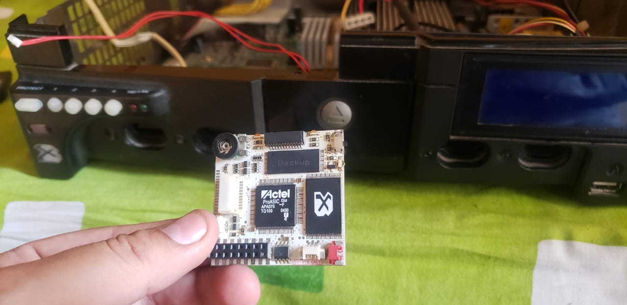

I have x3ce modchip with all wires and a with x3CP i want to sell it, how much do you think i can sell it on Ebay??
No xbox included
1567838913_WhatsAppImage2021-01-10at7_41_37PM.thumb.jpeg.88546262883b79036e64b8fcebacb9ca.jpeg
PM sent

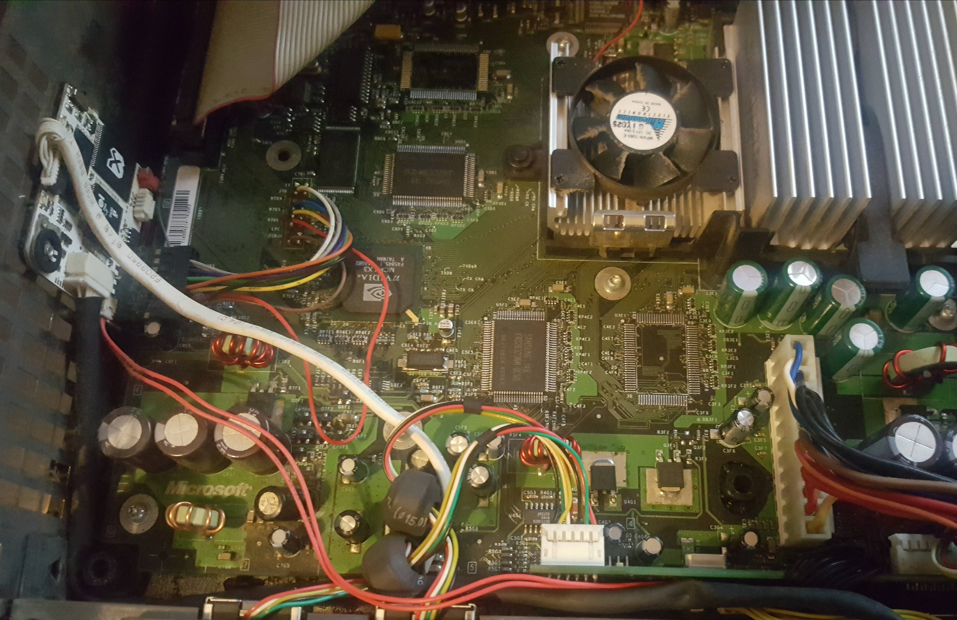

      My modest modification.
      128MB Ram
      New Fan
      Open Xenium Chip with Ryzee119's XEnium Spi2par2019
      To be continued...
