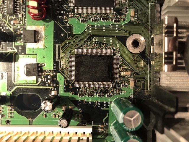

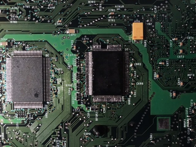

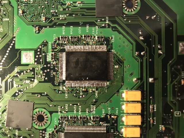

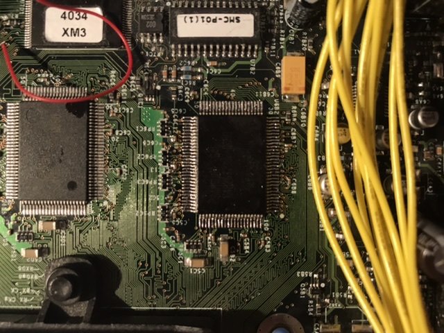

I tried to upgrade my V1.0 Xbox with 4 Samsung version F RAM chips but it won’t boot. I’ve got an OpenXenium mod chip installed but I’ve tried booting both with and without yet it still flashes. Anyone know what this means/ anyway to fix it? Any help would be much appreciated.
Here are the photos of each ram chip. I know some pads are lifted but I compared them with the pin out and they aren’t connected to anything.

Bad pic's but on every chip it looks like you have some bridged pins. Check all legs with a magnifier or a multimeter, in case you have one. I bet you will find some shorts.
I’ll make sure to check now, one issue is I don’t know if any pins on the chips are supposed to be connected so even if there are no bridges they still could be showing continuity.
2 minutes ago, sweetdarkdestiny said:
True. Thats why you should use a magnifier as well. Double check. ;)
I'll get a magnifier tomorrow and see if there are any bridges. Fingers crossed I find some because I really don't want to have a dead xbox 😅. Are all RAM chips compatible with all versions?

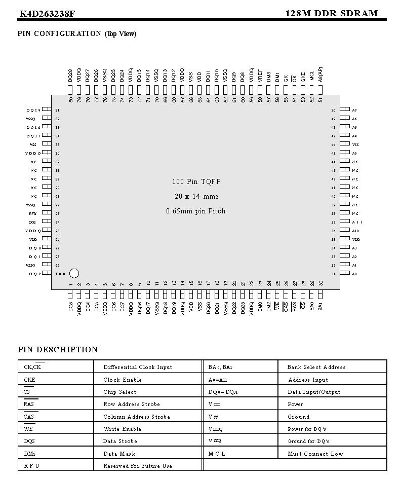

And you get a pinout today for free (normaly you get those for your posting no.10 but we make an exception here. :D ).
 About the ram i guess you're good. You can't mix samsung with hynix but thats not the case here so no worries. ;)
