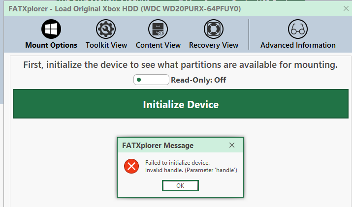

FatXPlorer 3.0 Beta
xicat487

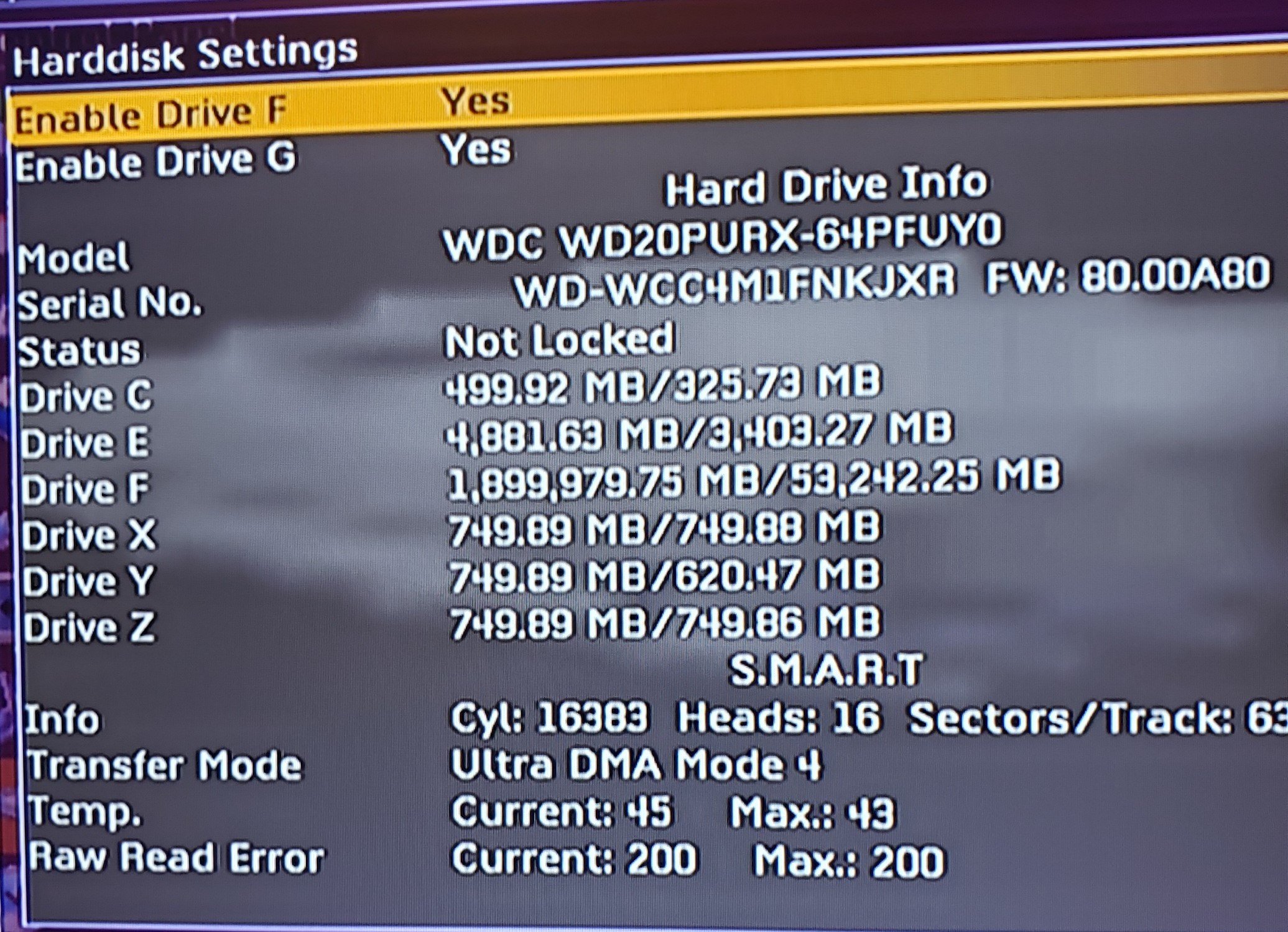

The F and G partitions are not set correctly

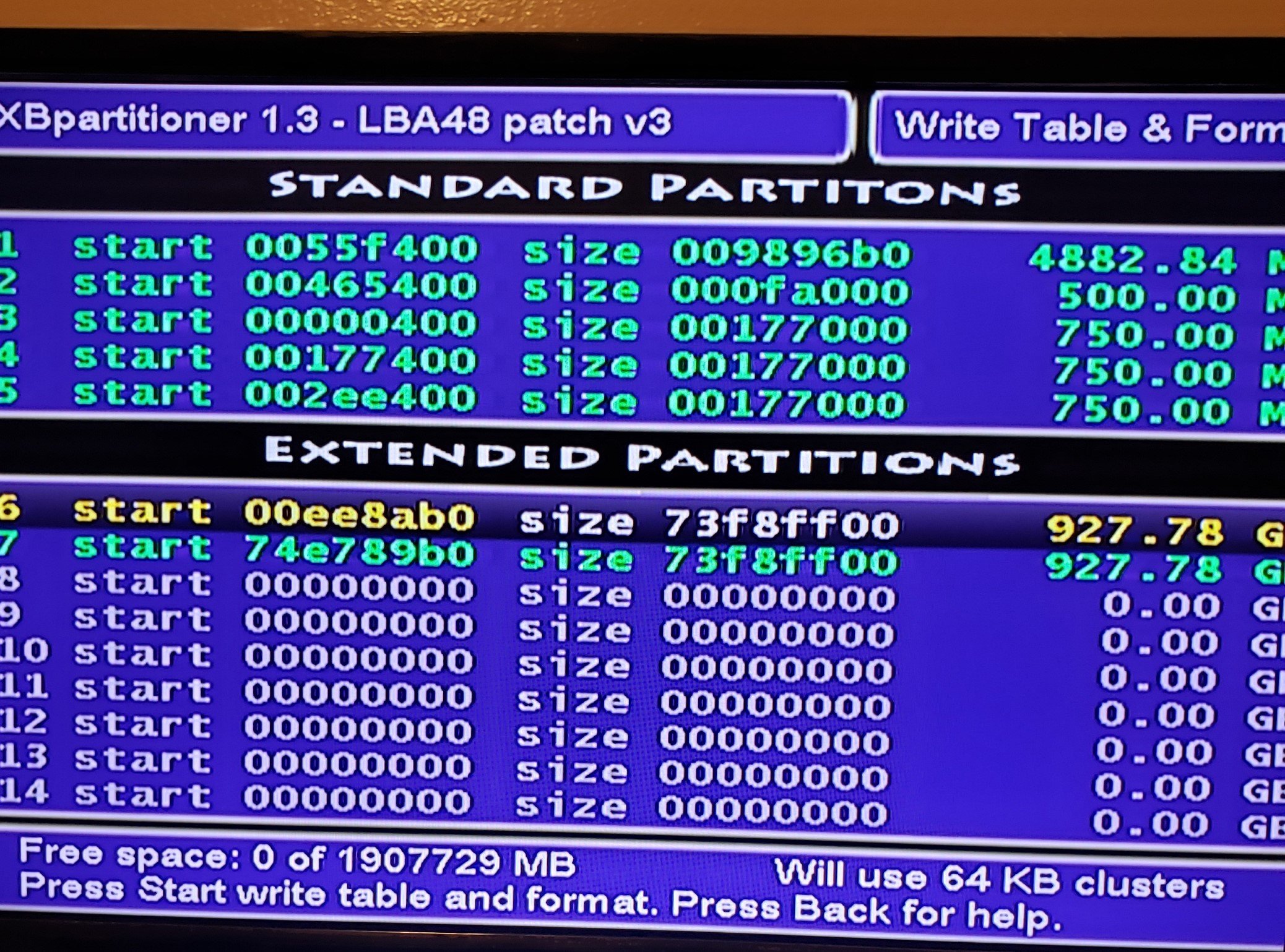

Put it back in the Xbox and run Xbpartitioner 1.3 to set the F and G to  even max size and they should be 64kb clusters.
That's ok
I use the X2-5035.67 for the 1.0 -1.1 TSOP flashed and the IND 5004.67 in the 1.2 -.14 TSOP flashed  and the Evox_M8+_67 for the Version 1.6 boards
The *****.67.bin means F and G drive.
