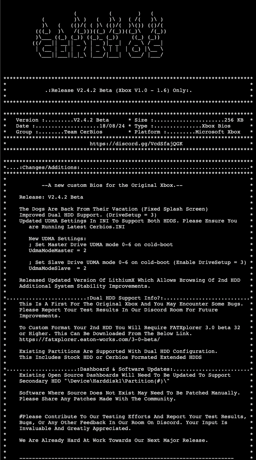

Dempsey_86 Posted August 18, 2024 Report Share Posted August 18, 2024 (edited) Cerbios v2.4.2 Beta did release. Download here: https://www.xbox-scene.info/forums/topic/445-cerbios-download-thread/ Edited August 18, 2024 by Dempsey_86 3 4 Quote Link to comment Share on other sites More sharing options...
Dempsey_86 Posted August 18, 2024 Author Report Share Posted August 18, 2024 Cerbios Features listed as of latest release 2.4.2: Hybrid Bios Retail / Debug for all xbox revisions 1.0-1.6b Fully compatible with Insignia Support HDD sizes up to 16TB Single & Multiple Extended Partition Support & Cluster Sizes 1-2 TB partition with 128 KB cluster size 2-4 TB partition with 256 KB cluster size 4-8 TB partition with 512 KB cluster size 8-16 TB partition with 1024 KB cluster size Native XISO Support CCI (Cerbios Compressed ISO) support Boots All Originals / Unsigned Code / Backups Boots Debug XBE's Full 128MB Ram Support Force 480I to 480P Support for an upcoming RTC hardware module to maintain time sync HD+ Support (NeMesis/MakeMhz) No Reset On Eject No Patch Hack Customise the bios with cerbios tool or trough a .ini Customising options: IGR (CerbiosTool only) IGR To Dash (Reset To Dash: LT+RT+Back+Start) IGR Reset Game (Reload Current Game: LT+RT+Black+Start) IGR Full (Full System Reset: LT+RT+Black+Back) IGS (In Game Shutdown: LT+RT+BACK+DPADUP) IGPC (In game Power Cycle: LT+RT+BLACK+DPADUP) No AV Cable Check No DVD check with no additional dongle / hardware 1 = HDD & No DVD (Legacy Mode) Same as Existing Bioses 2 = HDD & No DVD (Modern Mode) Complete Removal Of DVD Code 3 = Dual HDD (Add a 2nd HDD in place of the DVD drive) Front Led Colour Force 480p ForceVGA Fan Speed RTCEnable Block Xbox dashboard updates Boot animations path Animation Colors Dash Paths CD Paths UDMA Speed 0-6* (In case of dual HDD, both drives can support different UDMA settings) 0 = Auto setting (Startech adapter) 1 = Auto setting (Generic adapter) 2-6 = Fixed UDMA setting Debug on/off Colour of the dogs (cerbios tool only) Scaling of dogs (CerbiosTool only) Theme support (CerbiosTool only) External Boot Animations Modern, Xbox, Nyan Cat and XMV Player (Convert Your Animations To XMV Movie Files) Custom Error Messages With Full Explanation Universal Region Fix Invalid time reset Macrovision Protection Disabled Dual HDD Support Safemode, Press Eject to force UDMA2 on boot Automatic reboot into safe mode (UDMA2) if error 13 or 18 is occurring Parental Control Removal Ability To Launch Cerbios As A BFM Bios Via PBL Methods Experimental VGA Support Block Xbox dashboard updates via Cerbios.ini CerbiosTool Cerbios ISO and CCI compatibility lists * UDMA Modes explained: UDMA = transfer mode used by the kernel Increasing the UDMA mode has been profiled to improve some game load times in excess of 20% A full benchmark with SSD + StarTech shows disk IO is 70-100% faster across the board Increasing the UDMA mode will require an 80 wire IDE cable The retail Xbox uses UDMA 2 (33mb/s) by default The maximum supported UDMA mode by the Xbox southbridge is UDMA 6 (133mb/s HDD <--> CPU) UDMA 6 is experimental, use at your own risk UDMA 6 DOES NOT WORK WITH ALL IDE TO SATA ADAPTERS UDMA 6 is confirmed to be working and stable with StarTech adapters UDMA 5 and 6 are unstable on RXD-629A7-7 based adapters, but UDMA 4 seems okay WLXKG-863B are the 'worst' adapters I have experienced working and are largely untested For more info about IDE to Sata adaptors please visit the IDE to Sata adapter compatibility thread 2 Quote Link to comment Share on other sites More sharing options...

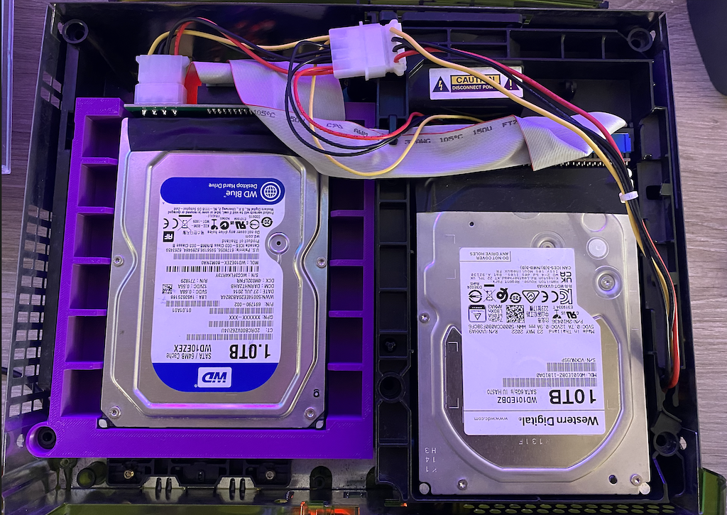

phrunt Posted August 19, 2024 Report Share Posted August 19, 2024 Whoever makes second hard drive bays is going to make a fortune shortly I need one myself. I think it's a great idea. Quote Link to comment Share on other sites More sharing options...
Dempsey_86 Posted August 19, 2024 Author Report Share Posted August 19, 2024 11 minutes ago, phrunt said: Whoever makes second hard drive bays is going to make a fortune shortly I need one myself. I think it's a great idea. You mean like this? Thats from @NeMesiS He sells them here on ebay: link 1 1 Quote Link to comment Share on other sites More sharing options...
phrunt Posted August 19, 2024 Report Share Posted August 19, 2024 Awesome thanks, he's in Australia too which is handy for me being close by. 1 Quote Link to comment Share on other sites More sharing options...
nikeymikey Posted August 20, 2024 Report Share Posted August 20, 2024 14 hours ago, Dempsey_86 said: You mean like this? Thats from @NeMesiS He sells them here on ebay: link Gonna need a couple more of those myself. The one I have currently sits in the console with the extra fans mod. @NeMesiS better get those printers running!! Quote Link to comment Share on other sites More sharing options...
