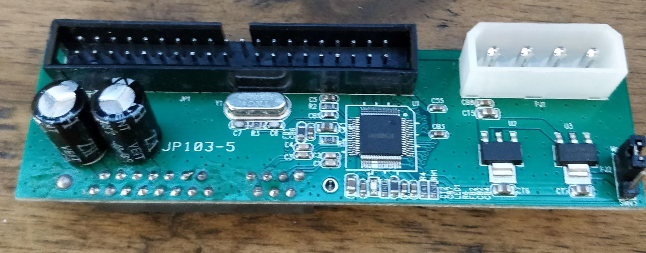

I bought a cheap sata to ide adaptor to do a 2tb install, after completion I was getting crazy long wait times for the xbox to even load it was such a disappointment .  Buy cheap buy twice!  I have a startech one now and it works fine completely night and day.

I don't have any problem with this one, but I always change capacitors by panasonic caps, and check twice all solders.
This adapter only use 5V even if the 12V is conected
bye
I have 2 of the same and both work fine.
But the first of them had a solder bridge on the controler chip which i have fixed.
Maybe you have se same problem and maybe it could help to resolder the joints on the resisors and caps and power like i did on both of mine. The original used solder is horrible.
But i also have to admit that i bought both as amazon deal for 5 euros each so for me it was worth the hassle. ;)
I have several of them  in use and I have only had one faulty in the last 3 years and that did not work at all.
I have had more problems with the IDE leads than the adapters.
