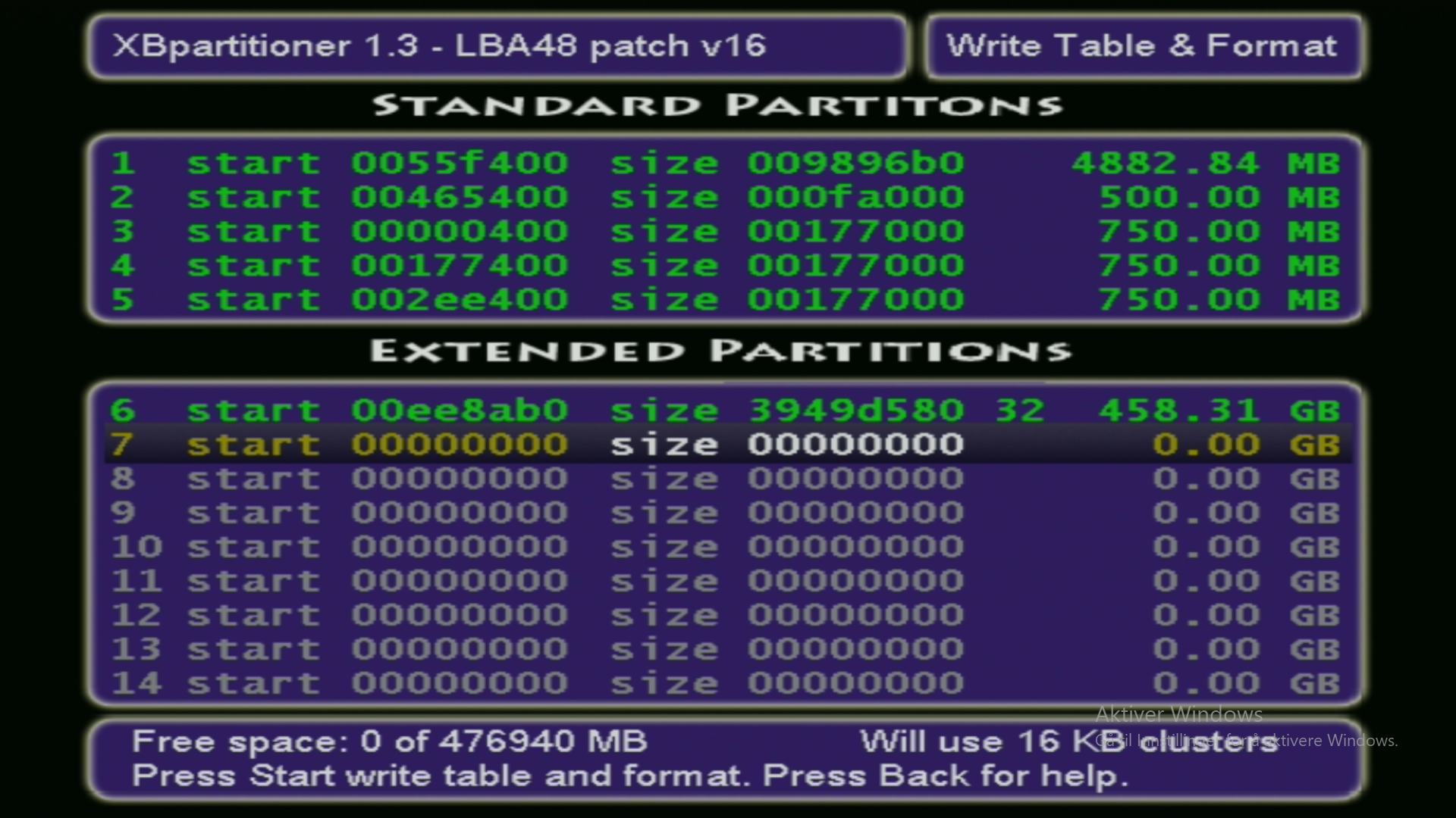

naits Posted February 11, 2020 Report Share Posted February 11, 2020 Hello, I've just upgraded my hard drive. Added a 80-wire 40 pin and with a pata to sata adapter. It cloned just fine. I selected selective partition (C,e,f and g) as it stated G would take the rest of the space. It's a 500Gb hard drive. But.. It says partition G is 0Gb available.. And F is at 120Gb. But XBpartitioner 1.3 sees G at around 300Gb. So why isn't it available for me to use? But really F can take it all correct? So no need for G..? Okay, I disabled partition G and filled partition F with all it can have(it said 400Gb ish) and I wrote that to the disk with XBpartitioner 1.3. And now it says it only has 246Gb... Where did the rest go... I'm lost UPDATE: okay... UnleashX shows me under storage menu that is "sees" 469Gb ish.. But only available 246Gb... But the partition is empty??? Anyone got a clue? Quote Link to comment Share on other sites More sharing options...

naits Posted February 11, 2020 Author Report Share Posted February 11, 2020 19 minutes ago, SakisTheDrifter said: Go to settings of UnleashX and enable G drive Both F & G is enabled. Also XBpartition: Quote Link to comment Share on other sites More sharing options...

naits Posted February 11, 2020 Author Report Share Posted February 11, 2020 This is now solved... I just didn't actually "write" to the partition when I tried to completely delete it.. After I did that and re enabled the partition and formated it again, it shows up as 469Gb. Quote Link to comment Share on other sites More sharing options...
