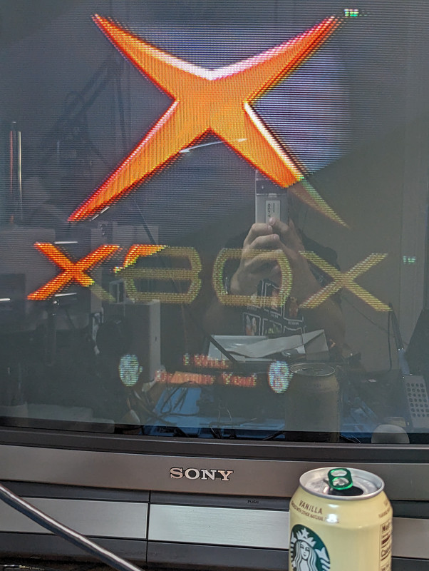

Bowlsnapper Posted October 16, 2023 Report Share Posted October 16, 2023 @SylverReZ Thought you might get a kick out of this. Opened another x3 box but when I booted it, I saw this 1 Link to comment Share on other sites More sharing options...
SylverReZ Posted January 30, 2024 Author Report Share Posted January 30, 2024 On 10/17/2023 at 12:32 AM, Bowlsnapper said: @SylverReZ Thought you might get a kick out of this. Opened another x3 box but when I booted it, I saw this Haha, that's awesome. Any idea what the text says underneath? Link to comment Share on other sites More sharing options...
Bowlsnapper Posted January 30, 2024 Report Share Posted January 30, 2024 1 hour ago, SylverReZ said: Haha, that's awesome. Any idea what the text says underneath? It says, "I Will Destroy You". Lol. 1 Link to comment Share on other sites More sharing options...

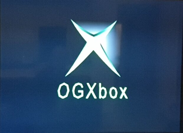

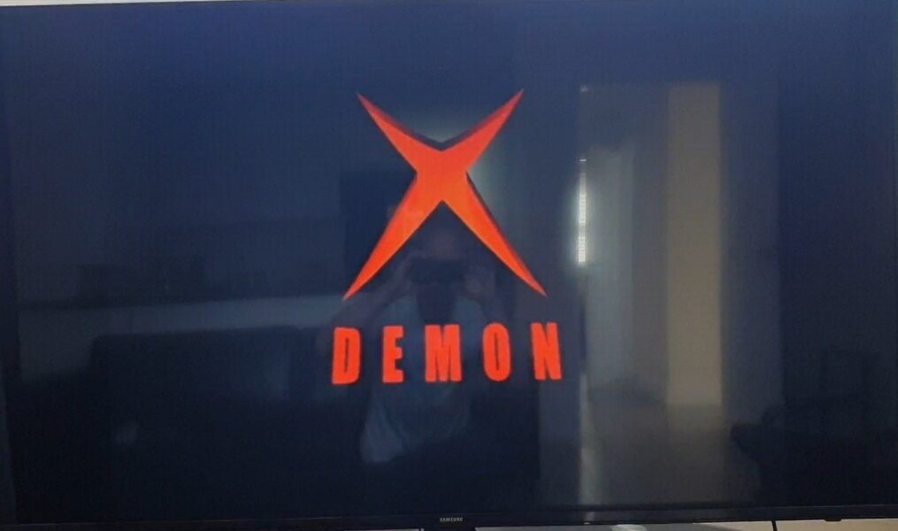

ShinGoutetsu Posted January 30, 2024 Report Share Posted January 30, 2024 (edited) I used to mess with x2 bios's but only changing the xbox text, been a while since I've done it though. All in bios, x2 4981 so no config files Edited January 30, 2024 by ShinGoutetsu 2 Link to comment Share on other sites More sharing options...

Bowlsnapper Posted January 30, 2024 Report Share Posted January 30, 2024 4 hours ago, ShinGoutetsu said: I used to mess with x2 bios's but only changing the xbox text, been a while since I've done it though. All in bios, x2 4981 so no config files The "Demon" one looks SICK. 4 hours ago, nikeymikey said: Seeing as there seems to be some confusion about x3 in this thread, I can confirm that the X3 bios lets you change the MS logo, it just needs the file on the HDD C root. I currently have a Nike Swoosh on my X3 system Correct me if I'm wrong, but the X2 does the logo by embedding in the bios and the X3 uses a file on C (if present), correct? 1 Link to comment Share on other sites More sharing options...
Zerg Posted January 30, 2024 Report Share Posted January 30, 2024 5 hours ago, ShinGoutetsu said: I used to mess with x2 bios's but only changing the xbox text, been a while since I've done it though. All in bios, x2 4981 so no config files Can this be accomplished with the X3 bios? I have changed the M$ logo beneath the "XBOX" text, but never the text like that. Is this an X2 exclusive feature? Link to comment Share on other sites More sharing options...
ShinGoutetsu Posted January 31, 2024 Report Share Posted January 31, 2024 4 hours ago, Zerg said: Can this be accomplished with the X3 bios? I have changed the M$ logo beneath the "XBOX" text, but never the text like that. Is this an X2 exclusive feature? There are tools to edit the bios and inject a .x file in place of the text for the x2 bios, I don't know about the x3 bios though. The .x files were created in 3dsmax. Link to comment Share on other sites More sharing options...
