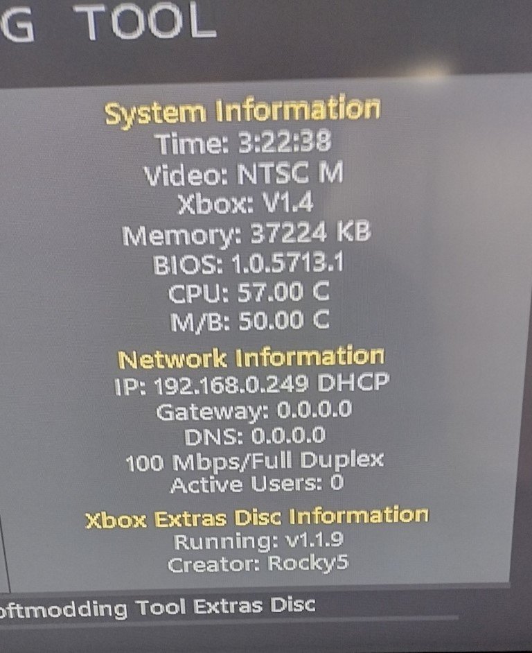

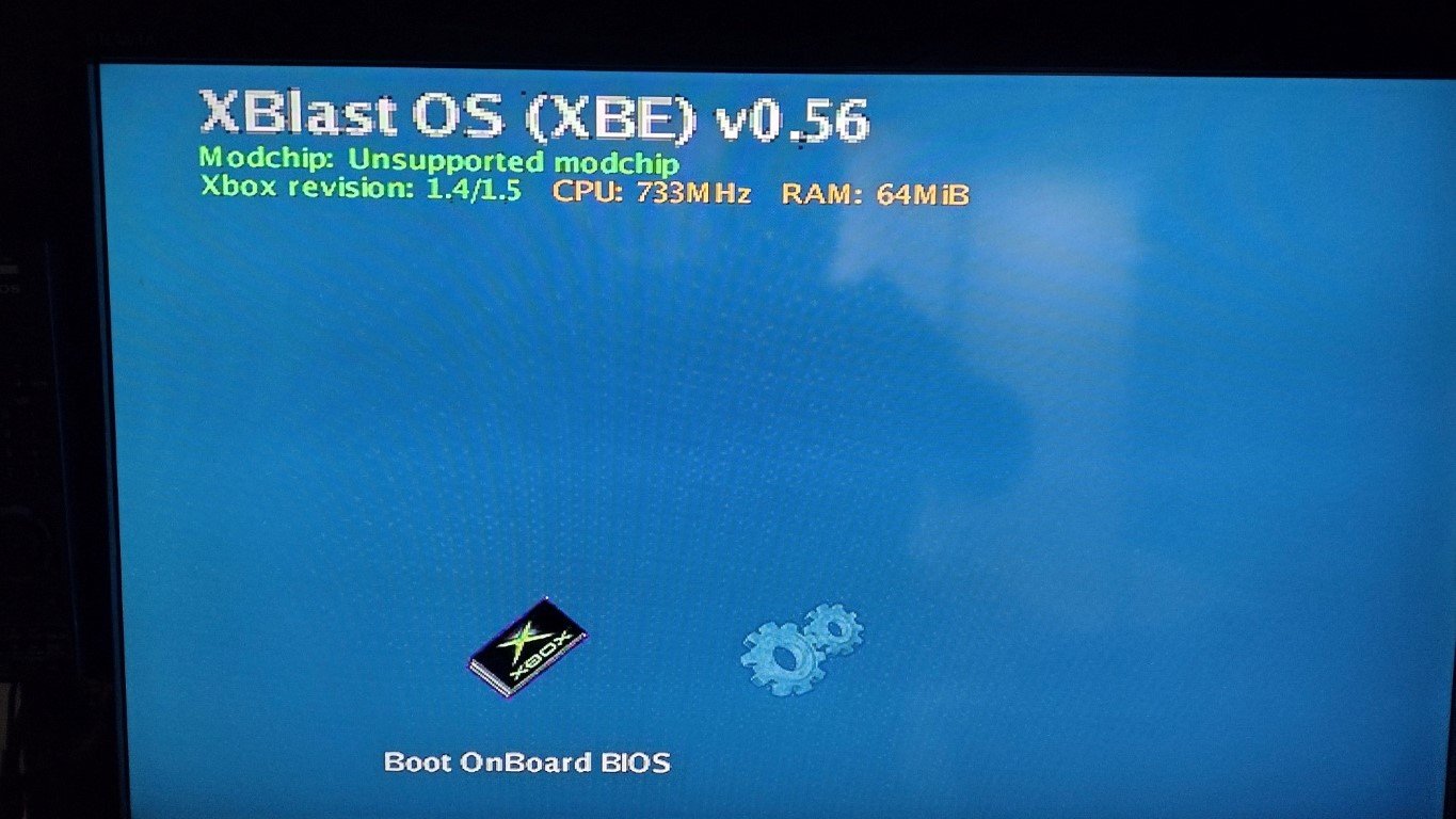

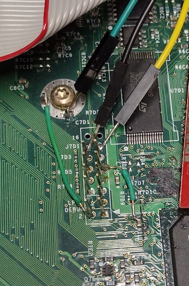

mrfishbsme Posted May 14 Report Share Posted May 14 Can anyone else confirm this?? I have repaired several 1.4 consoles, but this one is not a 1.4. This console was modded previously according to the v1.5 aladdin mod. It has bios 5713. Yet it comes up as a 1.4. Only Xblast OS shows it as 1.4/1.5. Quote Link to comment Share on other sites More sharing options...

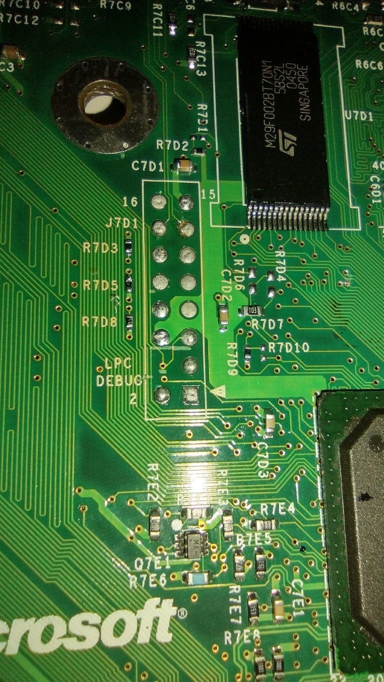

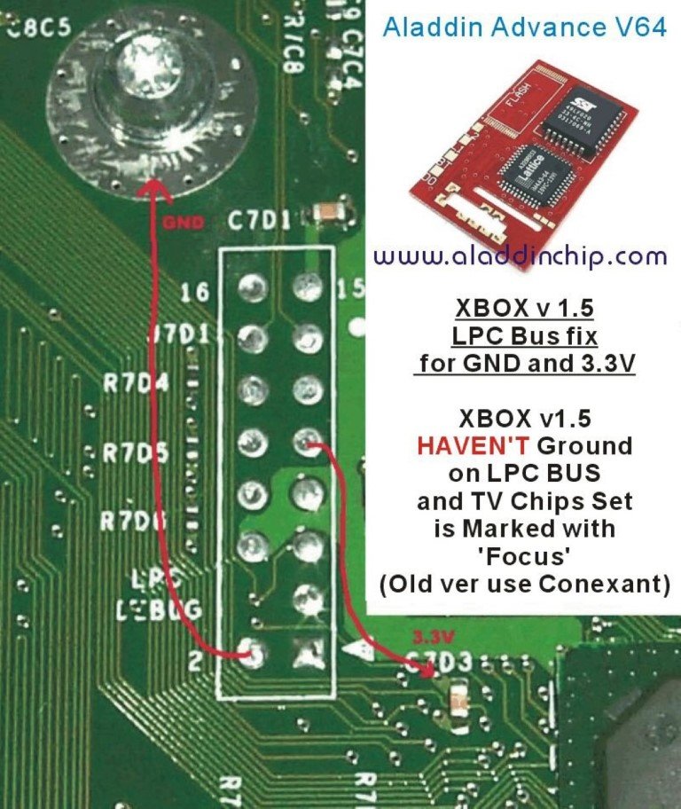

SS_Dave Posted May 14 Report Share Posted May 14 Have you removed the link from pin2 and ground and tested pin 2 for a short to ground and tested pin 9 for 3.3 volt.. Would you like a copy of that ultra rare bios file that was extracted from a Australian Halo Xbox dated 2003 Cheers SS Dave Soft modding is like masturbating, It gets the job done but it's nothing like the real thing. Quote Link to comment Share on other sites More sharing options...
Bowlsnapper Posted May 14 Report Share Posted May 14 5 hours ago, mrfishbsme said: Can anyone else confirm this?? I have repaired several 1.4 consoles, but this one is not a 1.4. This console was modded previously according to the v1.5 aladdin mod. It has bios 5713. Yet it comes up as a 1.4. Only Xblast OS shows it as 1.4/1.5. Modchip: Unsupported. See? Even XBlast knows the Aladdin sucks. Quote Link to comment Share on other sites More sharing options...
KaosEngineer Posted May 14 Report Share Posted May 14 6 hours ago, mrfishbsme said: Can anyone else confirm this?? I have repaired several 1.4 consoles, but this one is not a 1.4. This console was modded previously according to the v1.5 aladdin mod. It has bios 5713. Yet it comes up as a 1.4. Only Xblast OS shows it as 1.4/1.5. There is no such thing as a v1.5 motherboard. User error measuring signals present on the LPC Debug port. 1 Quote Link to comment Share on other sites More sharing options...

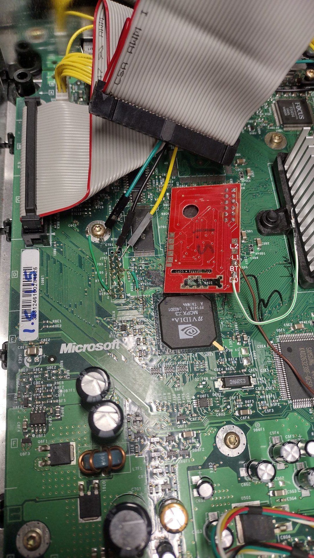

mrfishbsme Posted May 14 Author Report Share Posted May 14 The picture with the green wires is of the motherboard. and somebody took the time to run ground and a 3.3v wire. So if its missing ground and 3.3v, its a unofficial V1.5 that shows up as a V1.4 ...... ???? But there are no V1.5 because no chips were burned as V1.5. sorry, my AI logic just crashed. Can't handle information loop..... :( Quote Link to comment Share on other sites More sharing options...
nikeymikey Posted May 14 Report Share Posted May 14 Like SS Dave says remove the wires and check the pins for ground and 3.3 yourself, that will confirm that its a 1.4 1 Quote Link to comment Share on other sites More sharing options...
SS_Dave Posted May 14 Report Share Posted May 14 6 hours ago, mrfishbsme said: The picture with the green wires is of the motherboard. and somebody took the time to run ground and a 3.3v wire. So if its missing ground and 3.3v, its a unofficial V1.5 that shows up as a V1.4 ...... ???? But there are no V1.5 because no chips were burned as V1.5. sorry, my AI logic just crashed. Can't handle information loop..... :( I suspect the board has or had a gold coloured clock cap and the installer assumed it was a 1.5 and added the 2 extra links be cause they didn't bother testing it 1st. I also don't understand why write 1.5 on the board and chip as the Aladdin comes with a bios that is compatible with all versions of OG Xbox ( 1.0 - 1.6 ).. Cheers SS Dave Soft modding is like masturbating, It gets the job done but it's nothing like the real thing. 1 Quote Link to comment Share on other sites More sharing options...

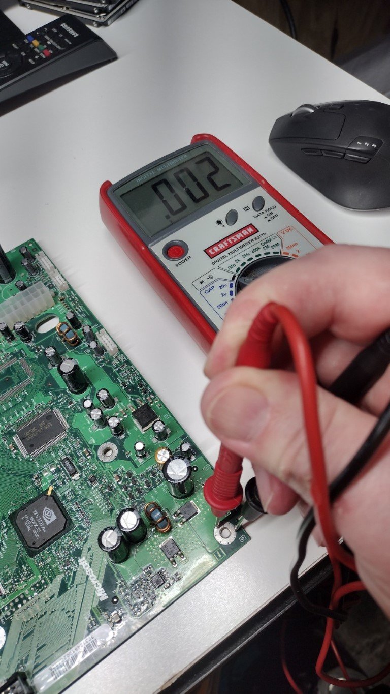

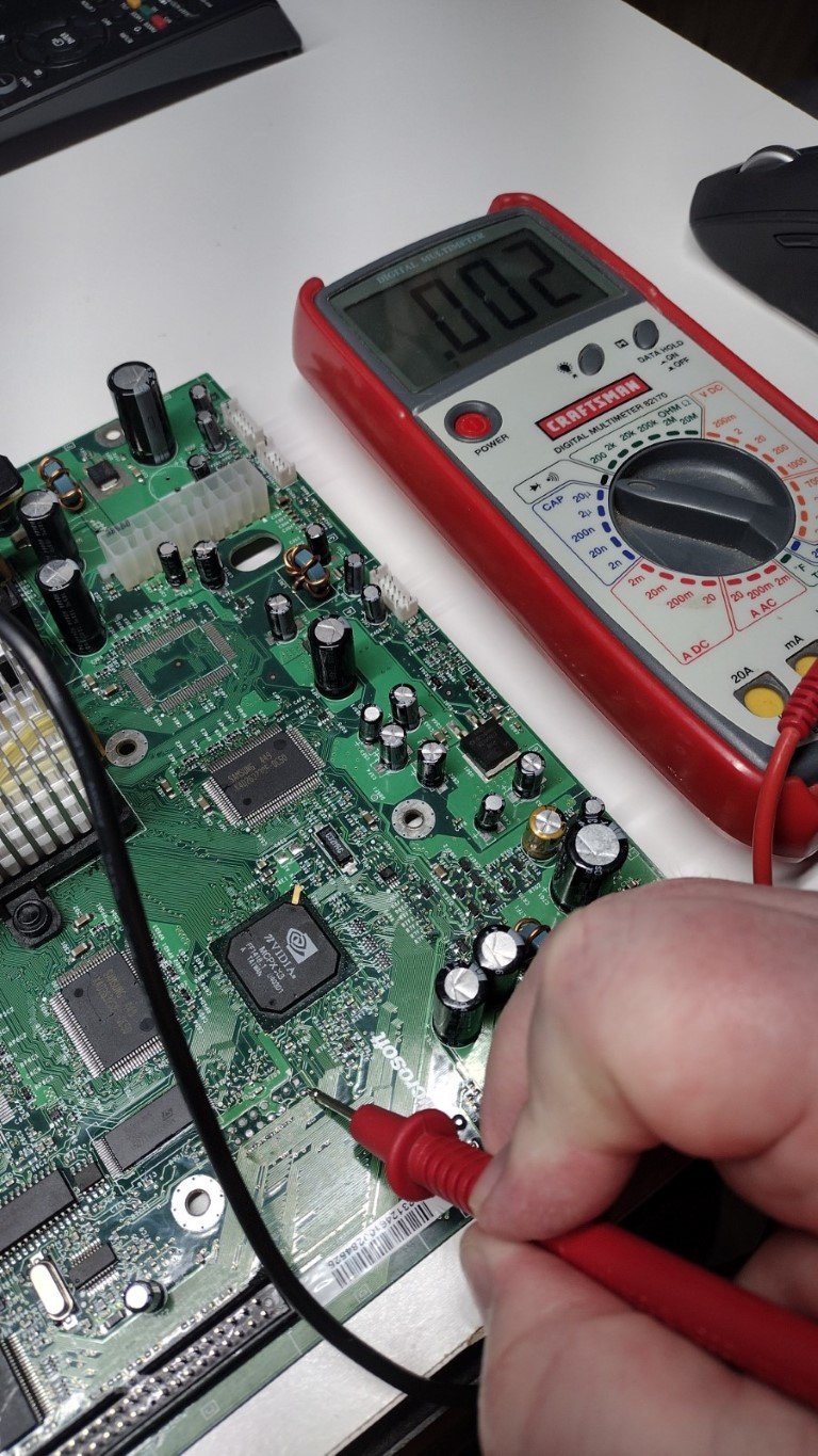

mrfishbsme Posted May 15 Author Report Share Posted May 15 you are correct, a gold clock cap. I will remove the soldered bits and grab a multimeter. Quote Link to comment Share on other sites More sharing options...

Bowlsnapper Posted May 16 Report Share Posted May 16 (edited) 10 minutes ago, mrfishbsme said: you are correct, a gold clock cap. I will remove the soldered bits and grab a multimeter. Am I trippin, or is that chip's D0 wired to the heatsink? Edited May 16 by Bowlsnapper Quote Link to comment Share on other sites More sharing options...
mrfishbsme Posted May 16 Author Report Share Posted May 16 no.... previous soldering job was crap. cold solder joints. wires broke off. 1 Quote Link to comment Share on other sites More sharing options...
mrfishbsme Posted May 16 Author Report Share Posted May 16 Survey Says.... V1.4 w/ bios 5713 and a gold cap This board is cursed, it did not want to be unmodded. Quote Link to comment Share on other sites More sharing options...
SS_Dave Posted May 16 Report Share Posted May 16 So it's a 1.4 then there has been posts on here and on Reddit with people swearing they have modded heaps of 1.5's but when asked to prove it like you just did they never return. In the 1st YouTube clip I watched the person was showing how to test for a 1.5 he then his meter set to ohm's and then had one probe on the screw hole and the other on pin 1 (LCLK) and saying this proves it a 1.5.. It also made no sense to write 1.5 on the chip and the MB.. As you now have the HDD soft-modded why not add the links to R7D10 and R7D1 then re-flash the onboard bios with cerbios. Cheers SS Dave Soft modding is like masturbating, It gets the job done but it's nothing like the real thing. Quote Link to comment Share on other sites More sharing options...
