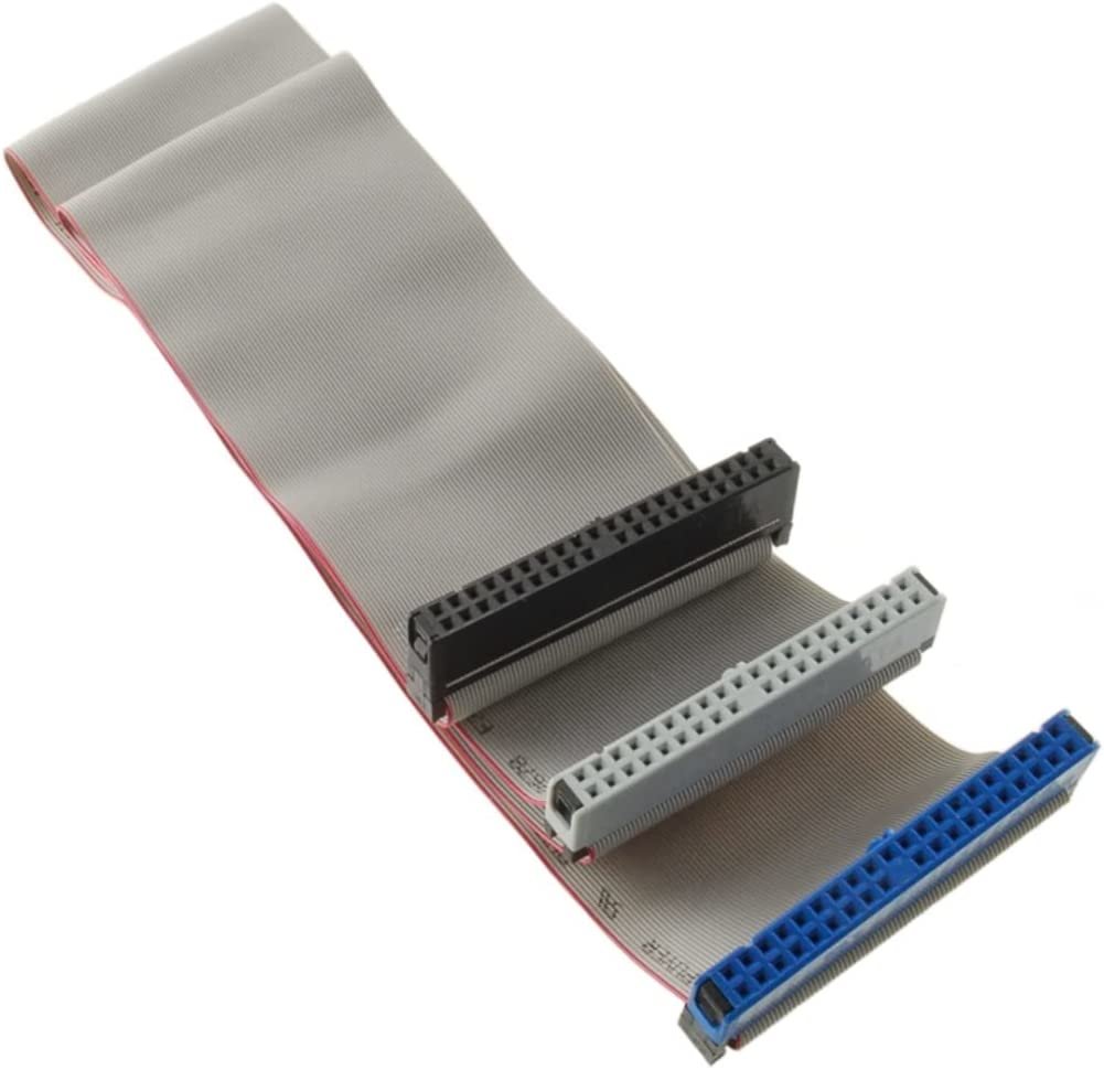

KaosEngineer Posted January 26 Report Share Posted January 26 On 1/24/2023 at 1:00 AM, nbaj said: That worked, but now I get Error 13, can't boot dashboard due to missing key It's a 2tb xbox origins via backups Are you using the stock IDE cable with the new 2TB hard drive? If so, swap it out for a high-speed 80-wire 40-pin one. Quote Link to comment Share on other sites More sharing options...
nbaj Posted January 26 Author Report Share Posted January 26 4 hours ago, SS_Dave said: Did you put the cerbios.ini file on c drive ? I just tried to boot my 2tb Origins HDD using Cerbios 2.2.0 without the config file on C drive and it wouldn't boot Cheers SS Dave Soft modding is like masturbating, It gets the job done but it's nothing like the real thing. Origins is an image. I was under the impression that i would use HDD raw copy to copy the image to a 2tb hdd How would i access the C drive? fatxplorer can't open the hdd Quote Link to comment Share on other sites More sharing options...
nbaj Posted January 26 Author Report Share Posted January 26 3 hours ago, KaosEngineer said: Are you using the stock IDE cable with the new 2TB hard drive? If so, swap it out for a high-speed 80-wire 40-pin one. No, i have a brand new 80 wire Quote Link to comment Share on other sites More sharing options...

KaosEngineer Posted January 26 Report Share Posted January 26 10 hours ago, nbaj said: No, i have a brand new 80 wire Does the original hard drive work with it? Did you already mention if it did or not? What color is the insulation on the ribbon cable? Quote Link to comment Share on other sites More sharing options...
nbaj Posted January 27 Author Report Share Posted January 27 20 hours ago, SS_Dave said: HDD raw should have formatted the new HDD into Fatx so the Xbox could use that drive as the ISO file is an image of the complete working Xbox drive. From memory I selected the ISO image then selected the source hard drive and then let it do it's thing and it took about 18 hours on my old Dell desktop. I would use any PC partition program and remove all the partitions and then do a quick format of the 2tb HDD before trying the ISO file again, The origins Image does work so it sounds like something went amiss when you where extracting the IMG file Your other option is to use a install disk and make your own HDD from scratch but you will have to find all the games and apps to copy to the new HDD. What size is the ISO image file? Cheers SS Dave Soft modding is like masturbating, It gets the job done but it's nothing like the real thing. Mine is not an ISO, via backups Quote Link to comment Share on other sites More sharing options...
nbaj Posted January 27 Author Report Share Posted January 27 16 hours ago, KaosEngineer said: Does the original hard drive work with it? Did you already mention if it did or not? What color is the insulation on the ribbon cable? I tossed the old hdd This is the ribbon i use 24" 40-Pin 80-Wire Ultra ATA 2-Drive Ribbon Cable, Manhattan 332781 Quote Link to comment Share on other sites More sharing options...
