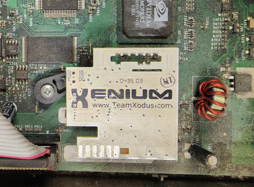

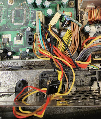

Exactly what I did last night. Working great. I pulled out my 2nd OG so I can clean it up and update it. This one has a Xenium chip and a module (anyone remember the name?) that allows the console to be powered on/off via the DVD remote.
There were a few such IR on/off mods.
XIR was one.
XERC2
and
Team Xecuter made an add-on board to do so too.
