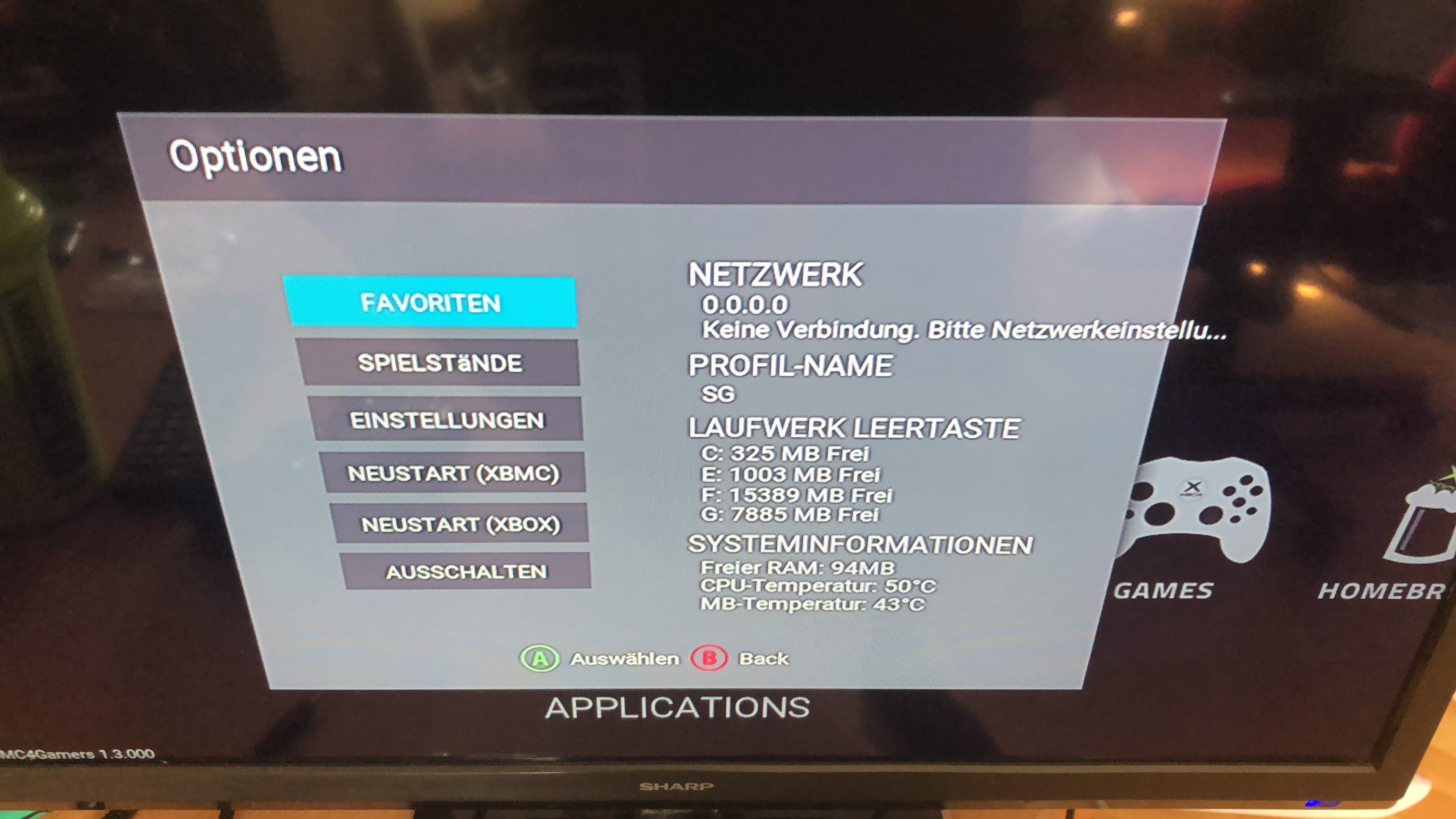

Onaga Posted May 17 Report Share Posted May 17 (edited) First time I got no IP on an Xbox Classic! Add new Caps, 128MB RAM upgrade and it works totally fine. I use XBMC4GAMERS, iND Bios, just same setup as always..., Network is set to DHCP. Can't get an IP! Tried two different ethernet ports (ICS 1893AF)... still no IP... Any solutions, please?? Edit: -Tried new ethernet connector as well, didn't help... - FTP connecton works!! Edited May 17 by Onaga Quote Link to comment Share on other sites More sharing options...

KaosEngineer Posted May 18 Report Share Posted May 18 When did you have an IP address? Which replacement dashboard showed that one had been assigned? In the photo you posted, it shows no IP address has been assigned,0.0.0.0. Where did you see the IP address of 192.168.0.6?  You mentioned replacing the ICS 1893AF chip on the motherboard. You unsoldered the old chip and reinstalled a new one? Quote Link to comment Share on other sites More sharing options...
Onaga Posted May 18 Author Report Share Posted May 18 For FTP connection I use a "Allnet ALL1294A Broadband IP-Router" between XBox and PC (Old PC with XP on it). This is where I get the IP 192.168.0.6. I do it all the time. For "Internet/XLink Kai/ XBMC Cloud" I hook up directly to my modem (as I do with all other XBox after TSOP ect.) This is where I get 0.0.0.0. Yes, I replaced ICS 1893AF two times on the motherboard (desolder and reinstall new one). I did same for the "Ethernet connector". Didn't help. Setup on HDD seems to be fine as well... because it works in every other Xbox I own.  Quote Link to comment Share on other sites More sharing options...
KaosEngineer Posted May 18 Report Share Posted May 18 2 hours ago, Onaga said: For FTP connection I use a "Allnet ALL1294A Broadband IP-Router" between XBox and PC (Old PC with XP on it). This is where I get the IP 192.168.0.6. I do it all the time. For "Internet/XLink Kai/ XBMC Cloud" I hook up directly to my modem (as I do with all other XBox after TSOP ect.) This is where I get 0.0.0.0. Yes, I replaced ICS 1893AF two times on the motherboard (desolder and reinstall new one). I did same for the "Ethernet connector". Didn't help. Setup on HDD seems to be fine as well... because it works in every other Xbox I own.  Why are you using a different network configuration for FTP and Internet? What type of Ethernet port is on the modem - 1 Gbps? I don't think the Xbox can establish a link to a 1Gbps Ethernet port. Quote Link to comment Share on other sites More sharing options...
