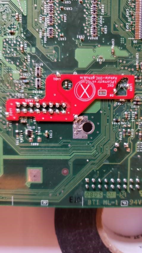

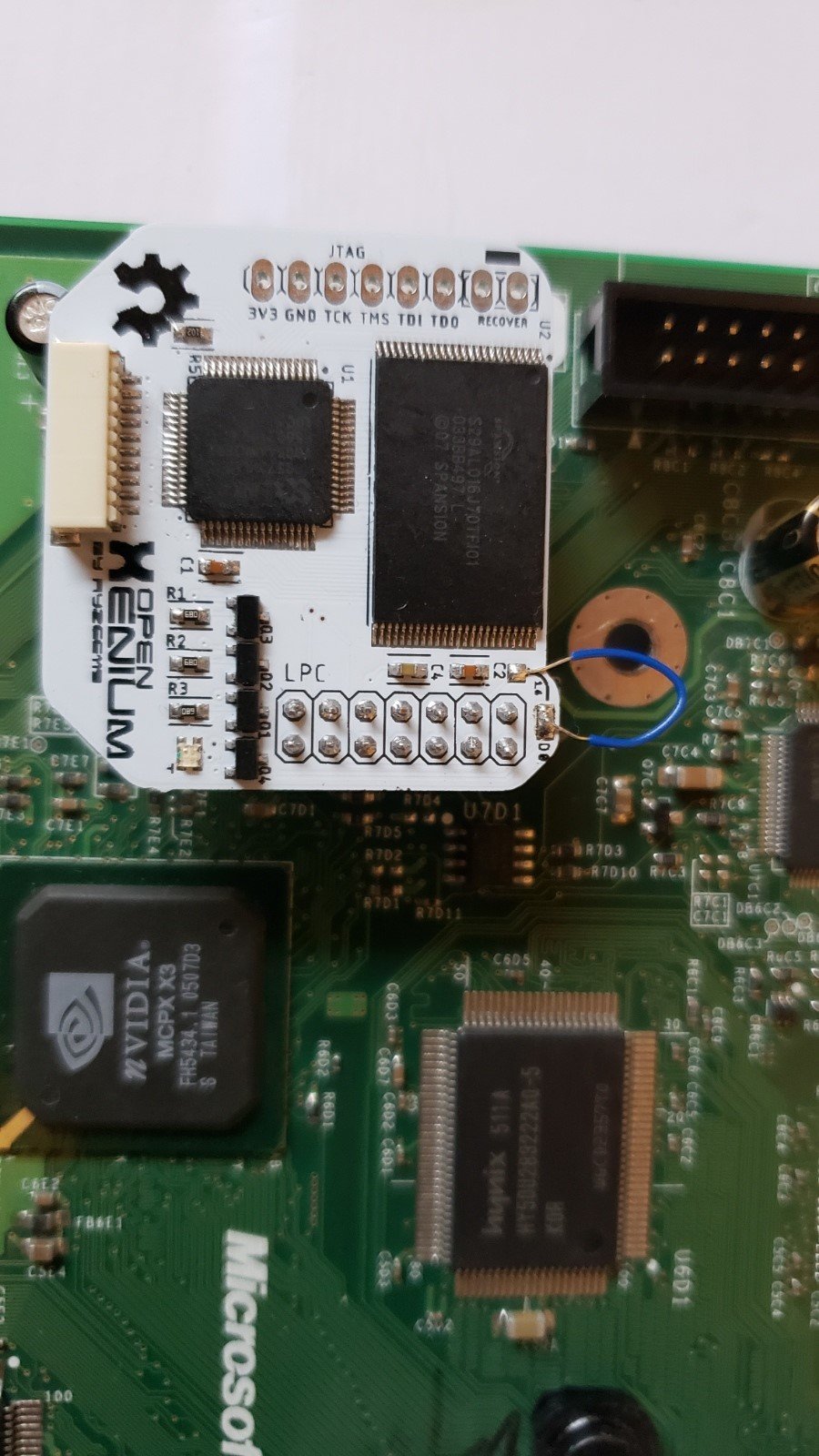

Hey guys,
Wondering if someone might be able to help me with this.  Recently installed OpenXenium on my 1.6 with LPC board (pics attached).  Xbox turning on just fine but getting a black screen when video cables connected.  Tried both component and standard composite.  The Xbox led is green as per usual.  The chip led itself actually flashes so I know its getting power BUT after it flashes a few colors the chip LED turns off and I'm left with a black screen on the tv.
When i remove my video cables from the xbox  and only have the power plugged into the Xbox the chip LED stays on, flashing every few seconds between red and yellow.
Xbox boots fine to dash with chip unplugged.
The machine is soft modded.  Could that be causing an issue getting to the Xenium OS screen?
Losing hope on this. Thoughts?

Soft modes and hard mods (Modchips/ Bios reflash) don't play nice with each other and you will get a black screen and it could also be tiring to load a bios file that's not suitable for the 1.6
If you power on the Xbox with the Eject button you should get the Open Xenium menu but it will be a washed out pic with lines though it if not then there is a problem with the Open Xenium fitting.
Also try booting the Xbox with the HDD disconnected.
You should be able to cold boot (Load the DVD in the DVD drive and power off then on ) a install disk like the OGXbox installer V1.5.3 disk and use the repair hard drive option to remove the soft mod.

I was actually able to get to the Xenium dash after I plugged the dvd drive in which to me is odd -  I was under the impression it should load the Xenium dash without.

I have seen some take quite  while to load when there in no DVD drive.
