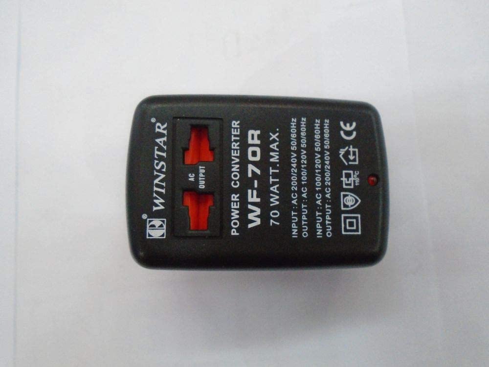

i found out why my xbox not work correctly as i said to u before my xbox is 100-145 watt my country uses 200.240 watt so if i want to turn on my xbox i mast use power convector so i used winstar power converter and my xbox wasn't run perfectly so i used set up and down transformer so my xbox run so smoothly i even took out the hard drive and i turned on the xbox it worked good so  and even with the hard drive it works good so should i remove these capacitor

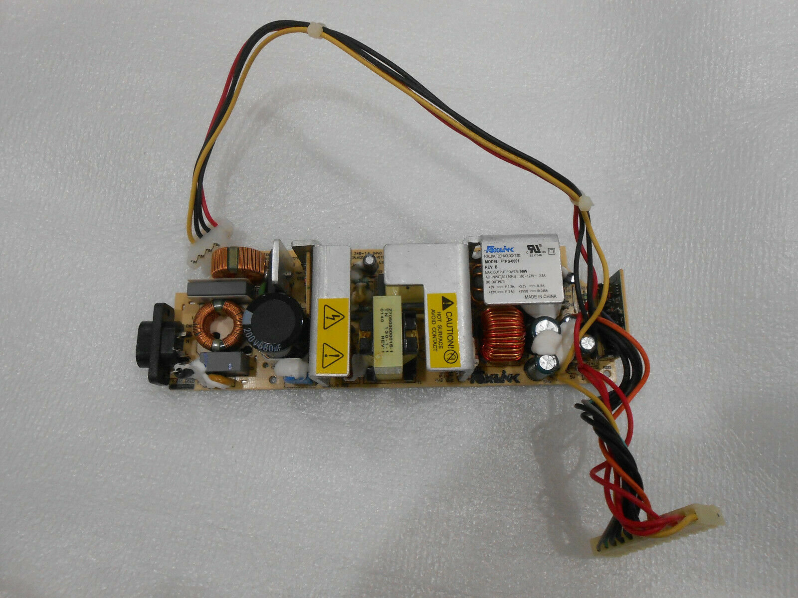

Can you post a pic of the power supply that is in the 1.0.
2 hours ago, SS_Dave said:
Yes you still need to change the capacitors next to the heat sink and remove the clock cap from the version 1.0.
that is the power supply
