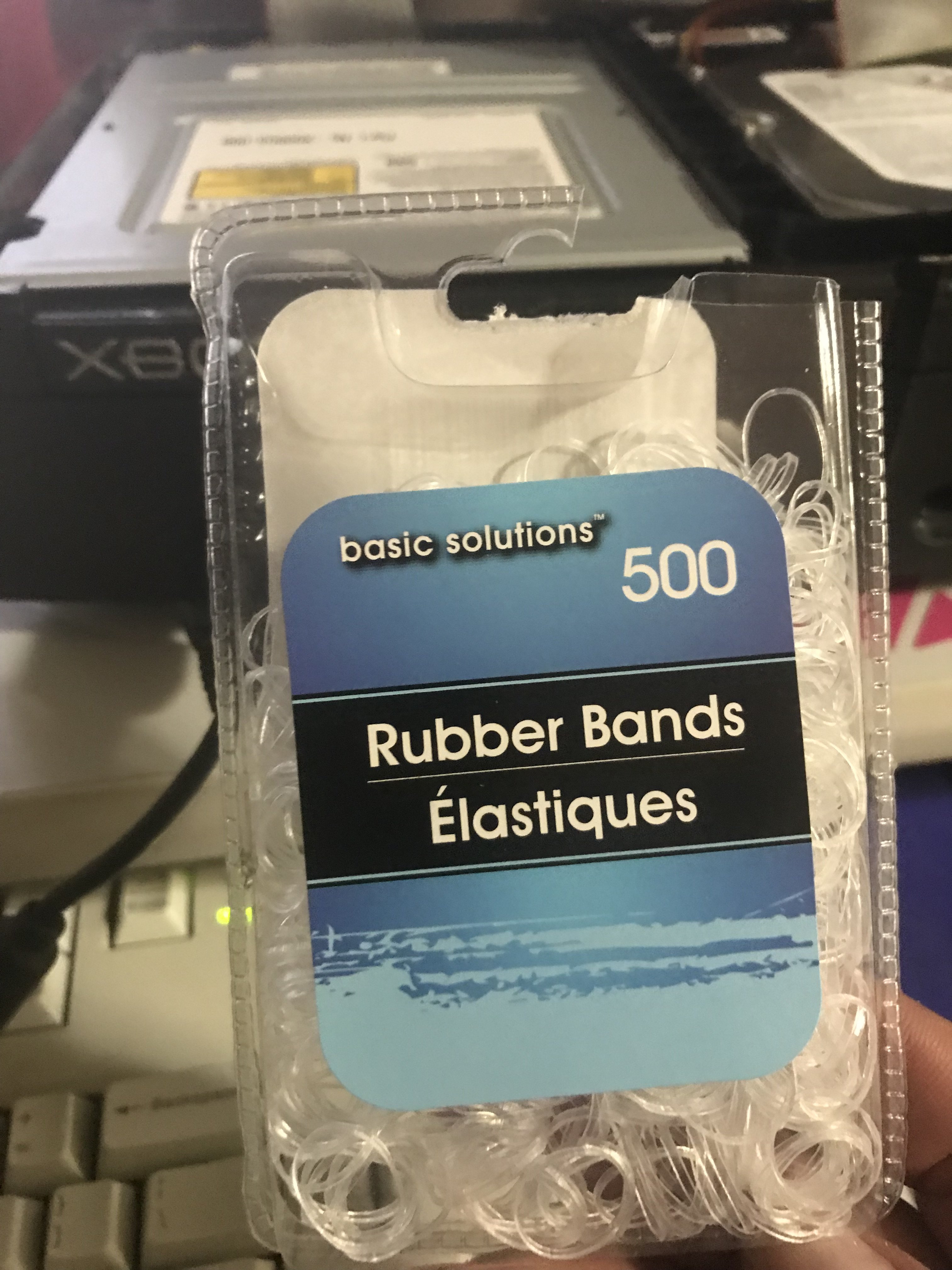

IAmADrunkGuy Posted June 16, 2018 Report Share Posted June 16, 2018 (edited) I was in the same boat looking for belts but didn't have time to wait, I didn't want to LOL. I went to dollar tree and bought the little rubber bands for girls hair. They seemed small but I figured I'd try and it worked LOL, They seem pretty thin so I put three on there and it works great. Probably wont last long but for $1 for 500 I cant complain!!!! Edited June 16, 2018 by IAmADrunkGuy grammar 4 Quote Link to comment Share on other sites More sharing options...
XboxMon Posted June 16, 2018 Author Report Share Posted June 16, 2018 Haha. Now that is the very epitome of "on the cheap" brother *brofist* 3 Quote Link to comment Share on other sites More sharing options...
