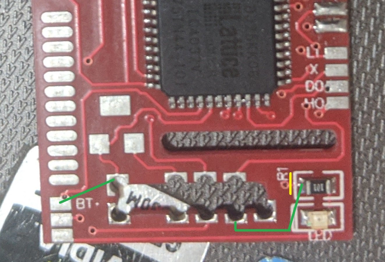

Don't worry about the L1 wire and I link the BT on the mod chip to ground and not to the front panel.
This forces the chip to be always active, The only reason the turn the chip off was for Xbox Live.

Yes the BT link on the mod chip and you can link the D0 on the main board to ground.
IMG_20200404_103218.jpg.e98d9f1a9035534dc245b75ad3bdff2f.thumb.jpg.77714f911f2b39fac85ab8ff173e371a.jpg The green line on the left is linking the BT to ground
1420258271_Btpoints.PNG.07730d9790beb1a79550690c51242720.PNG Use the lower left image.
