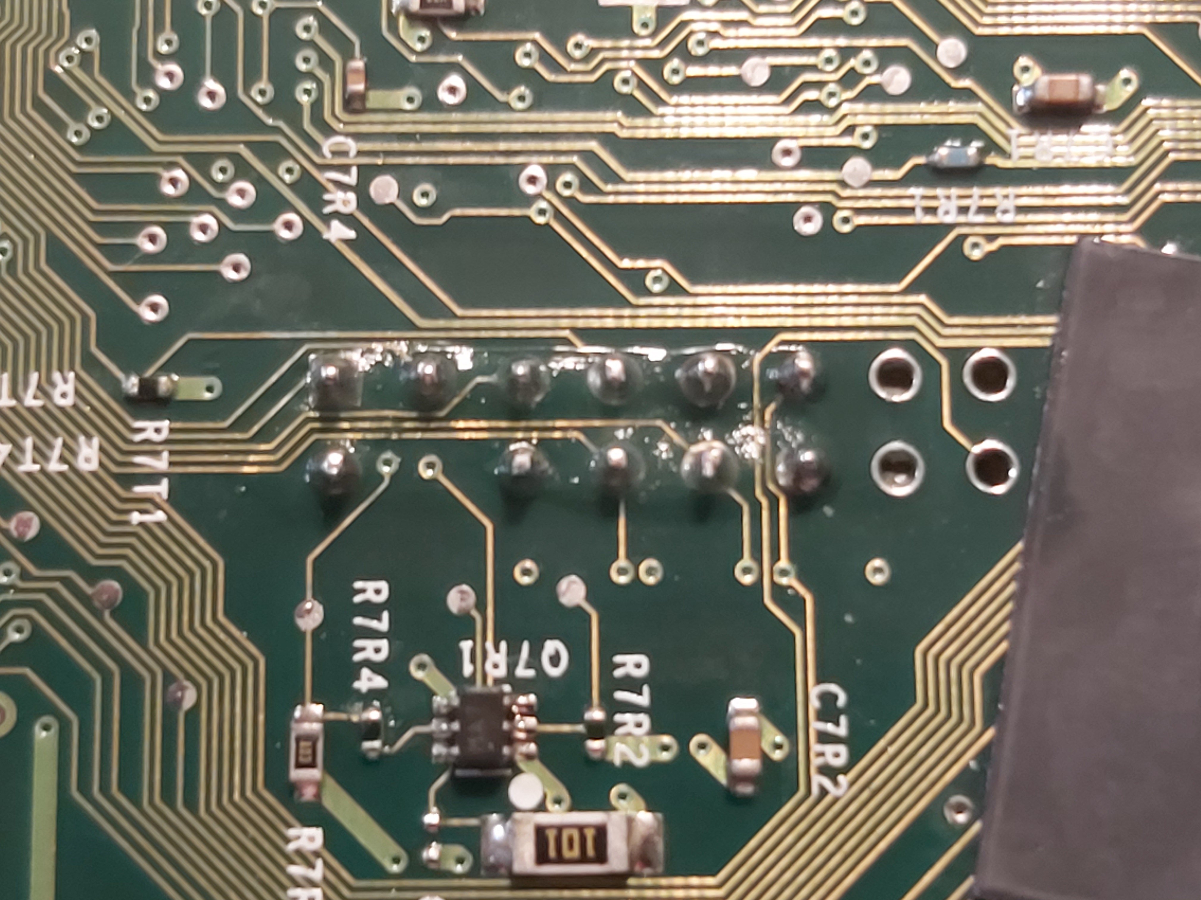

It would help if you posted some pics of the board and pin header install solder work.

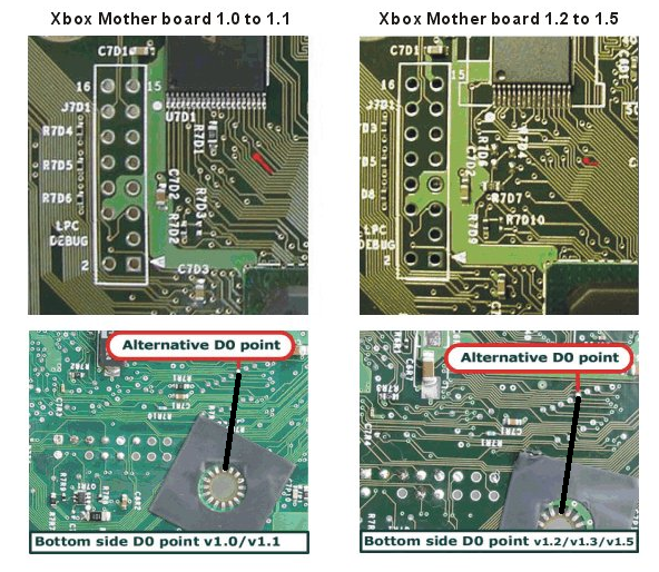

My preference is the alternative D0 point and just link to ground

Do I go from the DO on the chip to the ground on the motherboard? Or is there another DO?
You link the D0 from the main board to ground on the mainboard.
If you have also lined the BT to pin2 then there will be no wire from the mod chip to the board.
Check you have the chip aligned correctly on the pin header and that is oriented correctly.
3 minutes ago, mattison1986 said:
I feel like my issue is with the DO wire can someone please explain this?
The job of the D0 is to tell the Xbox to load from the LPC port, If you use the pic I posted you should be good to go.

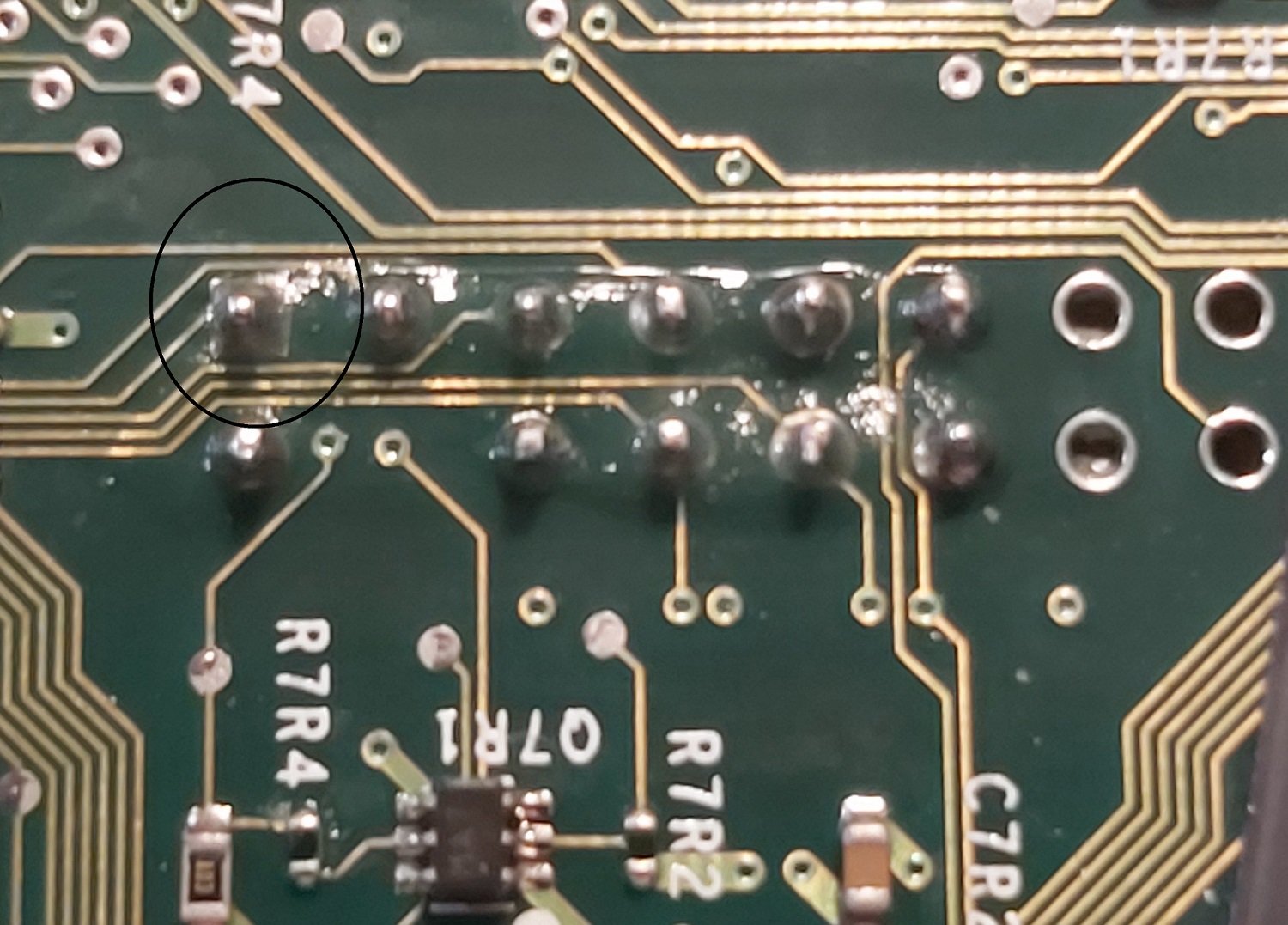

That will help as the problem could be as simple as a bad solder joint or a solder bridge between to pins.
Also have a good look over the entire board for a solder splash (solder that's fallen off your iron on)
Ok I would suggest you try cleaning the board where you worked with Isopoyonal and a toothbrush or you can use methylated spirits.
It's probably just flux but it looks a bit suspect

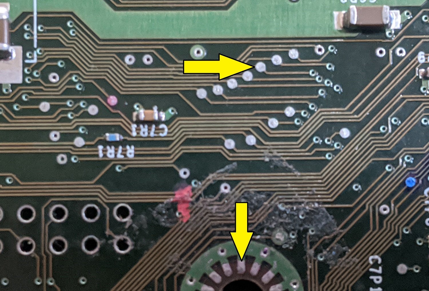

On the 1.2 -1.4 board you have the D0 is in this pic and just link the yellow arrows.
that pad's not much smaller than the LPC pin header connections.  The top side D0 point via is much smaller about 1/4 the size of that testbed pad.
You need a small piece of 26-30 AWG wirewrap wire. Wirewrap wire is a single strand of insulated wire.

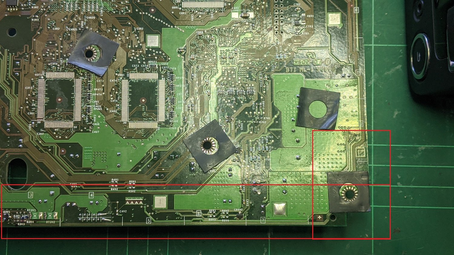

Trace rot - power signal trace damaged that leads from the front panel connector to the System Management Controller.  Phantom power on / off can occur.  The 4 thin traces are on the front edge on the bottom side of the motherboard.
Power/Eject Troubleshooting
See: Please login or register to see this link.
I replaced the front panel board for one I knew worked and same results. I also looked at the motherboard and the traces look good. Over all this is one of the cleanest I've picked up inside and out. Anyone know what the shut down might be about? It does power on soon as the console is plugged in without pressing the power button and after a few minutes it shuts down. Please help.
That really sounds like trace damage especially since you say it powers on by itself.
8 minutes ago, mattison1986 said:
Is there anything I can do about that?
It would help if you can take a high quality picture of the board and the location in red are the main trouble spot and include a photo of the top side as well.
If you upload to a free picture share site something like Please login or register to see this link. and post the link here.
Then we can have a look and see if there is anything that could be wrong.
