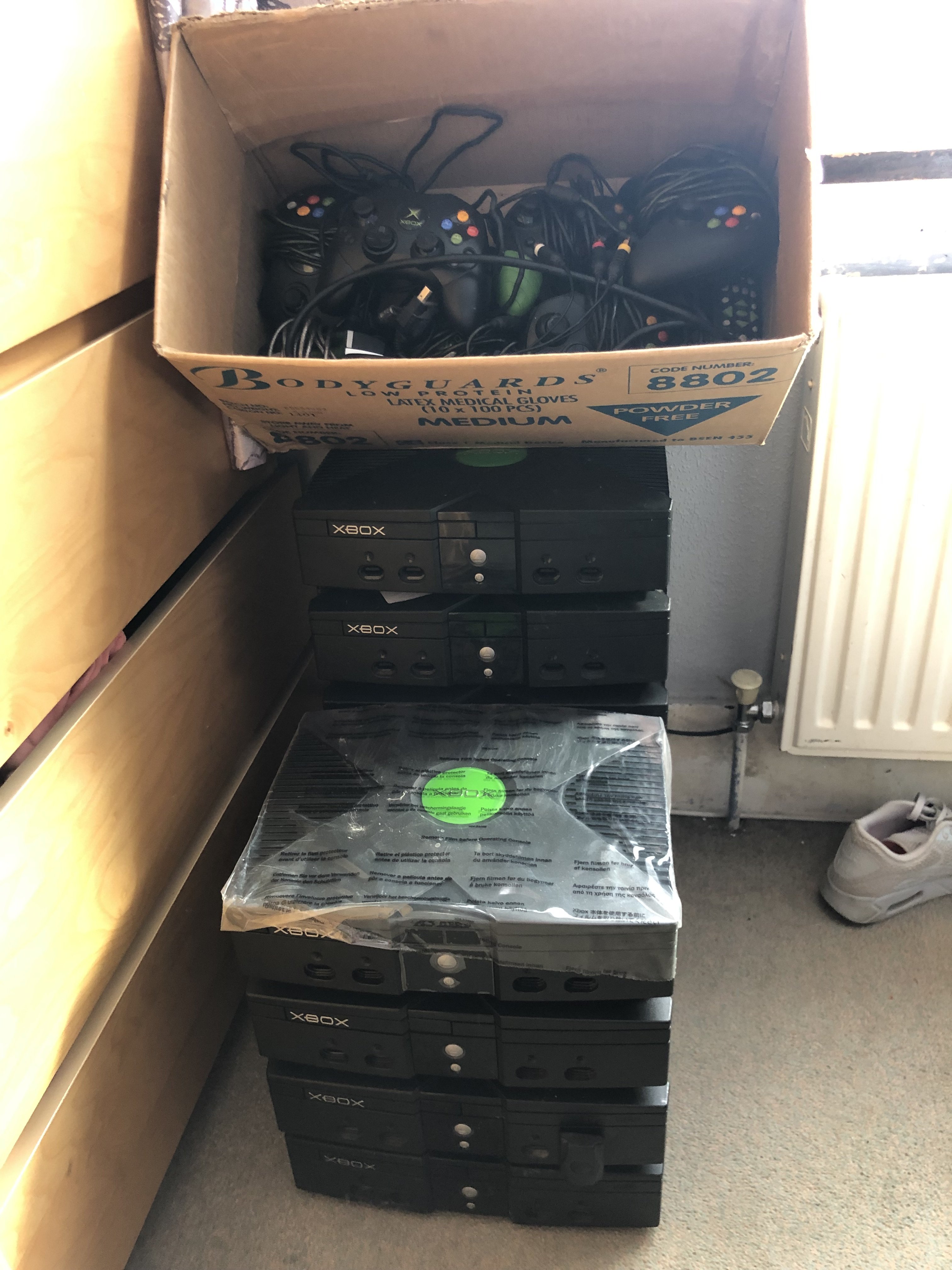

Just picked up the above this morning, 10 xbox's. And yes that top one still has the original MS polythene on it so im gonna say thats brand new and unused!!!
Gonna go through them all and clean them up before getting them modded and re-sold.  Will open each one up and read the eeprom and null the key as I have a bunch of hdds (ripped from Sky boxes) with nulled keys and Rockys softmod installer on them ready to go.
It looks as though none of them have ever been hardmodded as all but one have never been opened, I may come across some existing softmods tho i guess.
I have a good supplier for power cables, but will need to source some AV/Component cables along with some 80 wire ide cables. I already have a few sata2ide adapters sitting here but will probably need a couple more.
If anyone has any links to 80 wire ide cables that are long enough to do the job (i had some before that barely reached) then please let me know and also a good supplier of reliable av/component cables too :)
  • Like 3

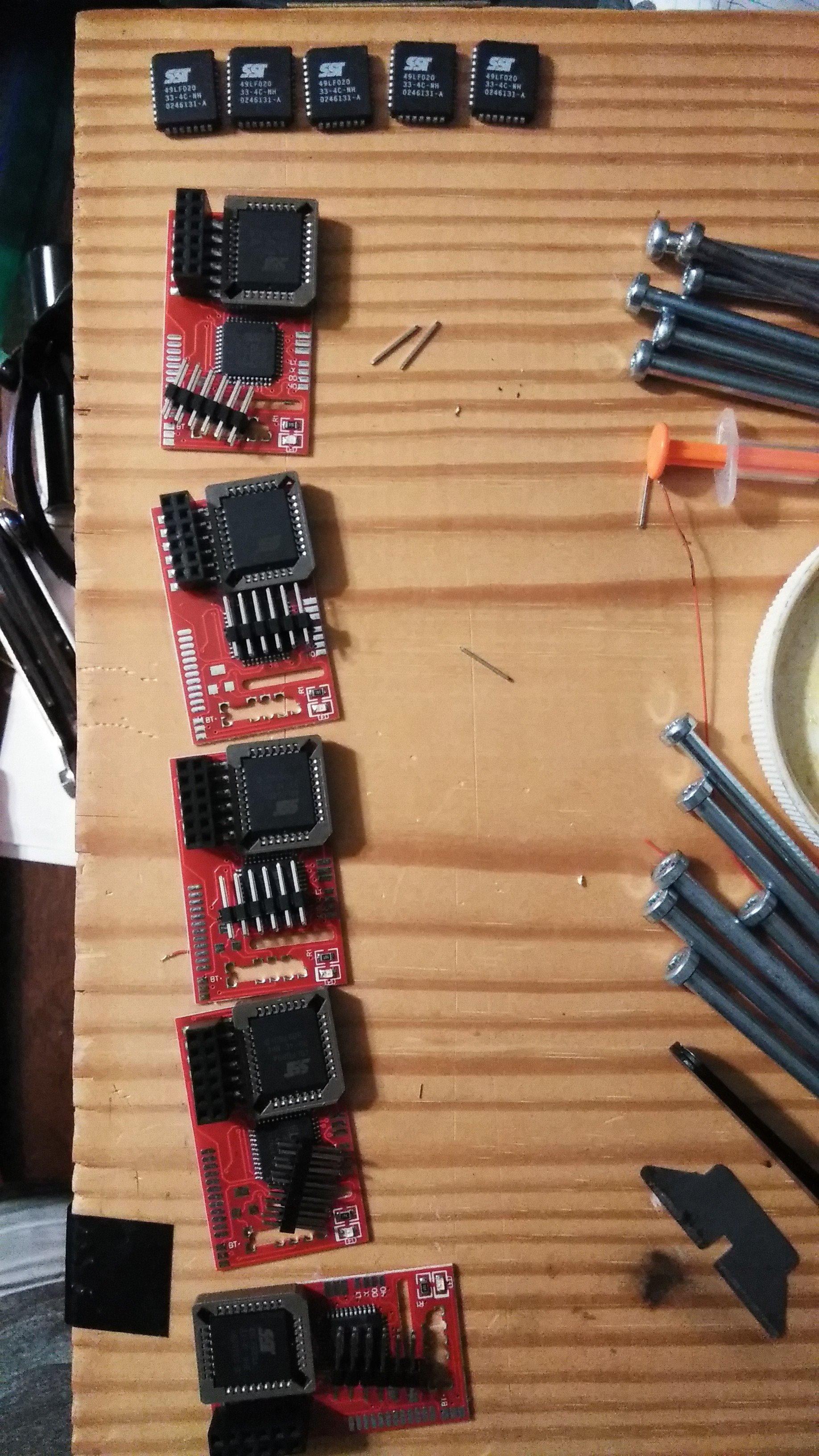

I May well do just that, I will probably do a mixture of TSOP and Aladdin chips for the rest. I already have a bunch of chips sitting here ready to go. Just got to wait for my shipment of IDE2Sata adapters to arrive from America :)

I have one with a bad tsop flash, and one with an error 21 :( got an aladdin xblast on order with @M0RPH10U5 to help fix the tsop and will fix the error 21 by dumping the eeprom with my rPi, nulling the key and writing the eeprom back, then i have a hdd ready to drop in.

1MB flash chips came in today while I was at work, Still waiting for UPS to drop the Aladdin chips off. After which I should have one ready for you.
Just now, M0RPH10U5 said:
You can if one of the banks is flashed with tsop_m7. I speak from experience. Though you have to ground d0 and a15 to do it, and you need something like hexen in the disc drive to boot to.
sure, but that's not anything special with the xblast aladdin, any modchip will work, and the timing when removing the grounds is very difficult to pull off
