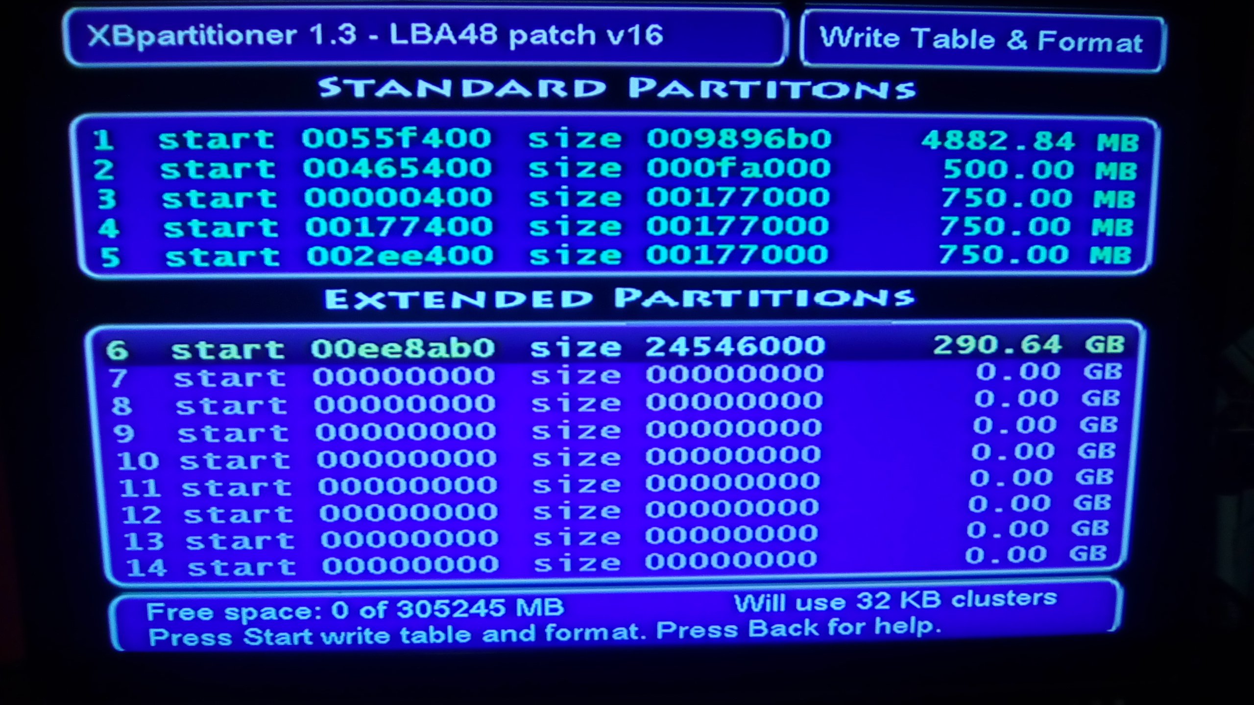

So after that i start filling the F drive with games emulators etc,but when the free space drops to 30-32GB,no more filles can be copied into that drive. Others drives can be filled to maximum,but this one cant. Tried that on 2 xboxes with same Bios and the same problem occurs,so i assume that its a bios problem
Can you take a photo of XBpartitioner 1.3 immediately after you launch the app?  Ensure that the focus is moved off the F drive so that we can fully see the what the F partition is indicating.
You have to have a partition table on the HDD and the BIOS must have LBA48 patch v3 installed.
The standard configuration for an LBA48 .67 BIOS is partition 6 (F) up to 137GB and partition 7 (G) takes the rest. Without using XBPartitioner v1.3 to write a partition table the the hard drive, a .67 BIOS will only have F of ~120.5GB's and G the remainder no matter how you have the drive setup.  The LBA48 patched, .67, BIOS has fixed values set for the drive/partition starting locations when no partition table present.  If the table is present, the BIOS overrides the fixed .67 configuration values with those values read from the partition table.
This is what i see. What i notice is that it says LBA48 patch v16 while in others i see it reads v3. What excactly is this?

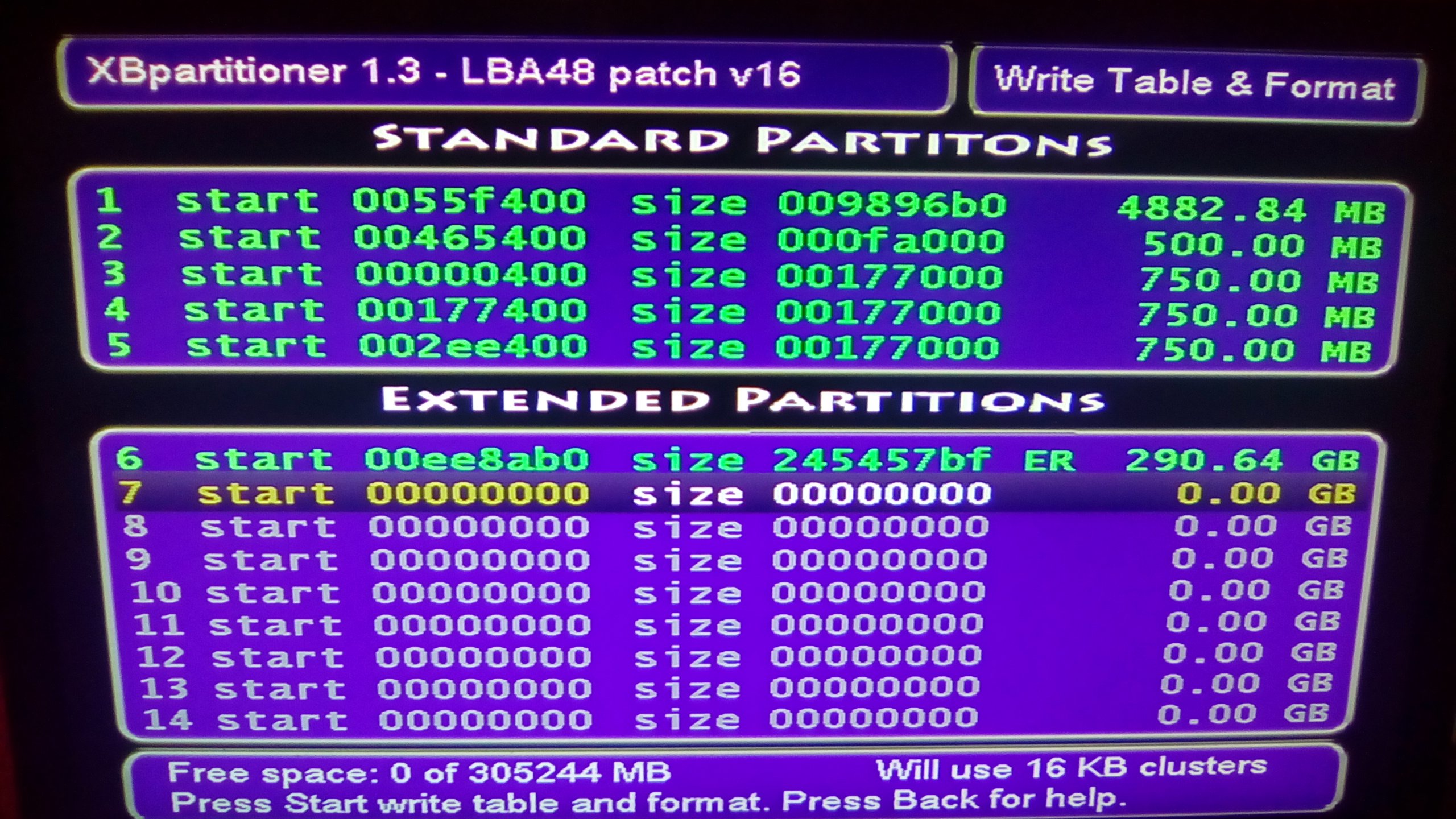

Move the focus off of the partition 6 (F) line and take another photo please.  The v16 might have something to do with rev 1.6 compatibility.
It is still the same. What is wrong here?
OK...  Now we can see the problem.  Go back up to that row.  Cycle A button until it reads the same details for that partition.  Press Start button.  Once complete, press White button until it says just Format at the top.  Press Start button.  Press White button until it says just Write Table.  Press Start button.  Then, press Back button to exit.  Reboot.  Go back into XBpartitioner 1.3 and keep doing this until it no longer says ER.
What does ER stands for?
Even if the xbpartitioner formats the F partition with ER clusters,wouldnt the AID format menu correct it?because after i made the partitions with xbpartitioner,i run auto installer deluxe 4.53,format the whole HDD within its format menu and finally started filling the HDD
