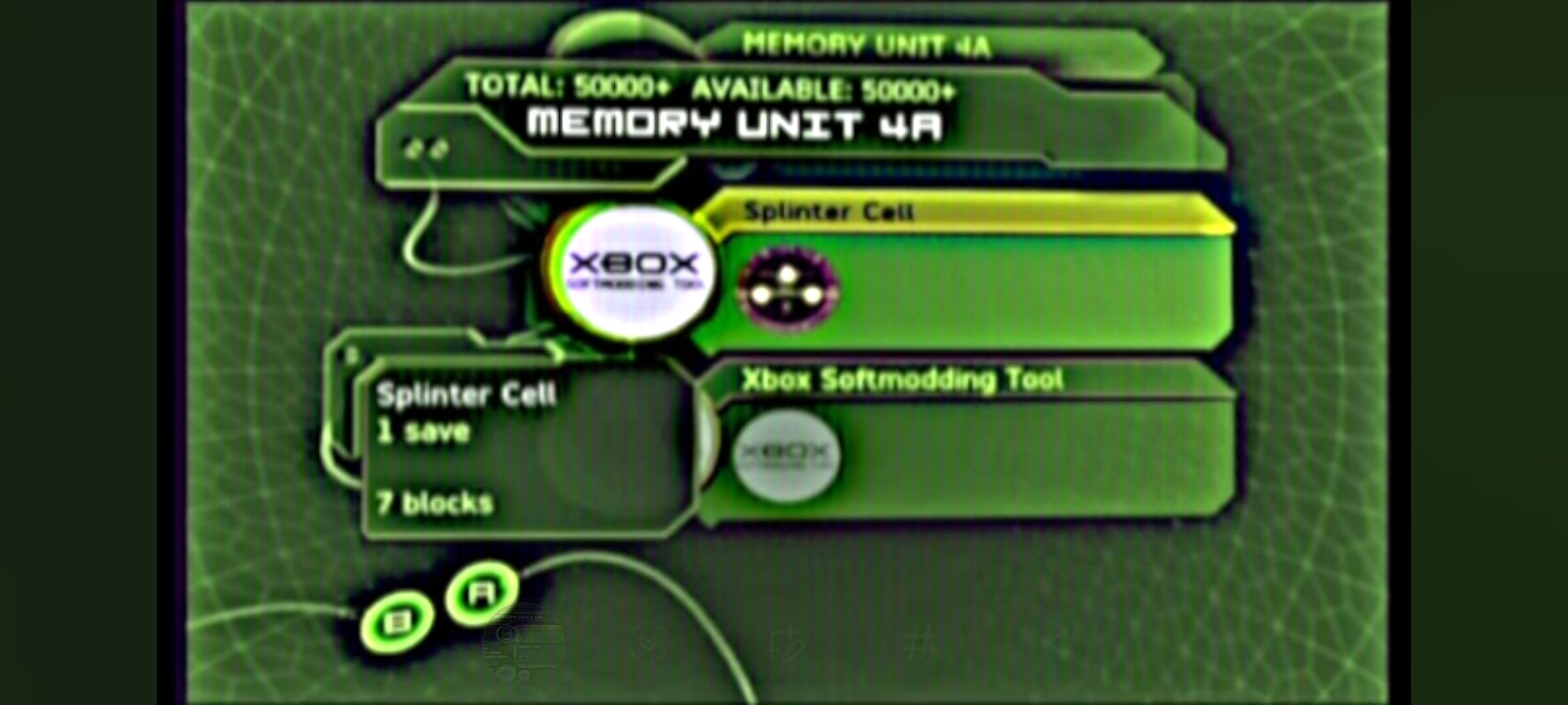

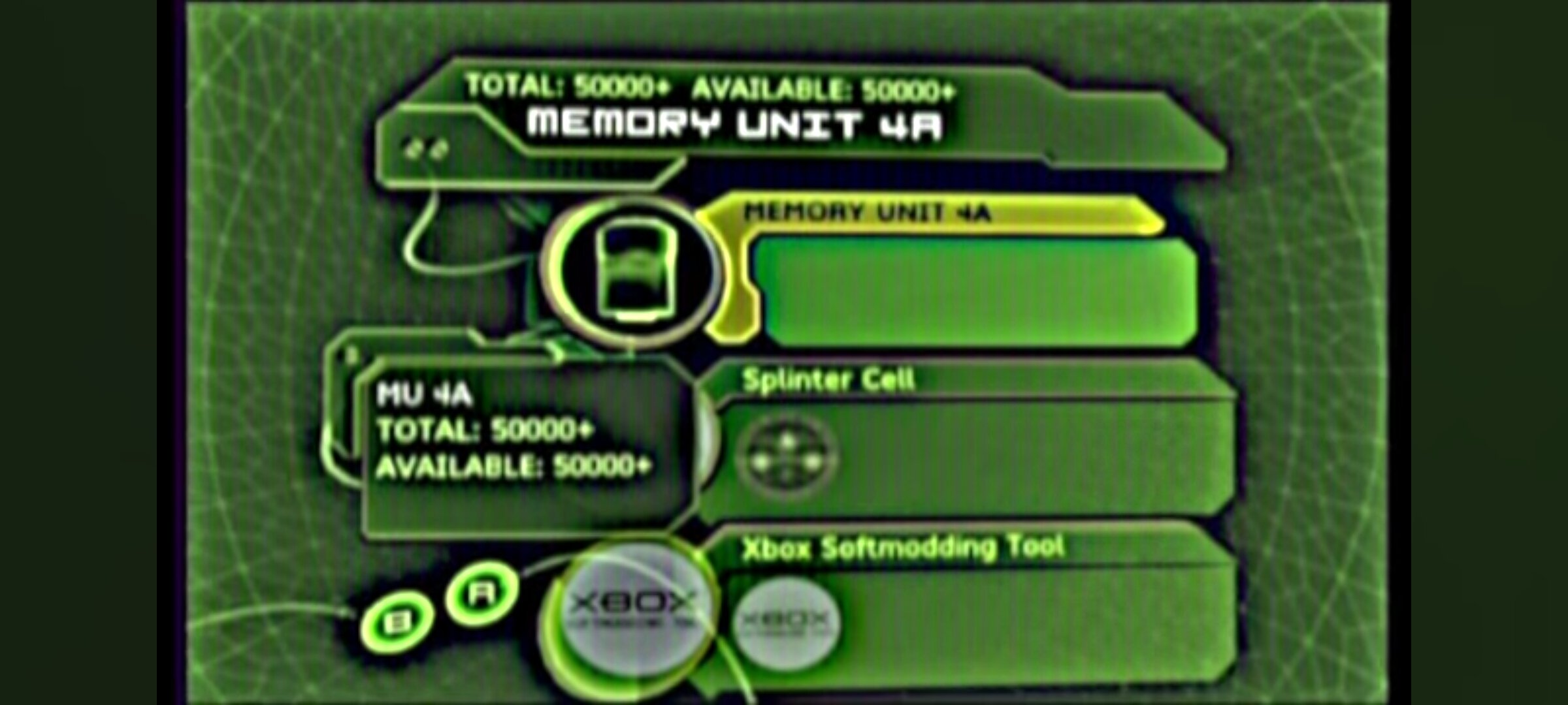

The 40 GB HDD is present. The xbox is now like a stock xbox with a slightly bigger HDD. Stock dashboard is present. Also some savegames from splintercell. 007 and mechassult. So i have no idea wich game was used for the exploit.
This afternoon i hope to receive a cope of splintercell and a usb adapter. I gathered some old usbdrives and hope that one wil work.....
