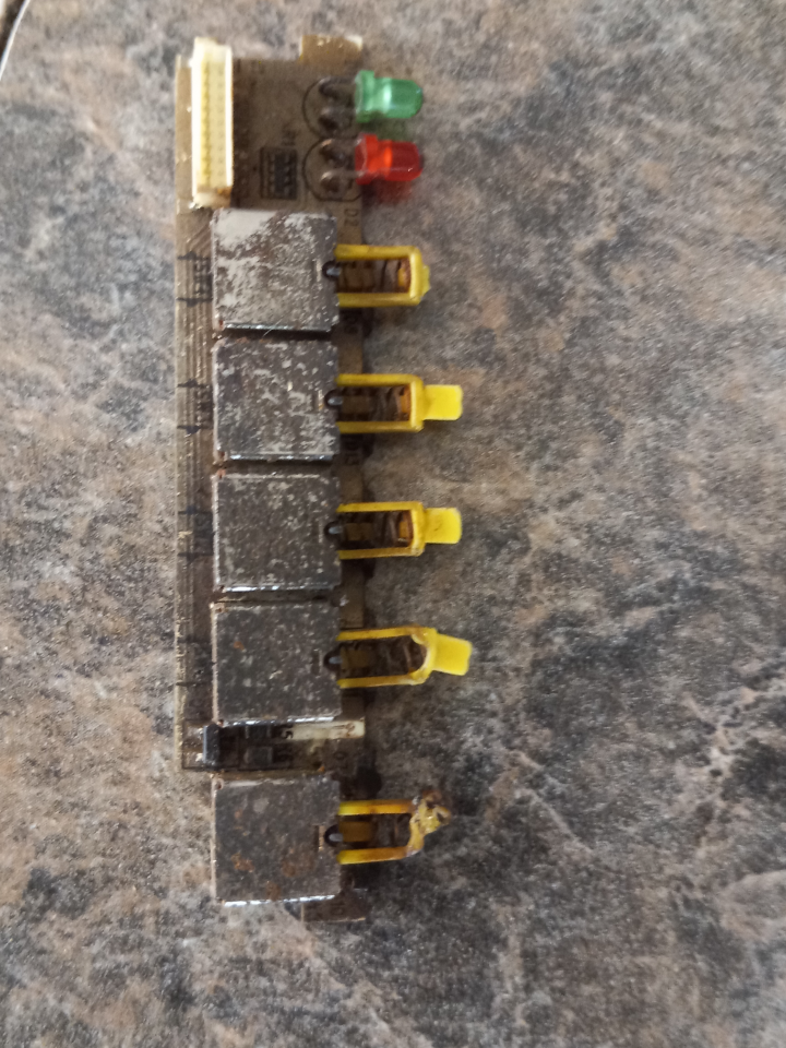

greatcornholio Posted January 26, 2023 Report Share Posted January 26, 2023 i almost lost everything in a house fire the fire happened two years ago and at that time i slimmed down my xboxs and only had two of them one just a softmod the other the xecuter 3 now let me tell you these xboxs were directly under my 55in flat screen tv and the tv melted all down on the xboxs now im here to tell you that Microsoft built a tank when they built these things because softmod survived i mean the case is junk both power and eject buttons were melted together i had to break the case apart and pull the power/eject pcb board out to turn it on now i have not cleaned the mother board or anything and it functions so i have hope i have not hooked up x3 to see whats up its the holy grail instead i have it pulled apart and trying to clean the mother board and mod chip and try to get it up and going again the switches are really bad one of the switches got so hot that some of the buttons fell off one switch came apart a spring came out but the switch might still work if you act like there is a spring there it will cycle but they are all melted in some way ie the switches now about the lcd screen i have it all pulled apart i might be able to salvage it it had some sort of tint on the out side of the glass witch is easy i just have to find out about what % tint it was but on the other side of the glass screen for illumination there is a white semi transparent film for even and soft illumination and now mine is is wavy like a pice of bacon and that will effect the screens back light illumination so if i can figure out the tint % and a good replacement for the backlight diffuser i think its what it is lol and to replace these switches https://imgbox.com/g/Pl9bJWtgsZ 1 1 Quote Link to comment Share on other sites More sharing options...

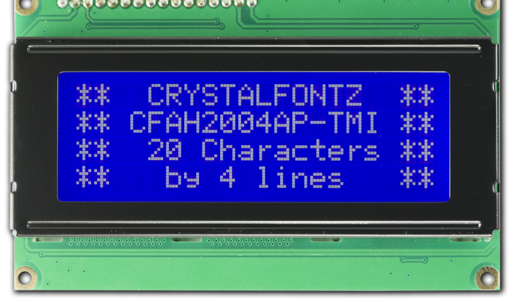

SS_Dave Posted January 28, 2023 Report Share Posted January 28, 2023 I used a LCD like this to fix a damaged X3lcd by swapping the PCB from the old X3 one to the new assembly. https://www.crystalfontz.com/product/cfah2004aptmiew-20x4-spi-character-lcd Cheers SS Dave Soft modding is like masturbating, It gets the job done but it's nothing like the real thing. Quote Link to comment Share on other sites More sharing options...

greatcornholio Posted February 4, 2023 Author Report Share Posted February 4, 2023 thank you for the advice of witch i did use distilled water and dawn dish soap did the trick and plan on getting one of those lcd screens but for now its running on one of the bios banks not sure witch one or how im going repair the switch bank as i stated i bought this thing and wish i did the install of the x3 ce becase they super glued the wires going to switches to the face plate and im sure ive broken a couple of wires trying to get it lol but it runs Quote Link to comment Share on other sites More sharing options...

Element18592 Posted February 8, 2023 Report Share Posted February 8, 2023 I'm sorry to hear about your housefire man. Hopefully I can help you out a bit. I recently cloned all the XC3P boards complete with full BOMs for each board aside from the XLCD. For replacement parts or if you just want to make new boards from scratch you can checkout the github repo here: https://github.com/Element18592/Xecuter-X3CP-Boards As for the white diffuser you can rob that and the LCD itself from another HD44780 LCD to rebuild your XLCD. 2 Quote Link to comment Share on other sites More sharing options...
