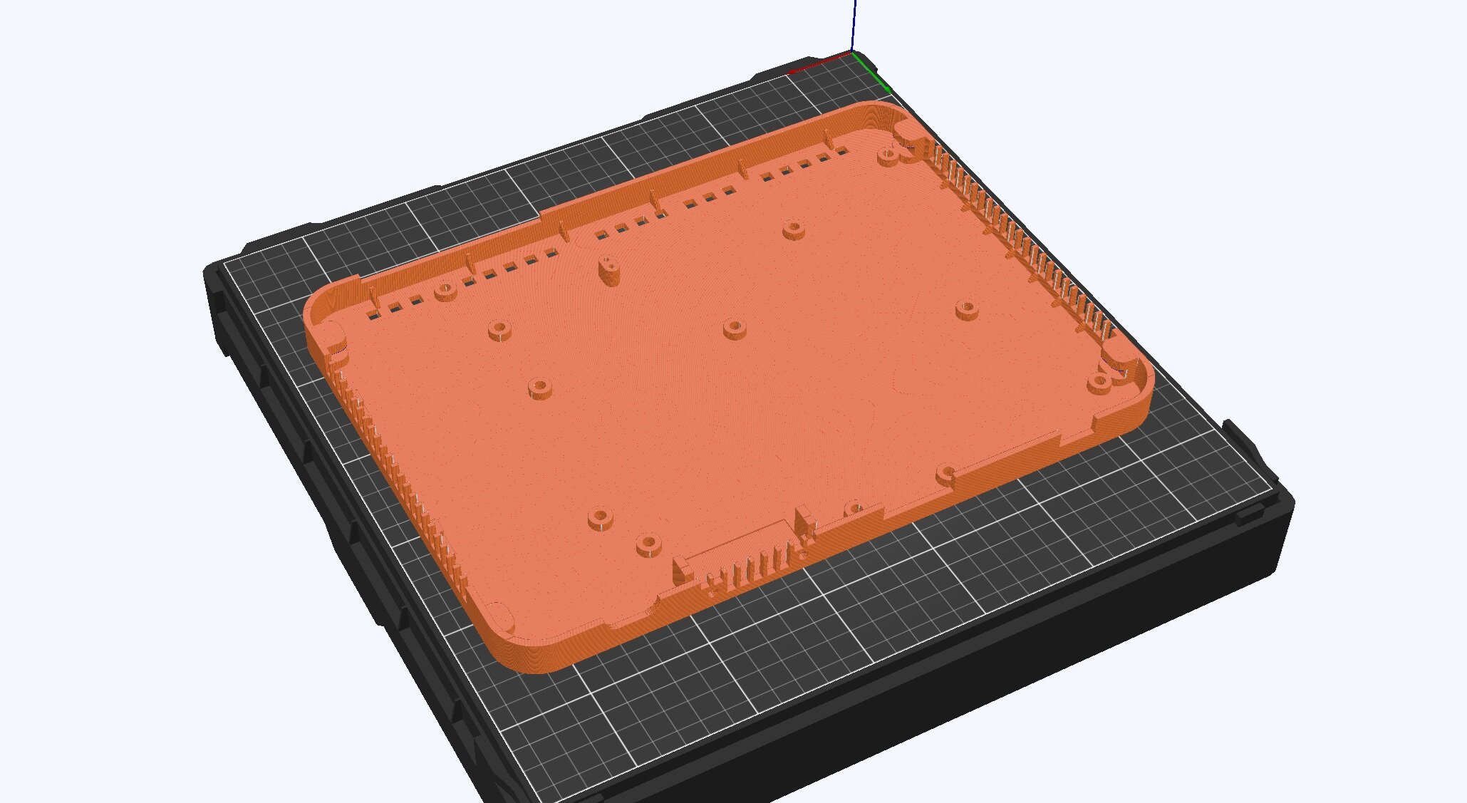

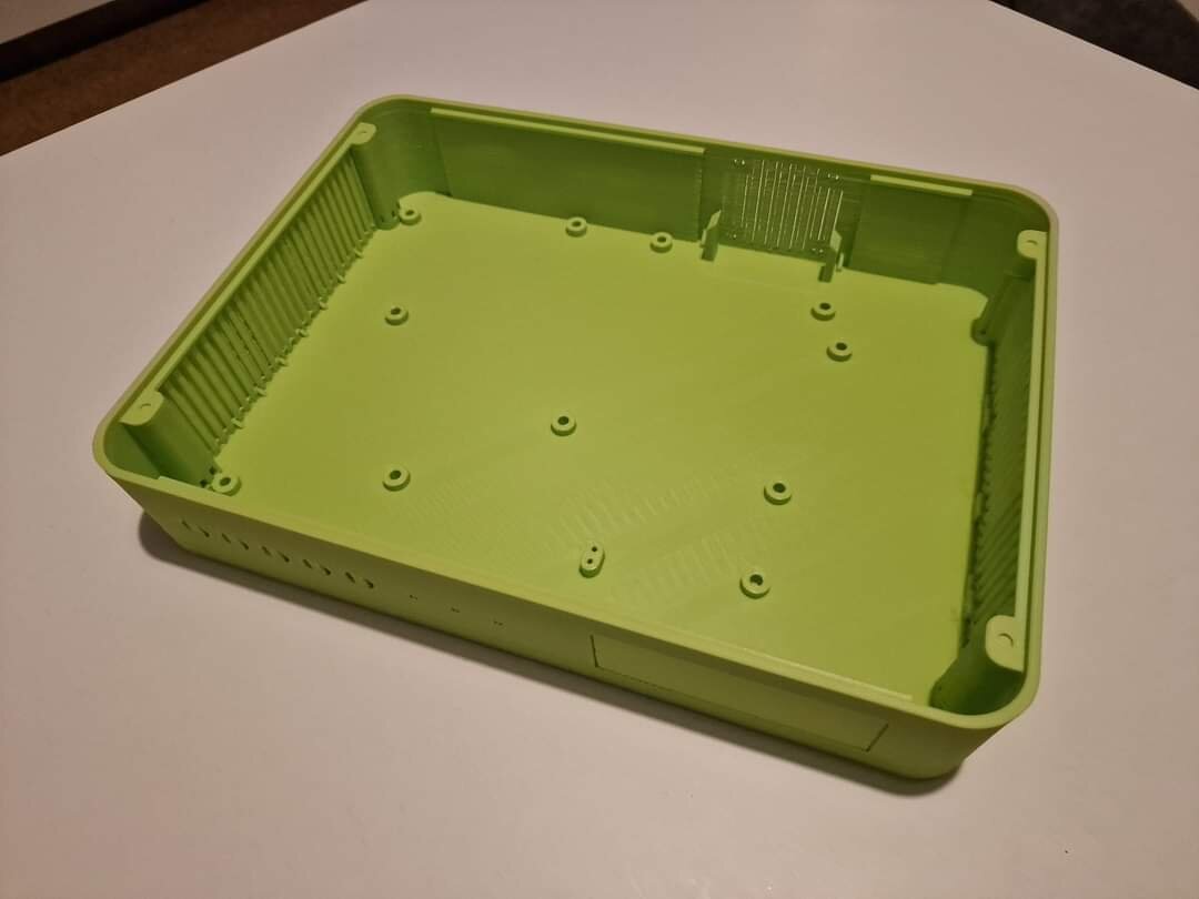

ShinGoutetsu Posted December 2, 2023 Author Report Share Posted December 2, 2023 made some adjustments, this is an alignment print which will take 11 hours. The case will now use threaded inserts for mounting the xbox board and psu. I've added ribs to strengthen the case. 4 1 Quote Link to comment Share on other sites More sharing options...

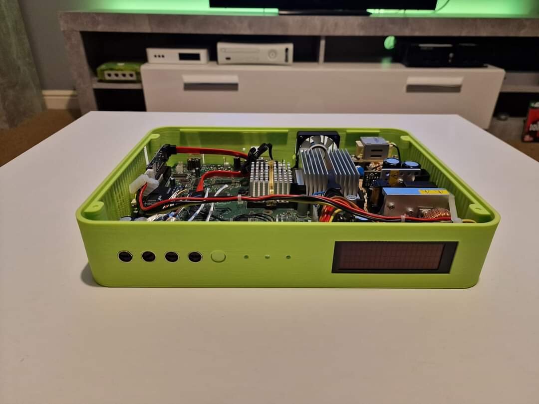

ShinGoutetsu Posted December 2, 2023 Author Report Share Posted December 2, 2023 16 minutes ago, big F said: Shame you can’t Heart this more than once. Haha thanks. Here's some pics of the case with inserts and magnets that hold the lid in place instead of screws. 1 Quote Link to comment Share on other sites More sharing options...
Bowlsnapper Posted December 2, 2023 Report Share Posted December 2, 2023 5 hours ago, ShinGoutetsu said: Haha thanks. Here's some pics of the case with inserts and magnets that hold the lid in place instead of screws. I REALLY want to build this and the more skills and tools I gain the more I like to build things myself instead of just buying them. However, I don't think my 3d printer is big enough and I just didn't want to spend the money on a printer with a big enough bed to print this. Are you able to print one in it's current form, or is it not finished yet? Quote Link to comment Share on other sites More sharing options...
ShinGoutetsu Posted December 2, 2023 Author Report Share Posted December 2, 2023 4 minutes ago, Bowlsnapper said: I REALLY want to build this and the more skills and tools I gain the more I like to build things myself instead of just buying them. However, I don't think my 3d printer is big enough and I just didn't want to spend the money on a printer with a big enough bed to print this. Are you able to print one in it's current form, or is it not finished yet? The first print is in progress. It's for an alignment check though. The full case will be printed after I'm happy that everything lines up. Them the case files will be released. 1 1 Quote Link to comment Share on other sites More sharing options...

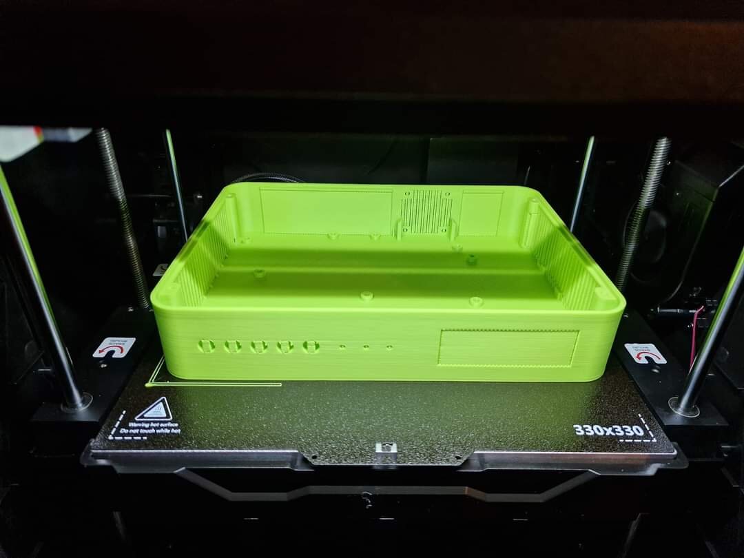

ShinGoutetsu Posted January 9, 2024 Author Report Share Posted January 9, 2024 Actual print on my Qidi XMax 3, took 10.5 hours (still removing the supports at the moment). 1 Quote Link to comment Share on other sites More sharing options...

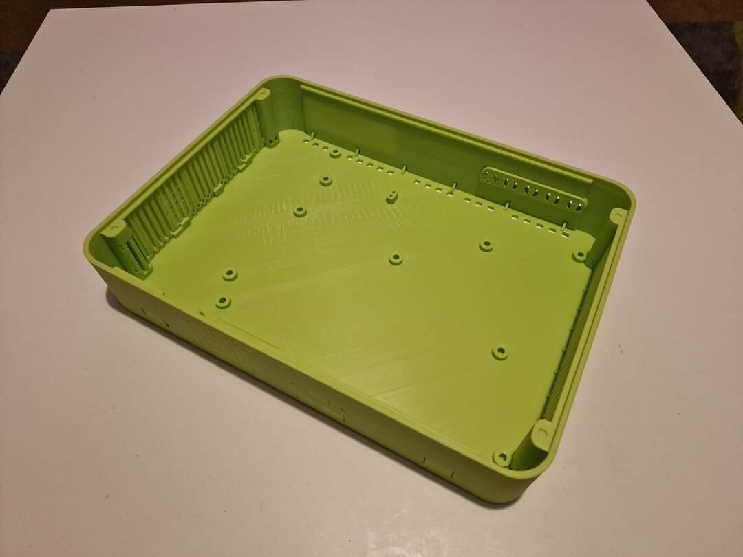

ShinGoutetsu Posted January 15, 2024 Author Report Share Posted January 15, 2024 Well everything fits so far 1 4 Quote Link to comment Share on other sites More sharing options...

ShinGoutetsu Posted February 12, 2024 Author Report Share Posted February 12, 2024 Slim Case parts list: 1. 4 x controller port cables https://www.ebay.co.uk/itm/202267811844 2. 8 x 4mm x 1mm magnets https://www.ebay.co.uk/itm/204195070562?var=504873089626 3. 3mm led x 2 (for HDD and LAN activity led's) 4. 3mm bi colour common cathode x 1 (for power/eject led) 5. 50mm 12v fan https://www.amazon.co.uk/Gelid-Silent-Hydro-Dynamic-Bearing/dp/B008S1DN66/ref=sr_1_17?crid=3ETPMTKXY2BFF&keywords=50mm%2Bx%2B50mm%2Bx%2B20mm%2Bfan%2B12v&qid=1707643302&sprefix=50mm%2Bx%2B50mm%2Bx%2B20mm%2Bfan%2B12v%2Caps%2C82&sr=8-17&th=1 6. IDE to SATA adapter https://www.startech.com/en-gb/hdd/ide2sat25 7. Short SATA cable https://www.ebay.co.uk/itm/322901628155 8. USB panel mount cable https://www.ebay.co.uk/itm/232202769908 9. 10mm Round Momentary Push Button (for power switch) https://www.ebay.co.uk/itm/124500698456 10. (Optional) Newhaven OLED display https://www.digikey.co.uk/en/products/detail/newhaven-display-intl/NHD-0420CW-AB3/5022951 11. (optional) OLED compatible OpenXenium Modchip 12. 2.5" HDD/SSD sata storage device 13. Brass M3 x 6mm heat set inserts https://www.amazon.co.uk/Printing-Knurled-Threaded-Embedment-Injection/dp/B0C1RRBGC7/ref=sr_1_29?crid=2Z28ESWASWL71&keywords=brass+inserts+m3&qid=1707733782&sprefix=brass+inserts%2Caps%2C88&sr=8-29 Quote Link to comment Share on other sites More sharing options...

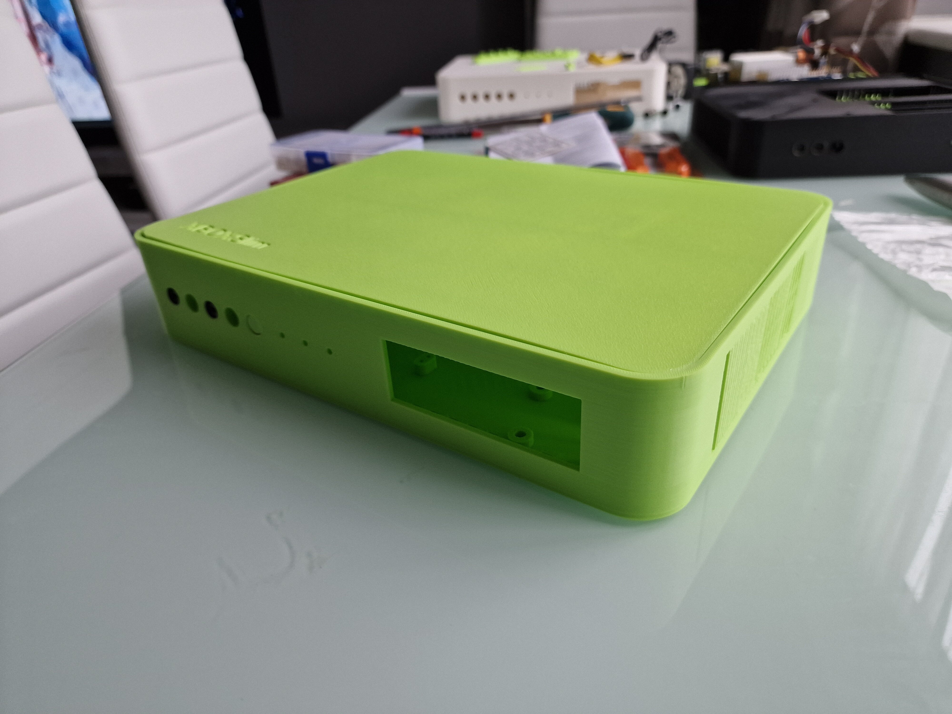

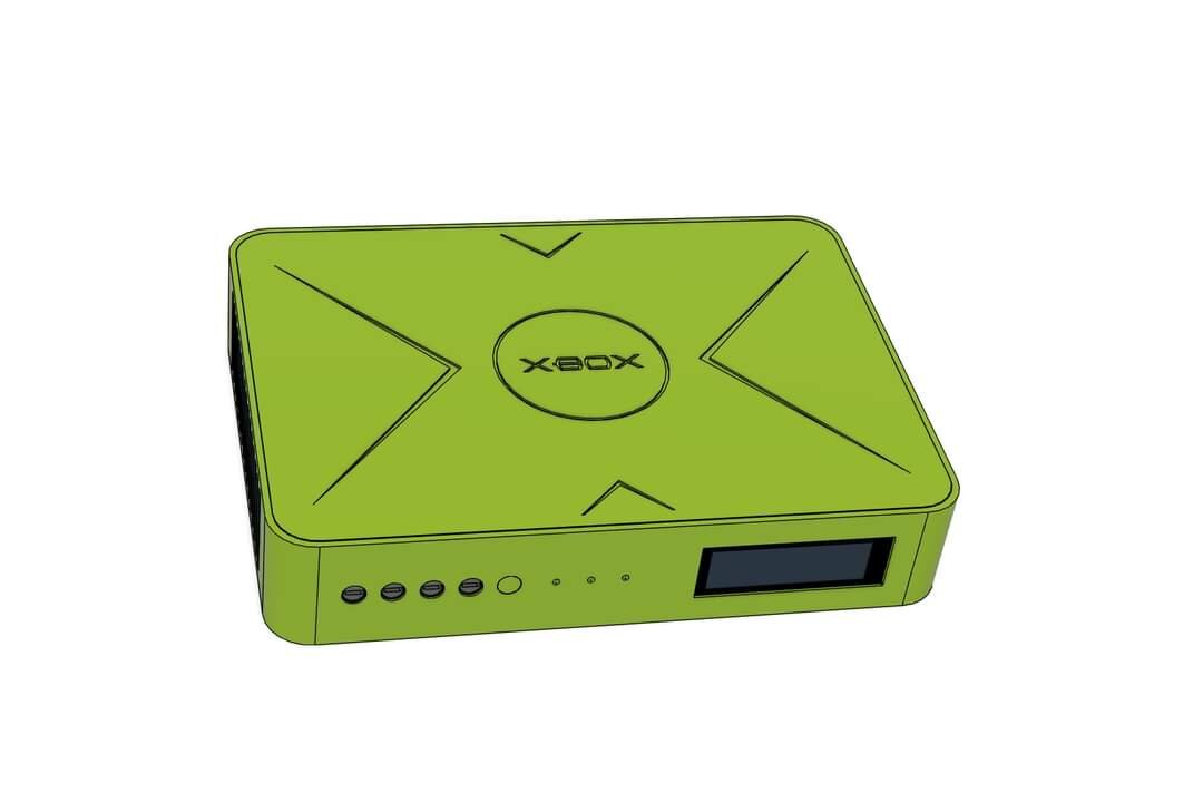

ShinGoutetsu Posted March 18, 2024 Author Report Share Posted March 18, 2024 I've made a new top part that adds back the original xbox identity, will upload it here soon 5 Quote Link to comment Share on other sites More sharing options...
Bowlsnapper Posted March 18, 2024 Report Share Posted March 18, 2024 1 minute ago, ShinGoutetsu said: I've made a new top part that adds back the original xbox identity, will upload it here soon NICE WORK! Is there any way, we could have a version that leaves the spot open completely so we can put an original jewel on? I'd be interested in seeing how that would look. 1 Quote Link to comment Share on other sites More sharing options...
ShinGoutetsu Posted March 20, 2024 Author Report Share Posted March 20, 2024 On 3/18/2024 at 8:11 PM, Bowlsnapper said: NICE WORK! Is there any way, we could have a version that leaves the spot open completely so we can put an original jewel on? I'd be interested in seeing how that would look. Will do at the weekend 1 Quote Link to comment Share on other sites More sharing options...
