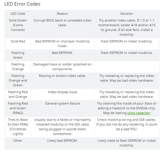

I can't anymore since the console shows a black screen and the led stays solid red.
See if it will boot the Extras Disc before the black screen and solid RED LED appear. Load the Extras Disc into the DVD tray then power cycle the console.
Does the stock startup animation play when you turn on the console?
If the animation plays, iIs there an Evox shield in the upper left-hand corner?
And, what word is printed below the big X logo at the end (Microsoft, XECUTER2, etc.)?
