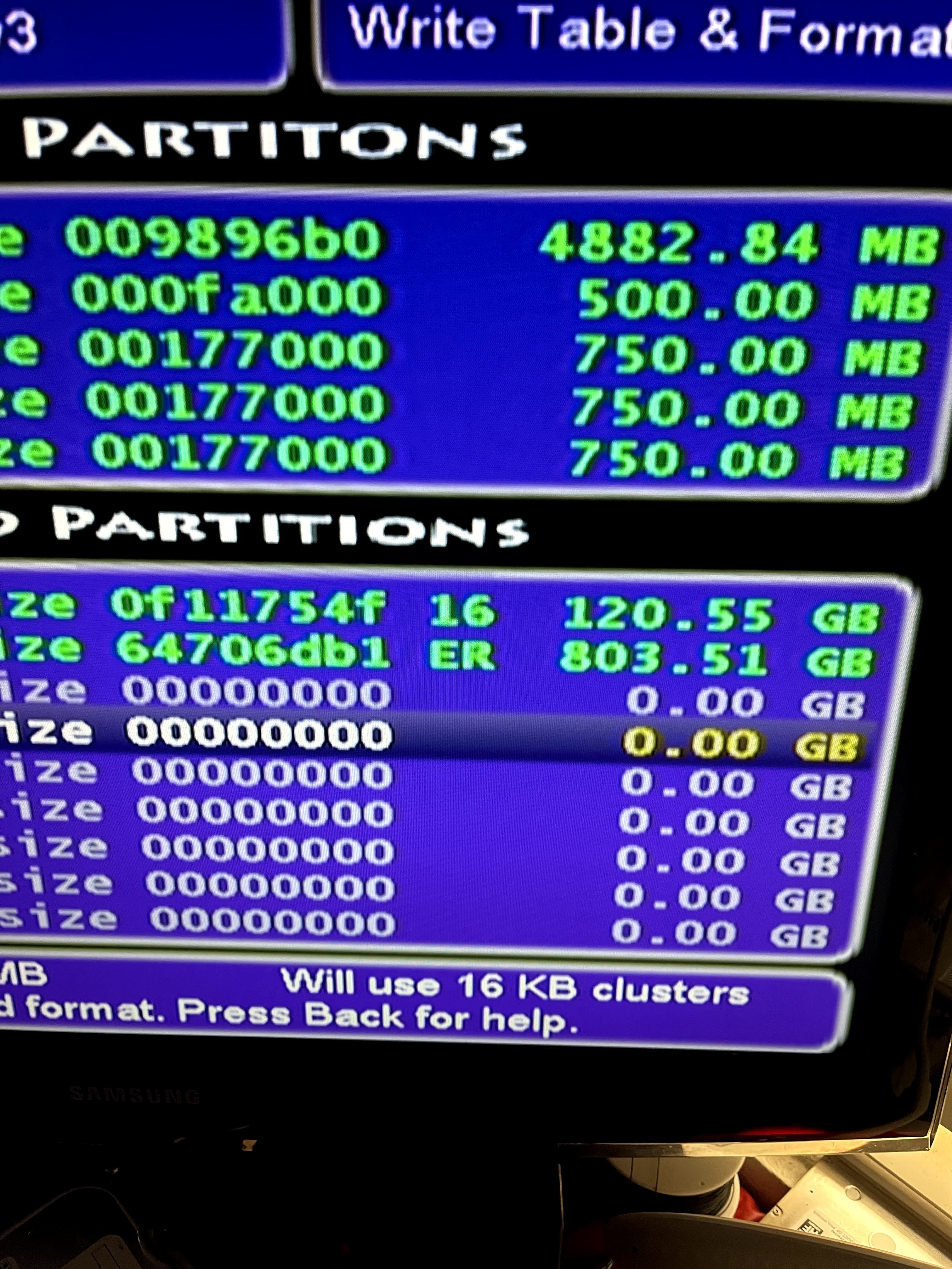

Hello , Ive been transfer my games over to a WD green 2tb HDD through FTP .. Everything goes good until I get to a point an games transfers start to error out.. I noticed in the Game Folders weird off symbols that are not in the folders.. Photo of HDD.. Would you say the HDD is Corrupted? I also thought I seen a WD green fix for OG Xbox but cant seem to locate it.. Thanks for any help
Was the hard drive formatted with Xbpartitioner 1.3 twice?
You need to format large drives with Xbpartitioner and the 1st format set the drive size (partition 6 and 7) 1 or 2 gig  smaller from the maximum size then power cycle the Xbox, Now format again at maximum size.

Highlight either partition then press B it will make both drive equal then press Start to format the partitions 6 and 7.
When it's finished power cycle the Xbox and check again it should not have the ER any more
ok that worked.. showed 64 now.. reinstalling some games and Roms again.. will update.. thanks guys

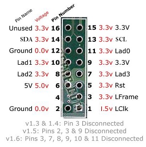

Well now it powers on and off Twice then stays on flashing red/green - Fixed looked like the Pinheader solder on the button was hitting metal (weird) - NVM it's back. .. Also noticed Mod chip wasn't Lighting up.. but was working  hmm
The Led on the mod chip gets it's power from the 5 volt supply so you may have a bad solder joint on pin 6.

The Mod chip was working but wasn't showing power. Maybe i can wire power from another Point?
19 hours ago, SS_Dave said:
The solder joints on the LPC could use a bit of a rework with some flux paste.
What mod chip is it?
I have aladdin XT and a Open xenium.. Since it seemed like the Chip wasnt getting Power I ran a Wire from the 5v on Power Supply Connecter to the v5 point from your Image and now it boots..
