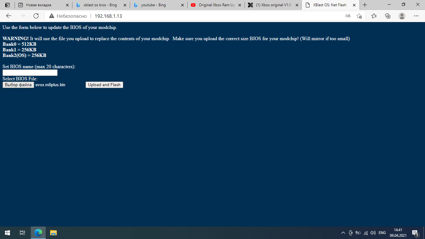

Hi!
I have Xbox original v1.0. component cable
I made Tsop and it work greate.
I hope to make ram upgreade, but first i write XBlast OS on my bios. after rebut I donot see start console.
XBlast OS in ThuHexen 2021 256kb
Maybe it work only with composite cable?
can i flash the bios with programmer ? it is posible ?
