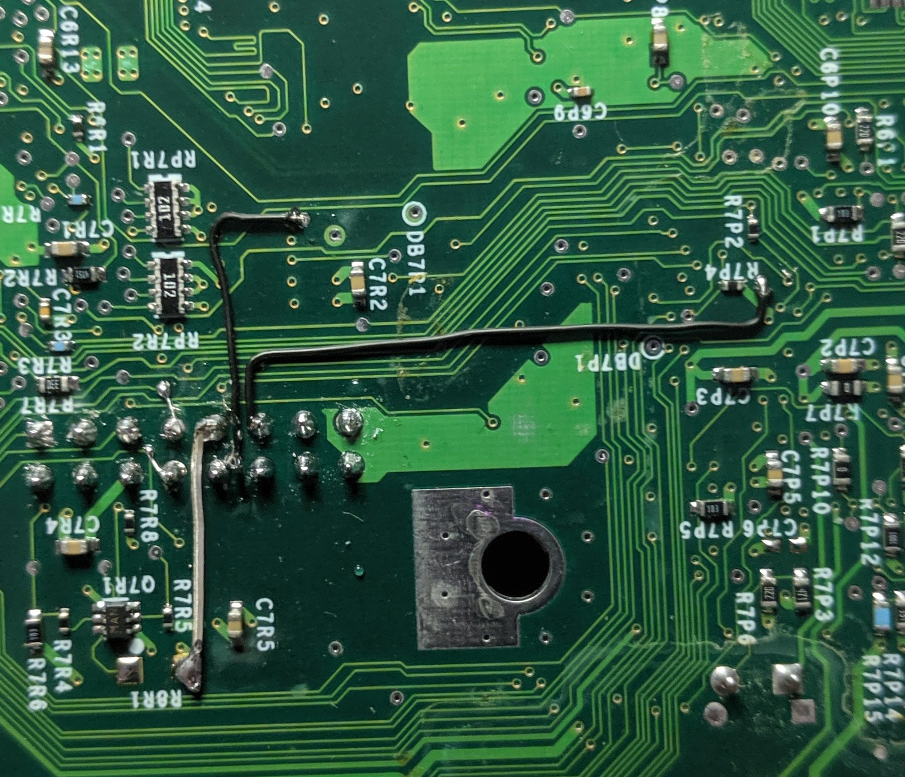

This is the 2nd rebuild I did around 15 years ago
And I cut the Lframe trace to make the Xbox load from the Modchip.
You don't need to worry about the D0 wire on the modchip and on a Aladdin modchip link the BT to pin 2 as this makes the chip always on.
