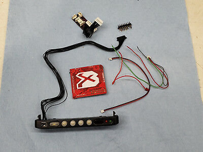

X3 install  with the push button panel on the front. It will not boot to MS Dash if I push and hold the power button. It quickly flashes red then switches to blue and boots to UnleashX. If I load the X3 menu (hold white button on startup) and select "Reboot With X3 Mod Disabled" it works perfectly - boots to MS Dash. I can also reach the MS Dash by selecting it from the UnleashX menu. Why won't the power button bypass function correctly?

The Pro Switch package comes with a power switch bypass board, as seen in the attached image. This console did not have that important piece installed. I opened one of my other X3's and was doing some comparison. I pulled the little board and tried it in the other console to prove-out the problem/fix. That resolved it.
